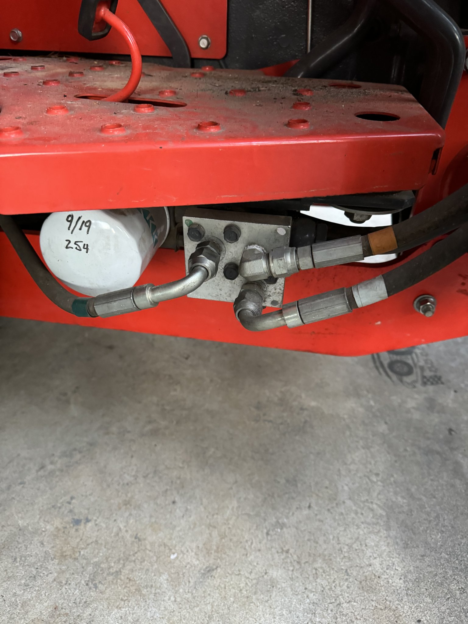

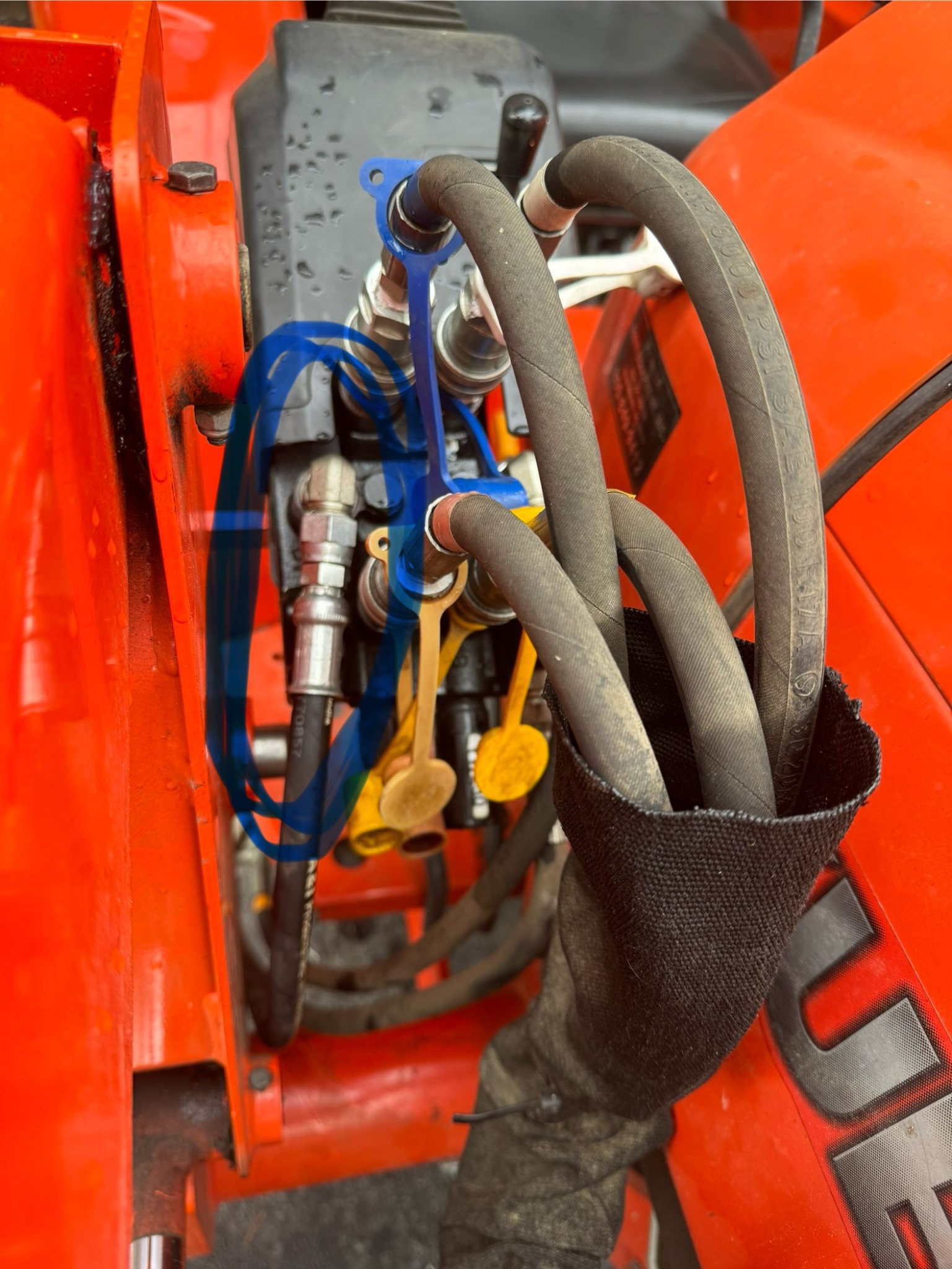

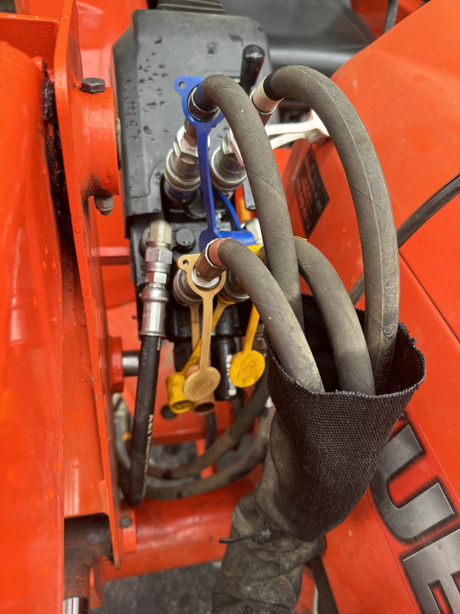

I assume you also have a koader on that tractor? Post pictures of where your two backhoe hoses are connected to the tractor's hydraulic system.
Steven.Echuck
L3800 / BH77
May 15, 2024
10
Guyton GA

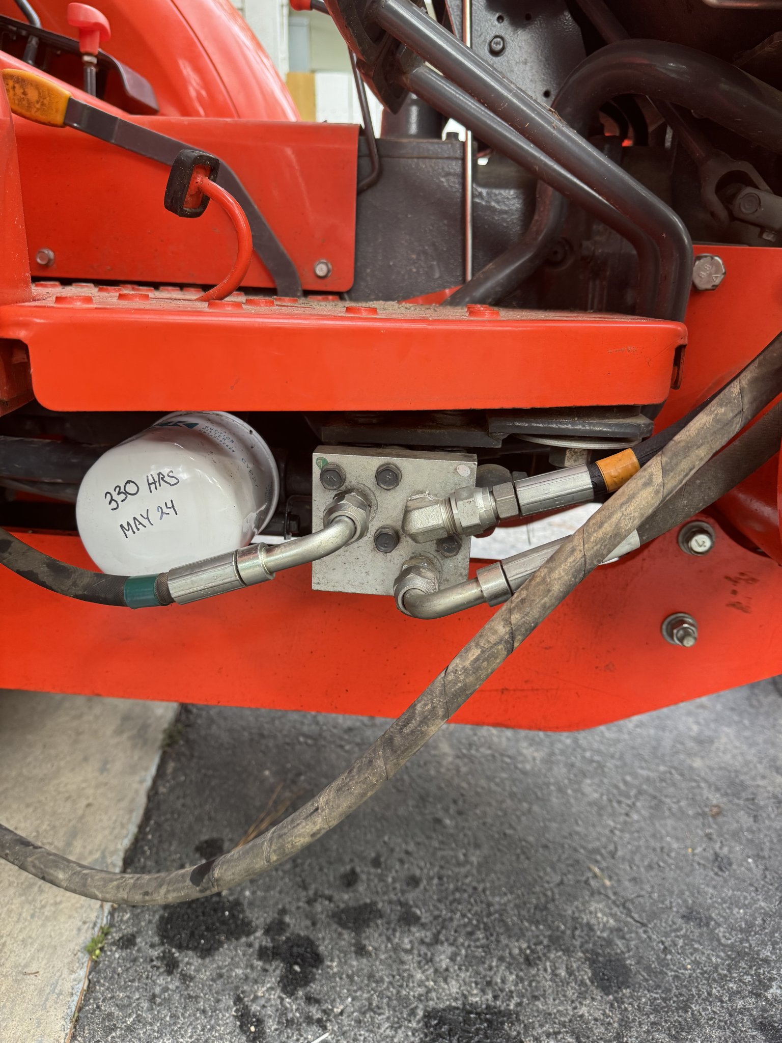

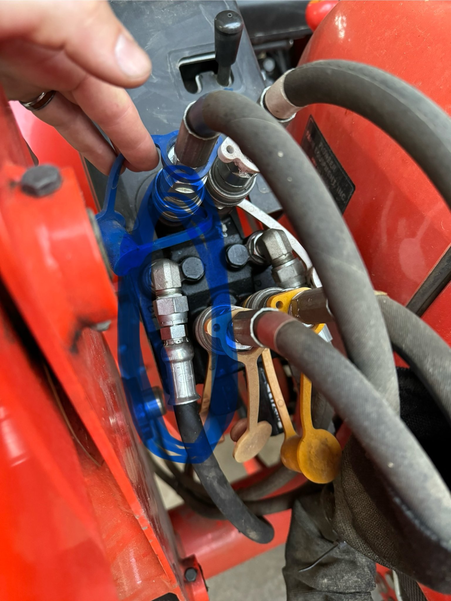

Does the loader and 3pt work with the hoses looped together as shown in your picture?
Yes when the hoses are looped everything works as it should for the front loader. When I hook it up to the BH77 and try the front loader everything works as it should as well. Fluid is going into the backhoe and back out as it should. Whenever I try any controls on the BH77 the cylinders try to move but they’re locked in position. They won’t even move when the tractor is off and there’s no pressure. I can’t figure out how to get it unstuck. It’s like all the cylinders are frozen or something’s wrong with the control valve.
9,700
5,120
You seem to have the tractor side hooked up correctly so the hoe should work when connected. I am thinking you may have the hoe hooked up backwards.
Looking at the couplets on the rear which hose goes to the loader valve and where is it connected to the backhoe valve?

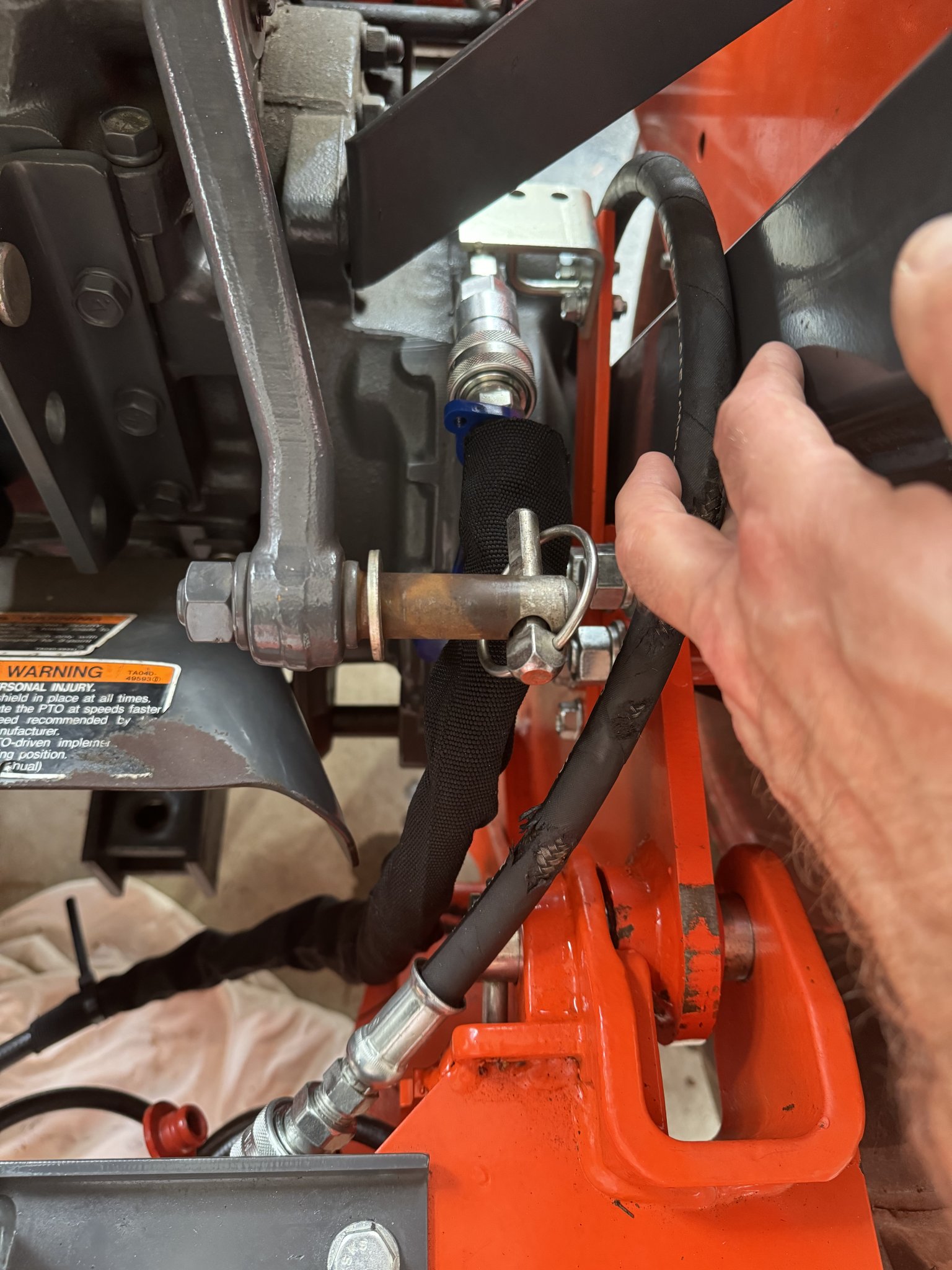

This may seem redundant but humor me. You have a male and female coupler on the back of the tractor.
The male coupler is connected to a hose thst goes where?
The female coupler is connected to a pipe that goes where?
When the hose is looped to the pipe does the 3pt work correctly?

I know….I feel like it’s a simple problem but I can’t seem to figure it out.
Male coupler from tractor comes from front end loader hydraulic block and is plugged into female receiver on bh77. Female receiver on tractor comes from lower hydraulic block on right side of tractor below brakes and is plugged into male end on bh77. When everything is connected all cylinders on bh77 will not move and they act like there’s pressure there but something is stopping the flow “dead head”. The font end loader works perfectly when the bh77 is hooked up. No issues at all. When the bh77 is disconnected and looped into itself the front end loader works perfectly……

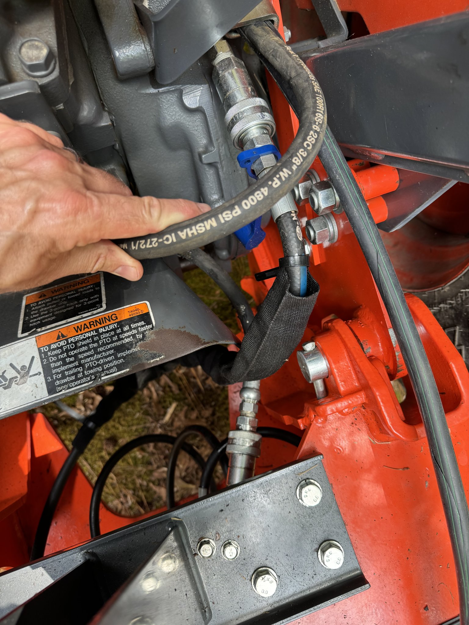

Photos for reference.
9,700
5,120
Sorry for the problem, it’s driving me nuts.
OK. sounds like the tractor side is correct sndcworking asvit should.
So here is my analysis:
If the loader works when the hoe is hooked up the power beyond loop through the valve center is not deadheaded.
If operating the backhoe valve deadheads the PB supply to the BH something is wrong at the backhoe valve. My suspicion is you have the supply and return ports reversed at the backhoe valve and you are backfeeding the valve via the tank port.
Trace both of the backhoe hoses back to the valve and make sure theyvare connected to the correct ports on the valve. DO NOT GUESS.!!! Verify the connections match the instructions and post pictures of the connections with the ports labeled. iN and OUT so we can confirm.

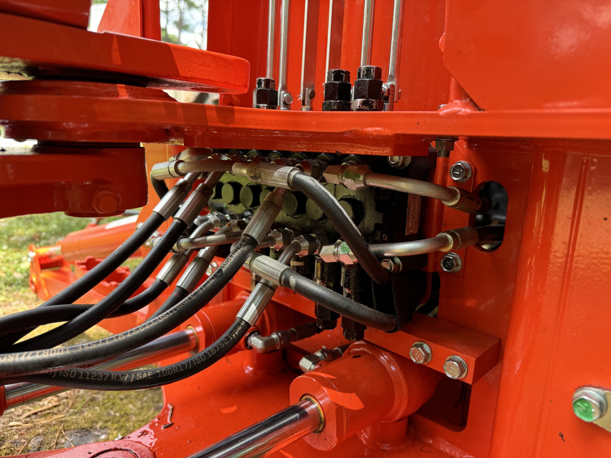

See pic below. Spent all evening tracing hoses and double checking everything on the control valve.
The “IN” line in the picture goes to the female bh77 connector which in turn runs to the power beyond connection on the FEL block (left side hose hook up)
The “OUT” line in the picture has a male connector, goes into the female receiver on the tractor. That runs down to the hydraulic block below the brake pedals. It’s connected to the farthest left port (see pics)
9,700
5,120
You have still not verified the hose connections at the backhoe valve..
Here is a picture of the backhoe valve lifted from the BH77 WSM. Plufg your backhoe couplers in and then start at the ports on the backhoe valve and follow each hose individually all the way back to the end points on the tractor.
Verify the loader valve is connected to the P port - e.g. lower port on the backhoe valve.
Verify the hydraulic block is connected to the T port - e.g. upper port on the backhoe valve.

He says the loader is working fine so the neutral circuit is open to tank. Dollars to donuts he has T and P reversed on the backhoe valve.
Steven.Echuck
L3800 / BH77
May 15, 2024
10
Guyton GA
Alright here it is……I can finally get some sleep again.
TheOldHokie was right again…. I swapped my hoses and everything stared working as it should. I still don’t understand why it’s functioning properly because it is plumbed opposite of how I read the manual but oh well. I’m moving on to actually get some work done now.
Just want to state again, took my tractor and bh77 to the dealership and had 3 mechanics craw all over it for 2 hrs and they couldn’t figure it out. Even compared it to the brand new bh77 on the lot and everything “matched up”.
I want to extend a sincere thanks to all that follow these forums and help everyone out. It’s been really helpful to get quality advice from people that know what they’re talking about.
Once again, OldHokie I hope to buy you some lunch one day for the help. You deserve much more than that for your wisdom. I’m in your debt for sure. Thanks again.
