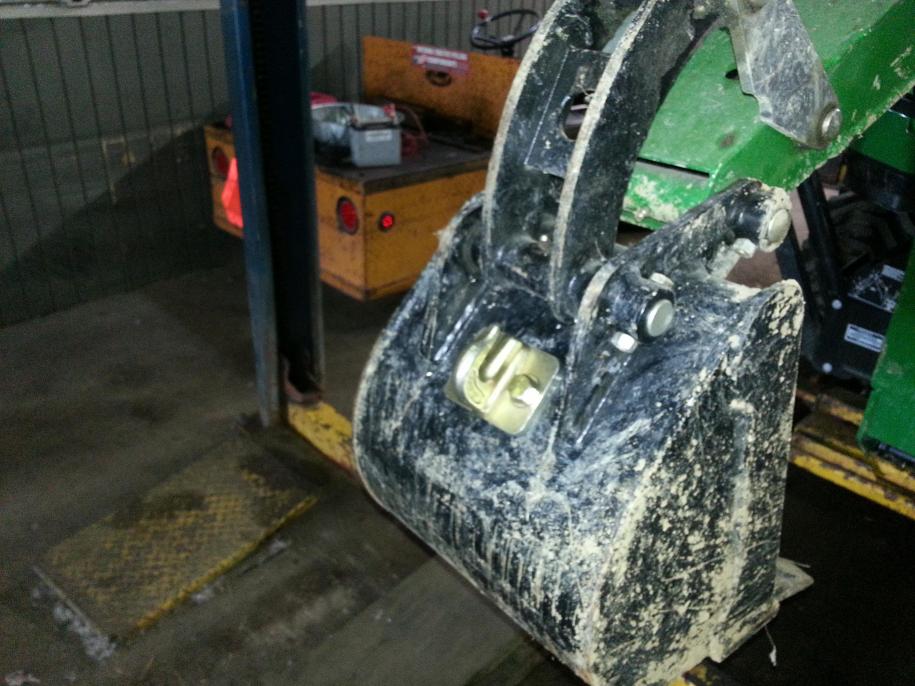

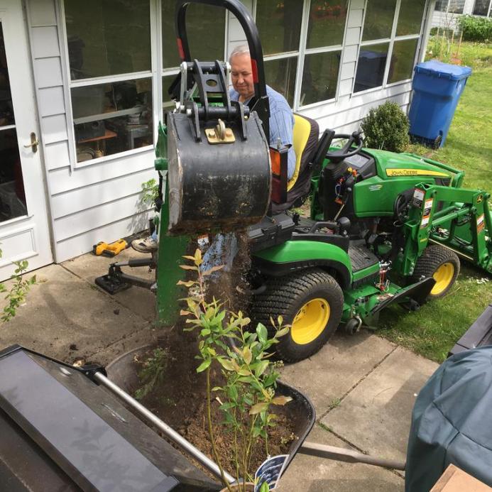

I have a few pictures of the Bolt-On hooks on some small JD buckets
Gosh Jake - you got the attention of Ken himself! :D
Ken - they fit on those little JD buckets real nice! Looks like a nice spot.
