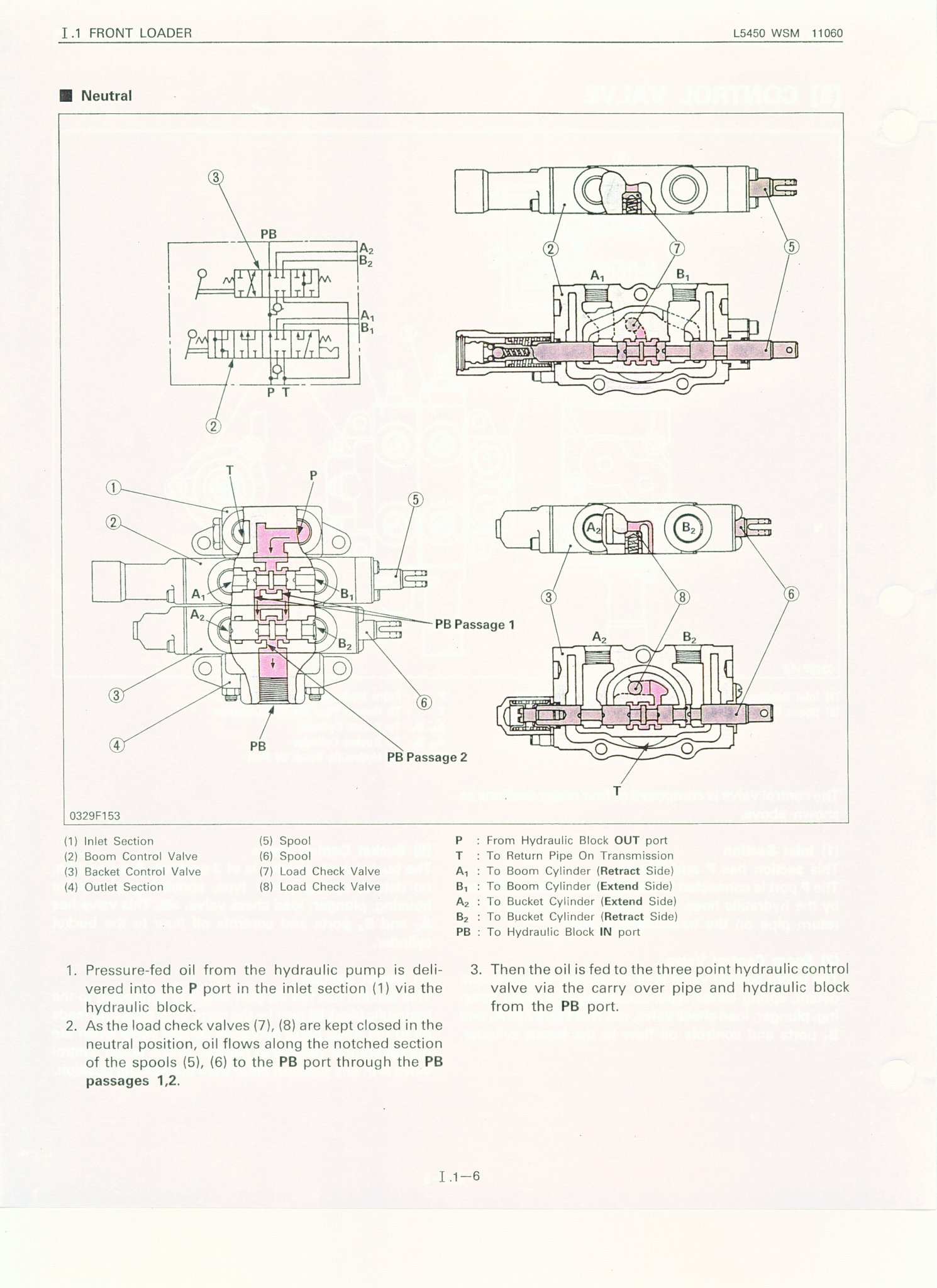

I think the check valve function is built into the spool (its load checks) - valve doesn't have a regenerative spool, if I'm reading the diagram right.

I'd suggest interchanging the 2 curl hoses at the loader boom couplings or at the control valve. With hoses swapped it should work as intended.
The upper left diagram in the above attachment shows only one hose is open to the tank on reverse flow - connected the right way the cylinder can move, even with pressure to both sides.

On my phone but I dont see anything connected to tank. Per description exhaust oil flow is going to PB and from there to 3pt.
Edit; got the bigger image.
In the schematic it looks like one of the valves may have a regen position. Post the WSM page showing curl operation.
Your diagram does show regen. When the bucket valve is in the right position, the A2 and B2 ports are both connected to the P port and the T port is blocked. This gives fast extension of the bucket cylinder.
That also means that if he had the lines reversed at the valve he would not have curl and the cylinder would extend when the spool is shifted either direction. Thats not how he described the problem but.....
