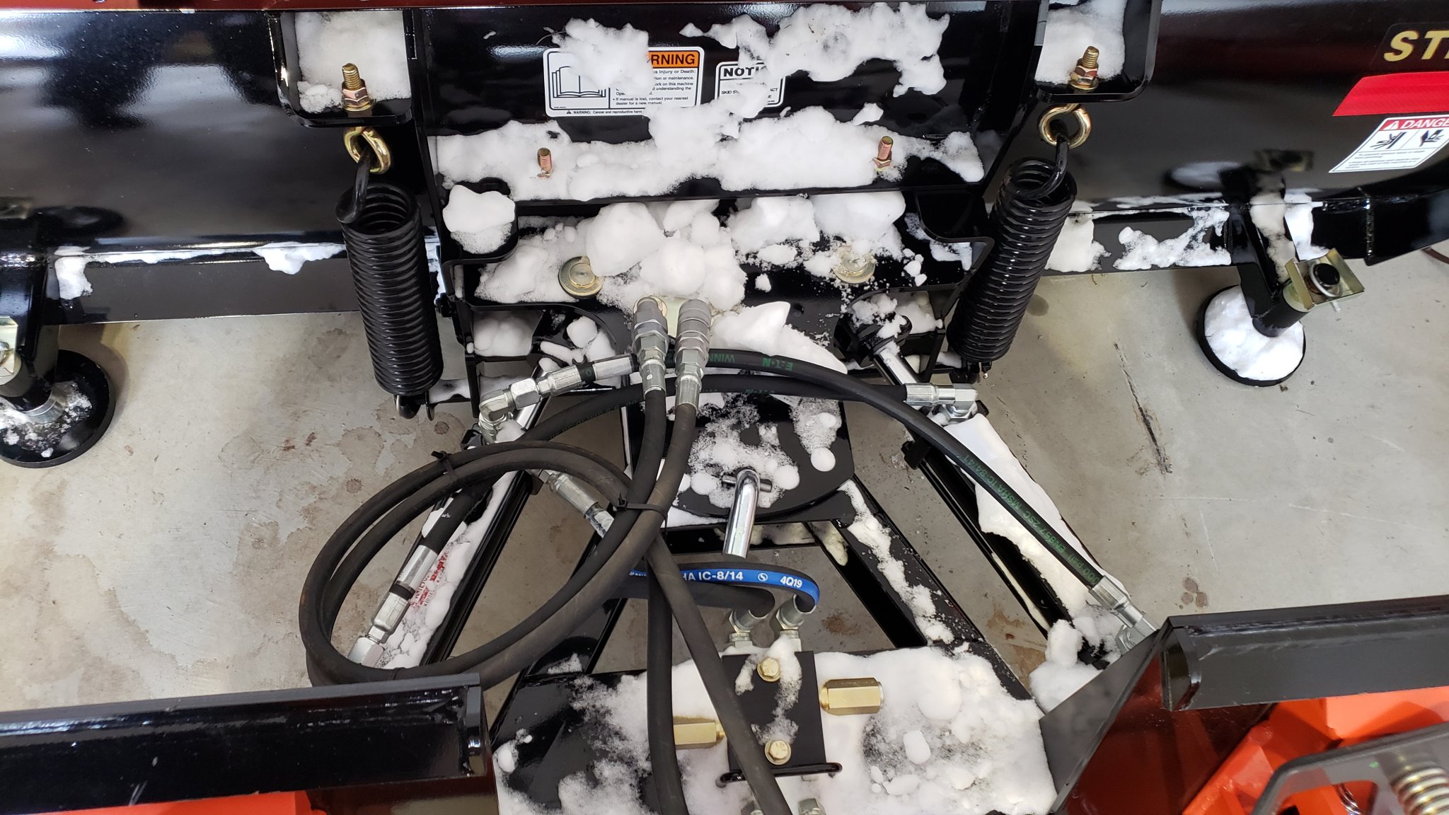

Yeah once you cut them off I'd either use C clamps or tack it until you find what works best. Here is a picture of my Land Pride blade if it is helpful. Sorry for the snow as its been busy lately.

Your plow looks nice, what's that attached too?
Thank you. Its attached to an LX2610 that I got earlier this month. Still working on finishing the 3rd function install which is why the hoses are coiled up and the pin is still in. I was very happy with it clearing the two feet of snow that we got on Thursday.
