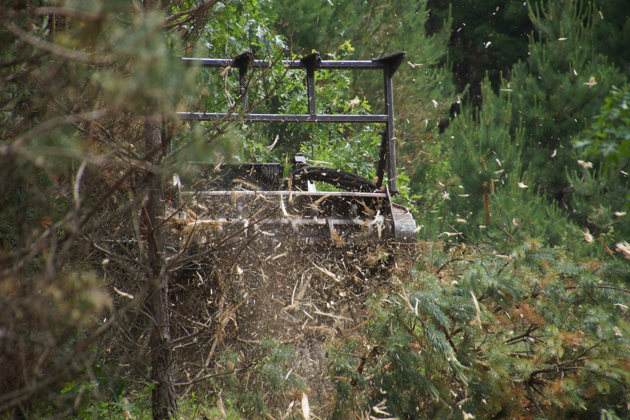

I had very dense Scot pines in the 3 to 6 inch range on my 56 acres when purchased. I converted 28 of them to open oak/savanna prairie. The initial removal of the Scots was handled by a contractor that has a tracked skid steer and Fecon forestry mulching head. What is nice about forestry mulching is that the trunks can be brought right down to soil level. Even so with his machine he spent 6, seven hour work days mulching @ $175 per hour.
A year after the land we were able to no-till plant even with the remaining mulch. I think it would be tough to rototill however until what is remaining of the underground stumps and roots break down. Which for pine is pretty quick.
I purchased a L2501 with grapple and have a box blade and other implements . I now can remove scot pines, roots and all, in the area that was mulched but it is slow going.
Just my observations but you may want to consider forestry mulching initially and following up with a tractor brush cutter/box blade to maintain.
