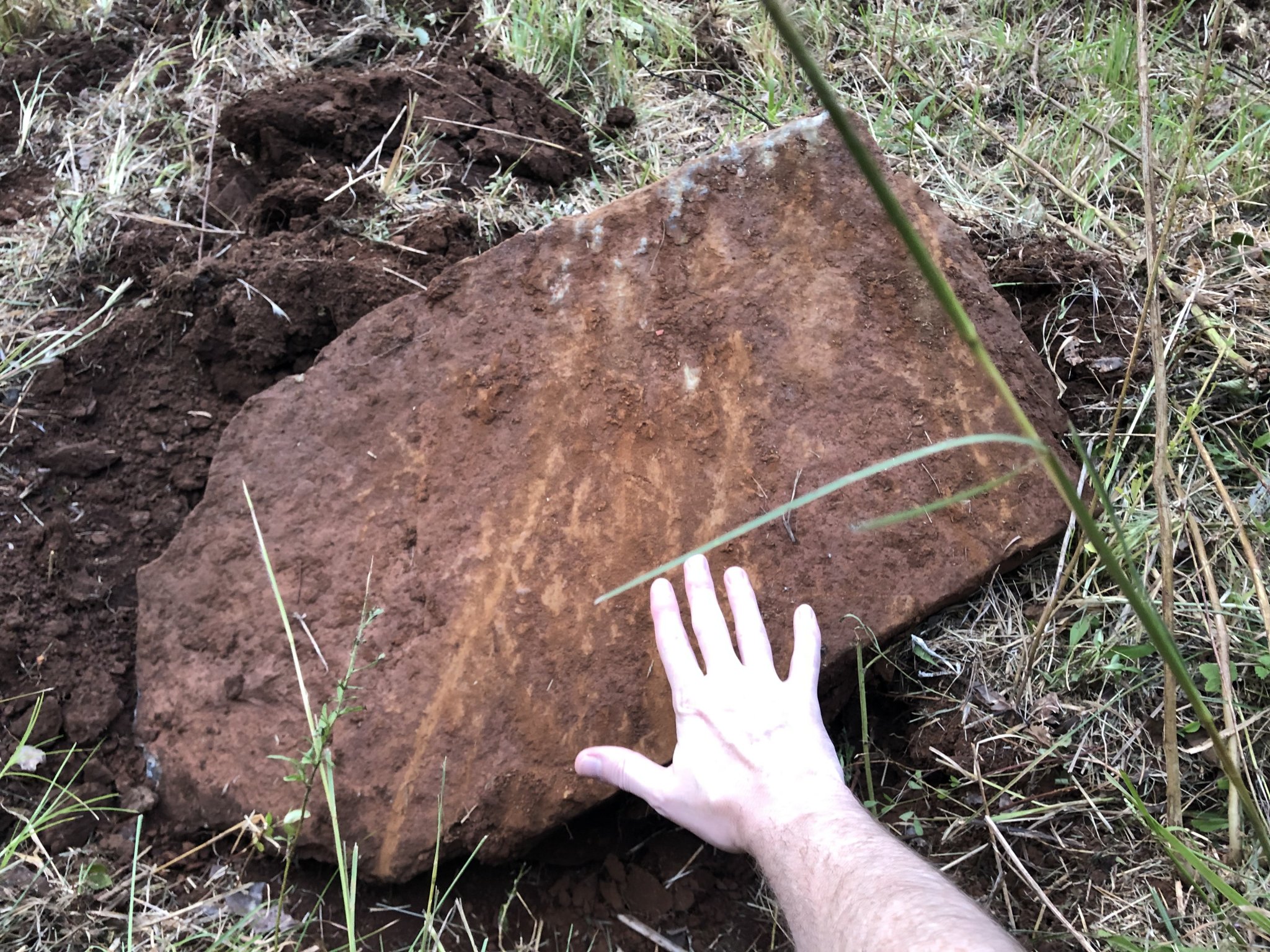

I have a 1/2 acre that has not been planted in about 100 years. I had the trees cleared/uprooted. The area used to be wooded. I live about a mile from a rock quarry. Therefore, I have plenty of roots and rocks to clear. The roots are easily broken with the box scrapper. Most rocks I can turn up as well. Rocks vary between the size of a golf ball to a Honda Civic tire. I only broke two teeth off the box scrapper on the whole field and will be remove the rocks to a new location. Only hit one rock I could not move.

I do expect to continually turn up rocks over the first few years. I don’t think I will ever fully get all the rocks out, especially the ones smaller than a golf ball. So I am thinking a rotary tiller is probably no good unless I figure out a way to strain the small rocks out next year.
