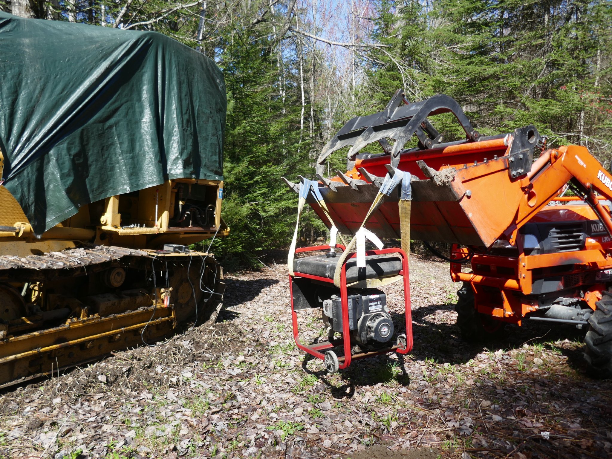

I like to use straps unless chains are clearly a better option. I have a pair of 4', 6', and a 9' that I use logging so they are on hand. They work good with a tooth bar or grapple. Happened to need a battery charge out on the landing today so took a picture.

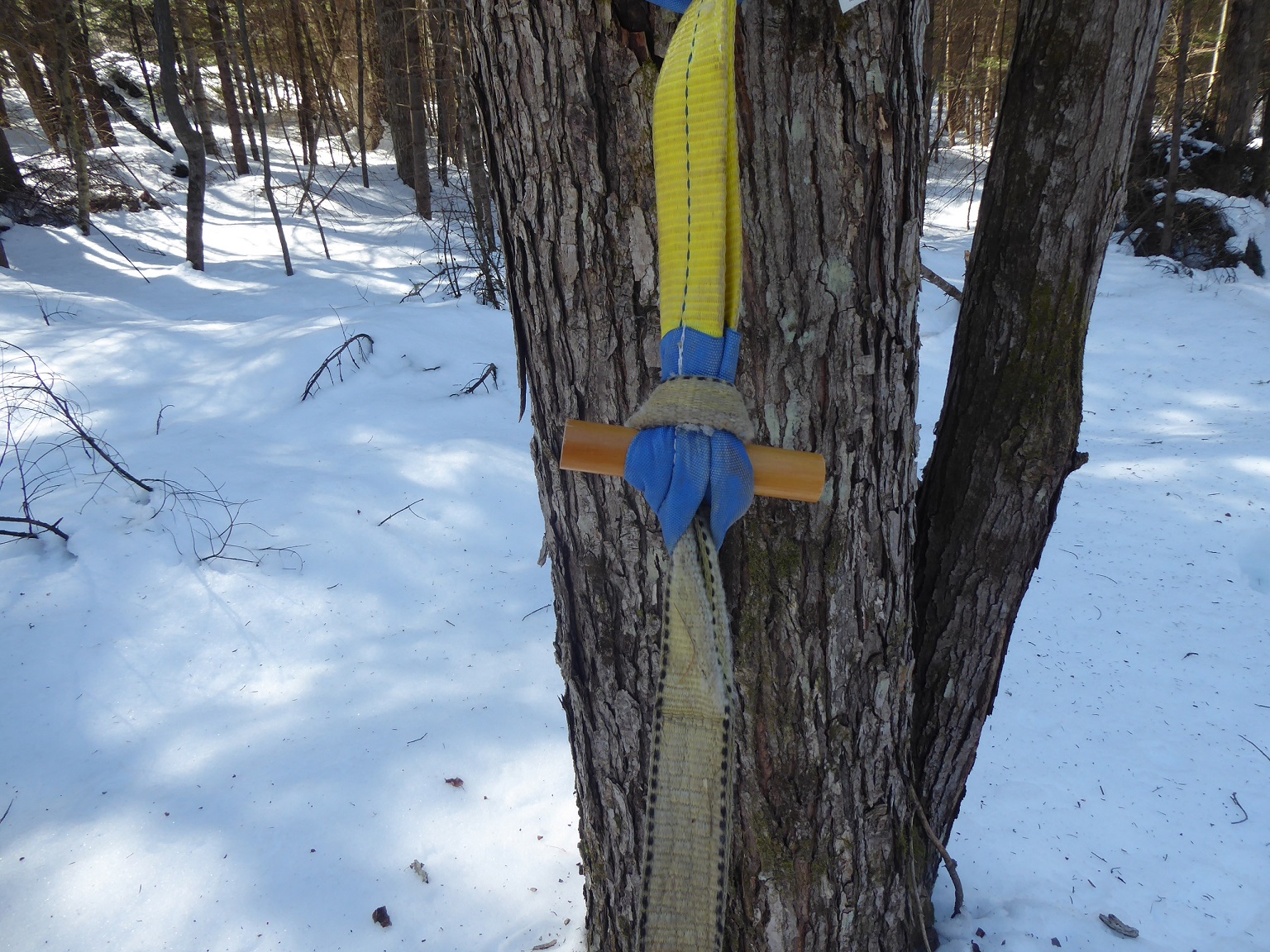

While talking straps - if you ever need to connect two together then put a dowel in the joint so they come apart easy.

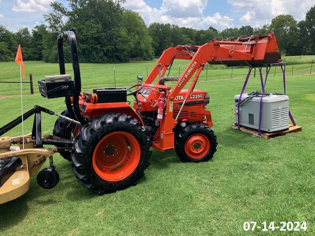

Yup I vote for these. Harbor Freight. But all three sizes. You'll never break them unless you drag logs with them (from ground contact).
