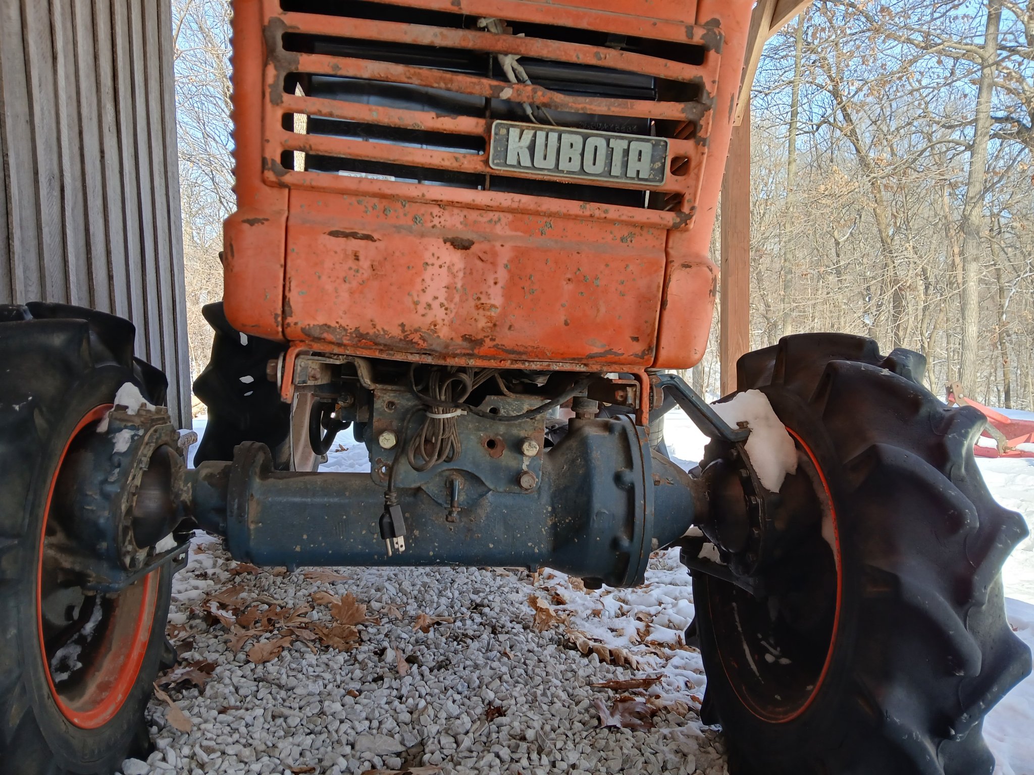

Here is the front of my tractor. There is a mounting area with M12 holes. My idea was to drill a piece of track and install here. The track that I have is roughly 16" long and 75# at most.. so I am a touch gunshy that this may not be enough
12,900
5,631

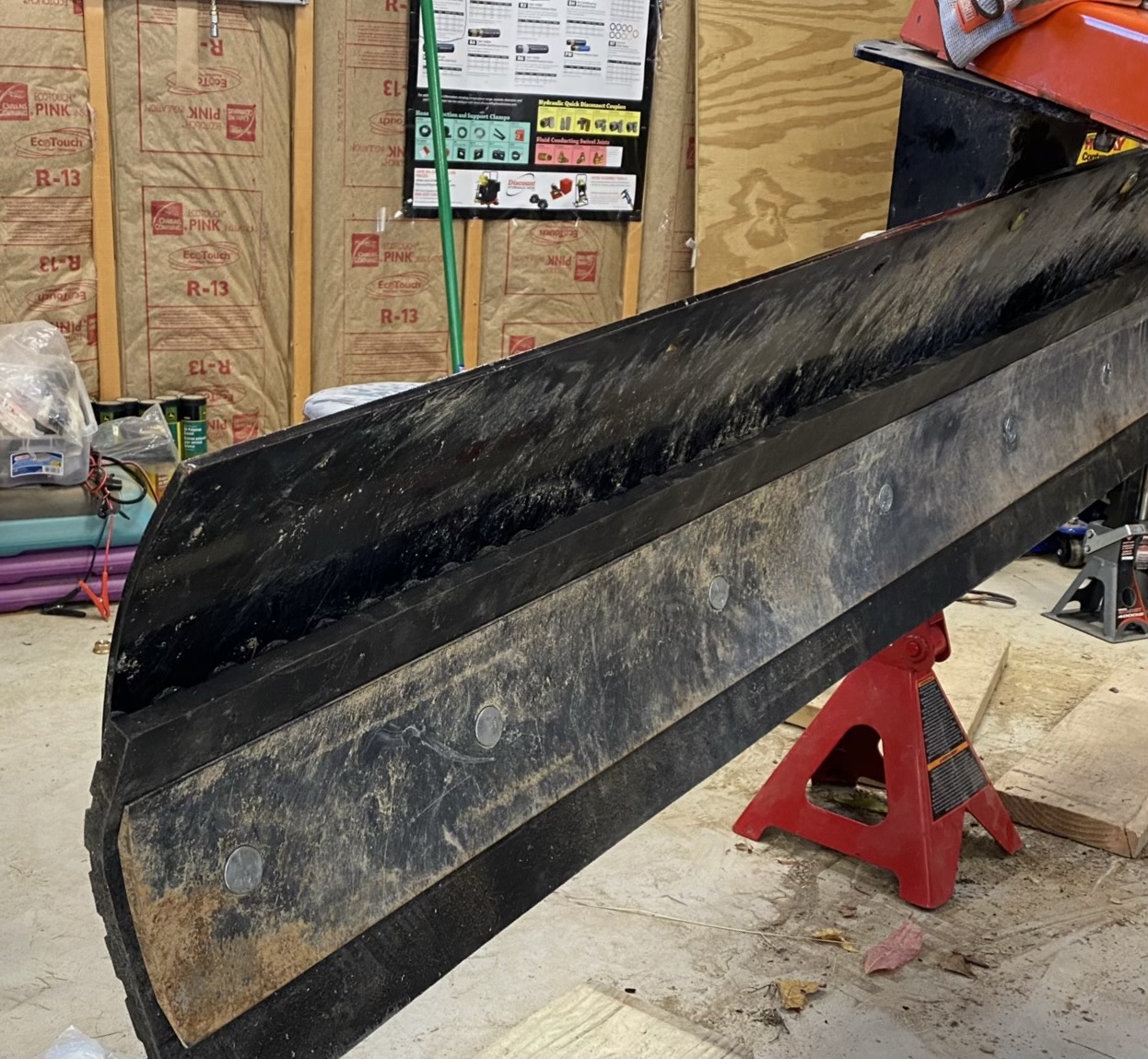

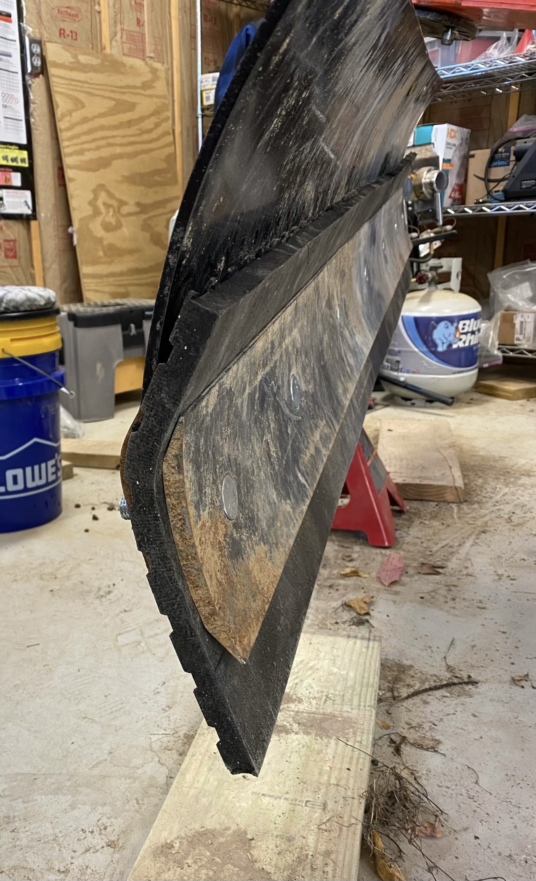

I modified a rear blade with a sandwiched section of horse-stall mat, which works really well on my gravel driveway.
With some snow in the FEL bucket for weight, loaded rears, and my fat butt, haven’t had the need for chains yet.
