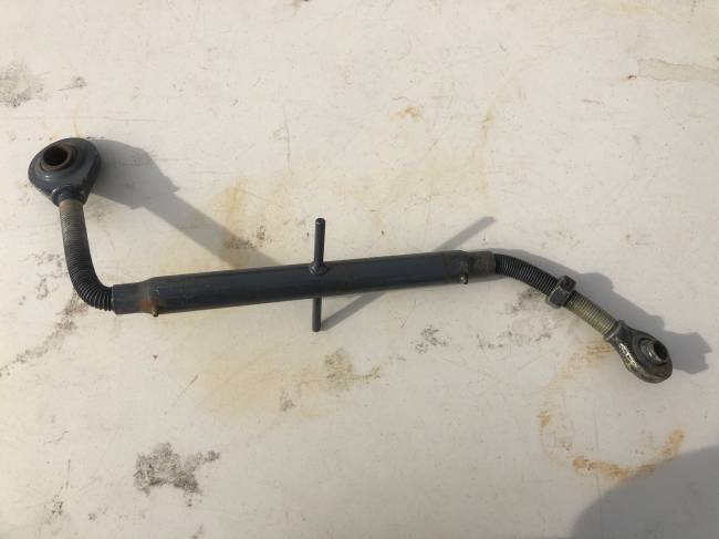

Mystery solved........................it is not going to come apart easily. I removed the small screw (you can see it in the picture) to open the access hole and then cleaned the grease out. (There is a threaded hole on one side of the tube only). When I had cleaned out enough grease I could see a place in the thread that looked like it had been hit hard enough by something like a center punch to leave an indentation in the thread. This is probably done to limit the threaded rods outward movement. I guess that I can put the assembly into a vice and force the threaded end out, and then try to chase the treads but there doesn't seem to be a good reason to do it. One of the replies mention that the threads were marred on purpose at the factory. Good call on that one. So, here it is. Bent top link on a B series? It is time to buy a new one

In the woods making a new trail. Had the front bucket and a rear blade attached. Backing up, sudden stop.............didn't think too much about it until I was was taking off the rear blade, and there it was, a bent top link.
My question is the threaded ends. You would think that they would unscrew all the way out, and you could just replace the end. You would think..............................but they don't. They come to a stop before they come out. I can't see how they made the assembly to do that. Lastly, what are the two small screws for? There is a grease fitting in the middle, the stop nut fixes the adjustment position. I don't see what they do.
Anyone have any experience with this? View attachment 51193
