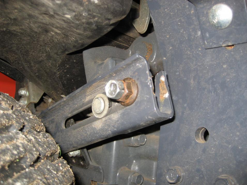

My BX2350 won't lock into the top position either. Tried the adjustment method and ended up turning the screw all the way in with no more adjustment and the adjustment knob still won't turn to the top position...any ideas?

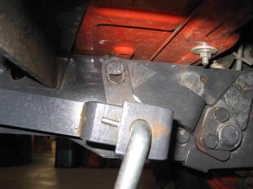

Take pictures of the adjustment screw as well as the rod. Make sure that you have raised the three point as high as it will go. Raise the three point until you are sure that it is all the way to the top. The belly mower should raise at the same time that your three point does. Once both the three point and the belly mower are at the highest position that they can go, then take pictures like the ones that I have posted here. That will show us your linkage and maybe we can see the problem from there. That is the best we can do to help diagnose your problem, if we can at all.

Mower and 3 pint hitch are all the way up. And the adjustment under the left rear tire looks like the one in post number 5. I still haven't figured out how to post pictures here yet.

If you need more latitude in adjustment ( I'm wondering if height ajust/locking dial may have a problem ) there's an option of removing the locking nut from that bolt in picture from post "5" ( ? ) .

I think that a longer bolt would be more likely to break. Look at my pictures in post #19. That bolt is held in place by just a nut spot welded in place on the bracket. A longer bolt would be more likely to break than a shorter one.
