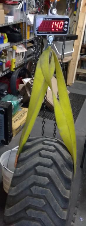

I've got a BX1870 with turf tires--how much does a RimGuard loaded rear tire weigh? Can I roll it up a wide board into the back of hatchback? (No truck or trailer, unfortunately.)

I looked up the weight of rim guard/beet juice and it adds 80lbs to the tire assembly. Should be able to get it into your hatch as long as it will support the weight.

I had the exact same problem. Called Rim Guard and they told me that they learned (the hard way) that Rim Guard and the rubber stems and the glue are incompatible over time. The solution is to take your wheel tire combo to the Rim Guard dealer (they can tell you who’s closest) and have them replace the valve stem with a metal one. The dealer should be able to reuse your Rim Guard and only charge you for the amount lost in the process. And yes, you should be able to roll the HEAVY wheel/tire into a vehicle. In my case the dealer had a big guy who could lift it out! I couldn’t!
