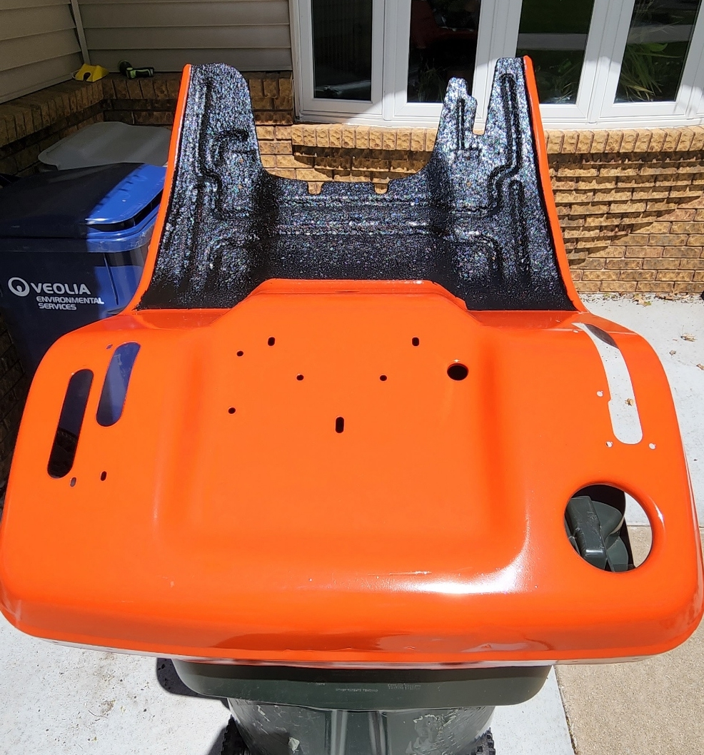

Last spring I did a light restoration on my G2160. I used Herculiner roll on for the floor pan. BTW I HIGHLY recommend getting rid of rubber mats. My pan was beginning to rust so I had quite a bit of sanding and refinishing under there before hitting it with my spray gun Kubota orange then the bed liner. So pleased I did it
