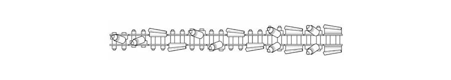

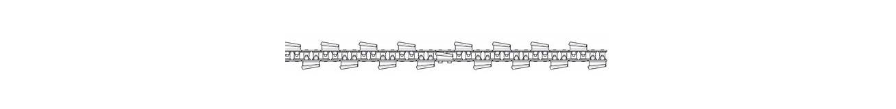

On your chain, are the teeth all set in the same position? Trencher teeth have a pattern so at least one tooth will dig narrow, then wider, then wider yet. This allows the machine to function more efficiently. Here's an example of a chain with larger teeth. The second picture is rock teeth, but you can see how they are positioned to cut at all widths. Maybe those are not adjustable, but most are.

Thanks for the info,, this was built as a hand driven, home owner trencher in the 50s by a company out of moline light duty home owner,, made to attach tree or post and hand crank as you go. in sand and light mull she is ok rocks and other ,its light and jumps.
