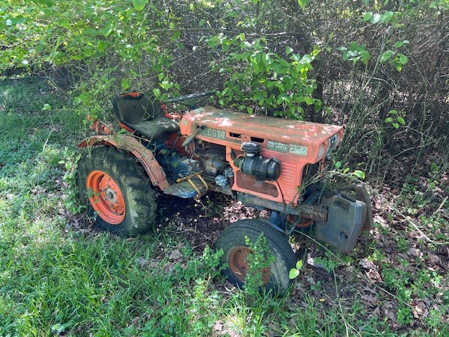

Good evening all - I have now in my possession a wonderful dirty old Barn find. A B6100e with 1600 hours on it.

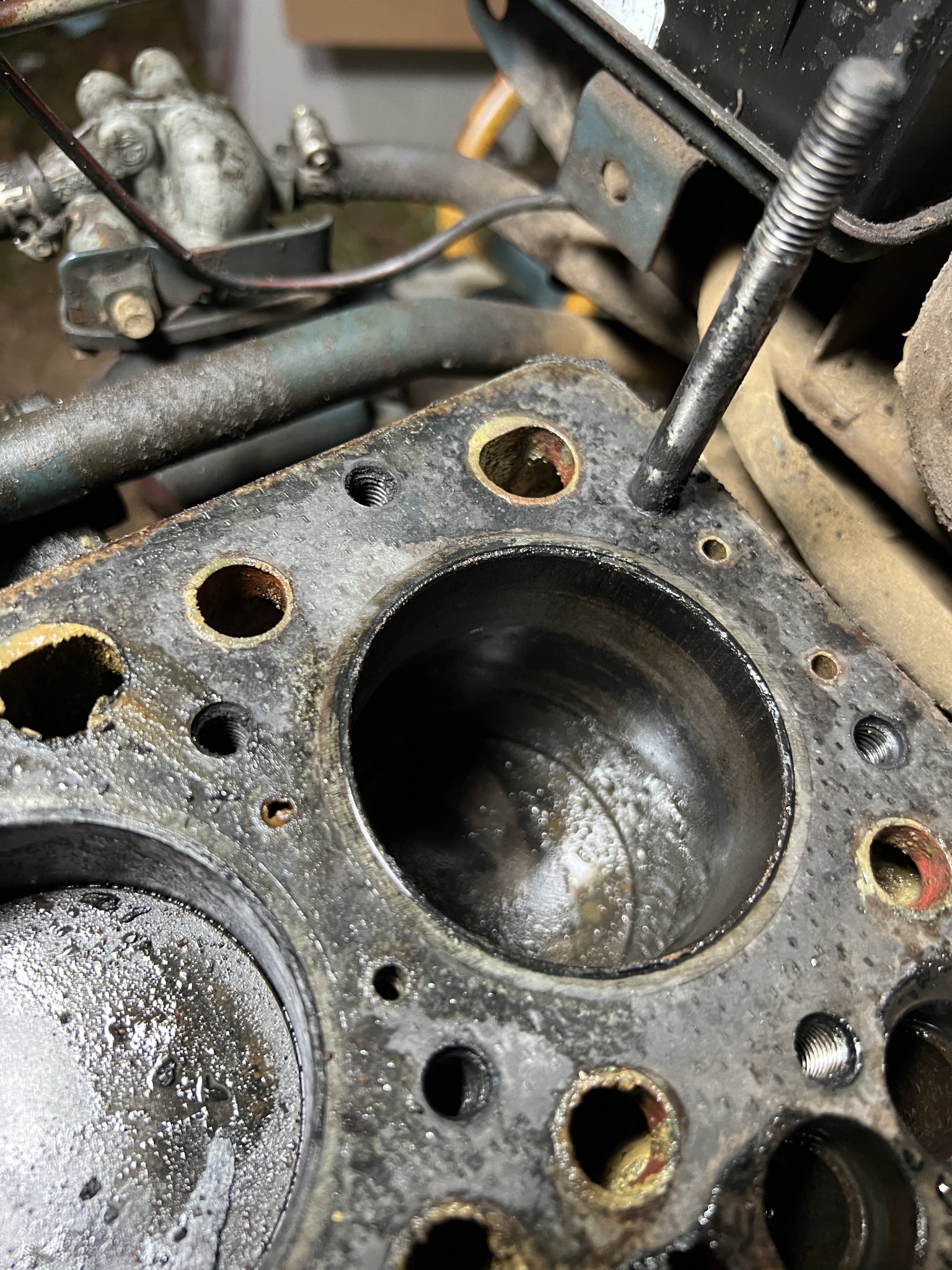

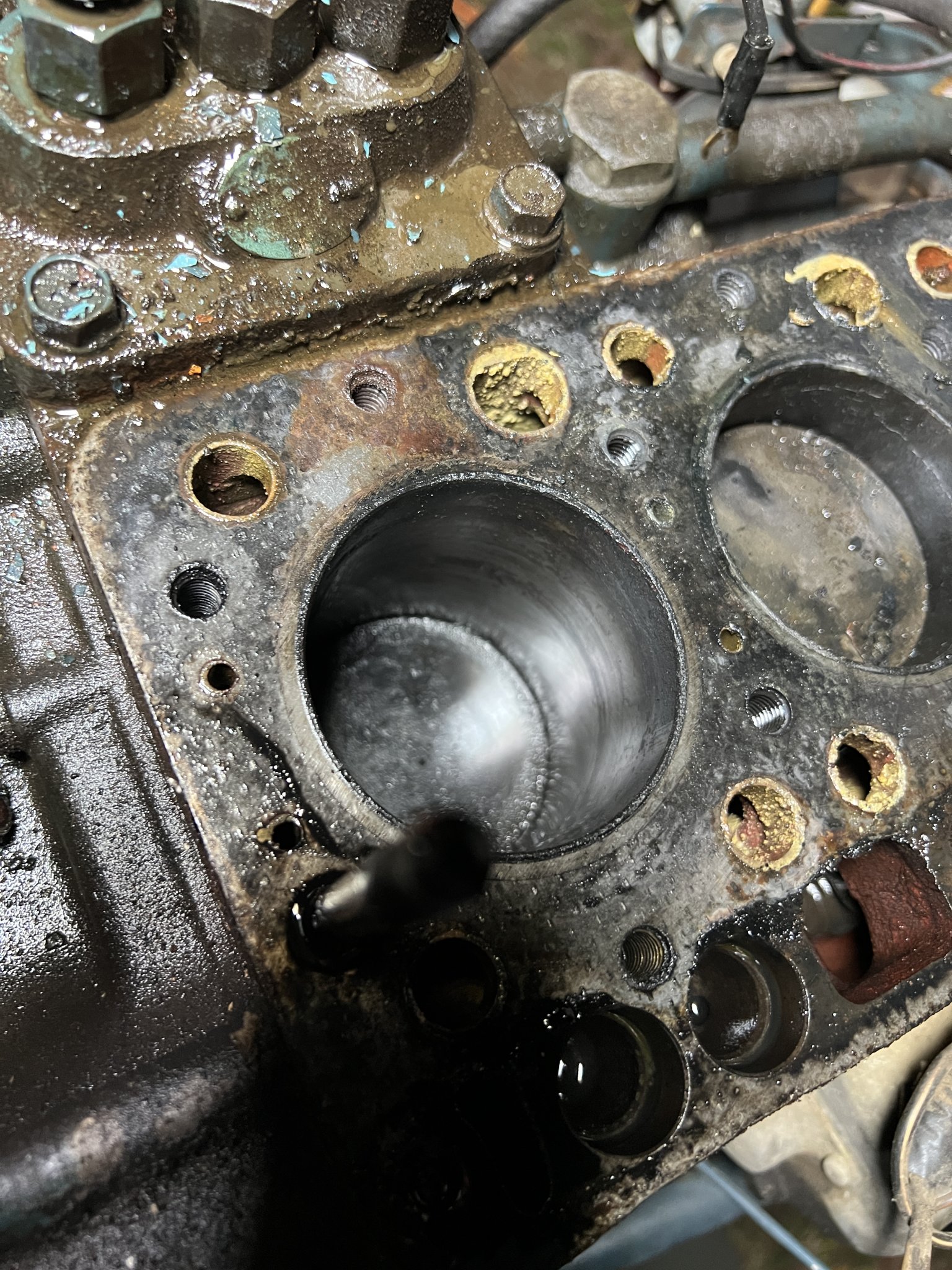

Pull the head and post some pictures of what you find.
Also take some pictures of the cylinder side of the head.
