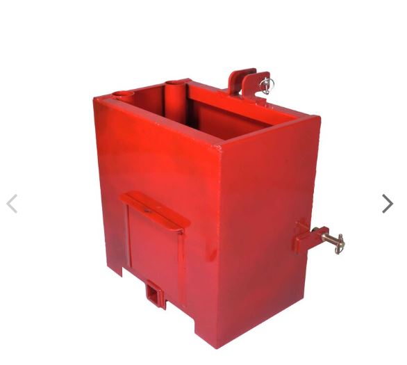

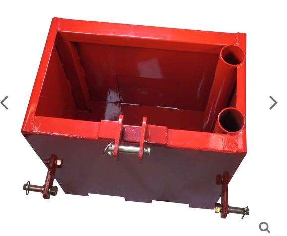

This is what I ended up ordering. Be here Tuesday or so.

Is that the titan box?
Yes, it's a Titan. On sale right now. And I need it. I got 4 pallets from a nursery today, and the BX2680 was unstable with just 4 wooden pallets on the forks. I could feel the rear end trying to rise above all the hate and nonsense in the world today. Ballast box should simmer it back down into submission.
