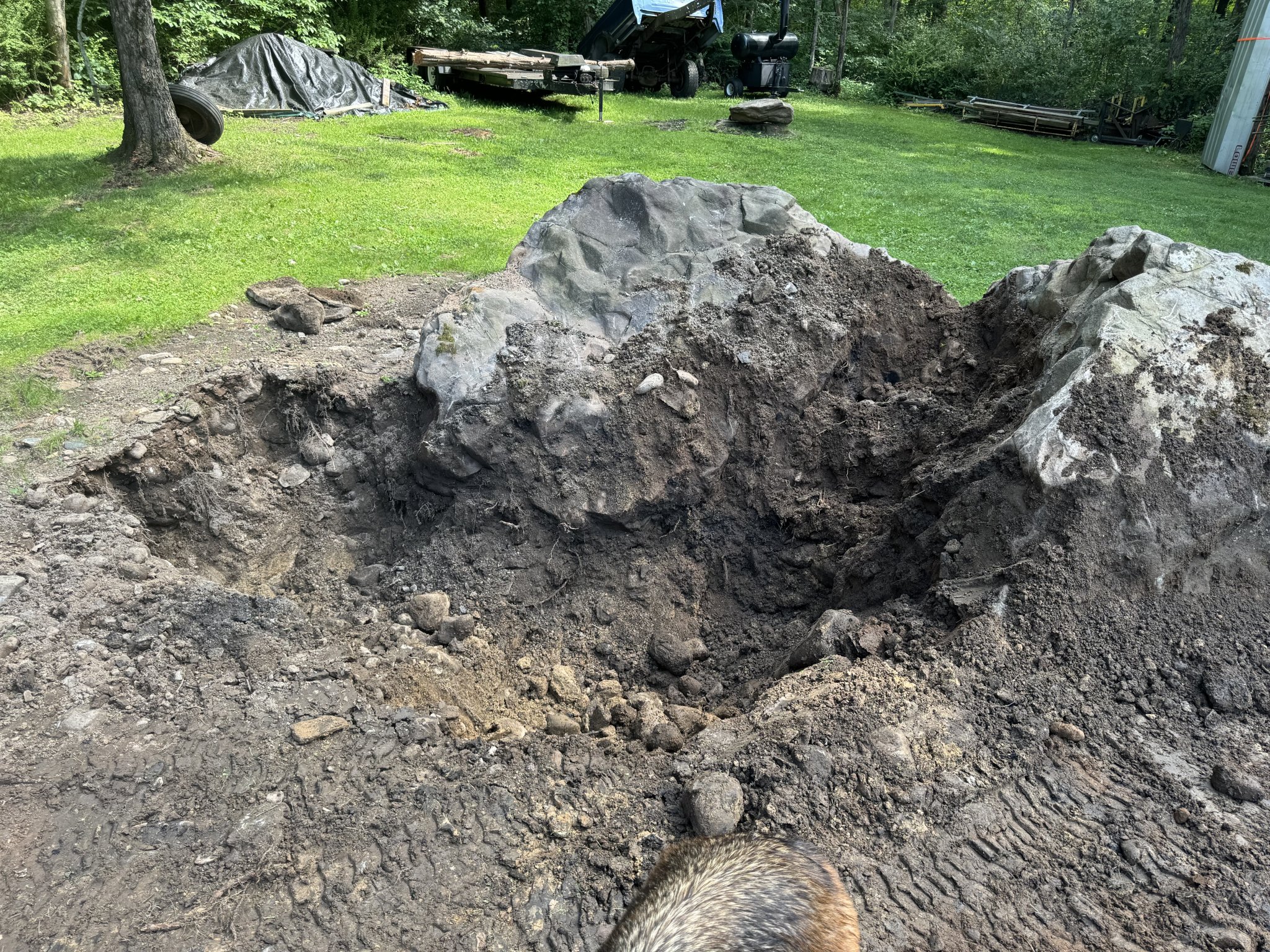

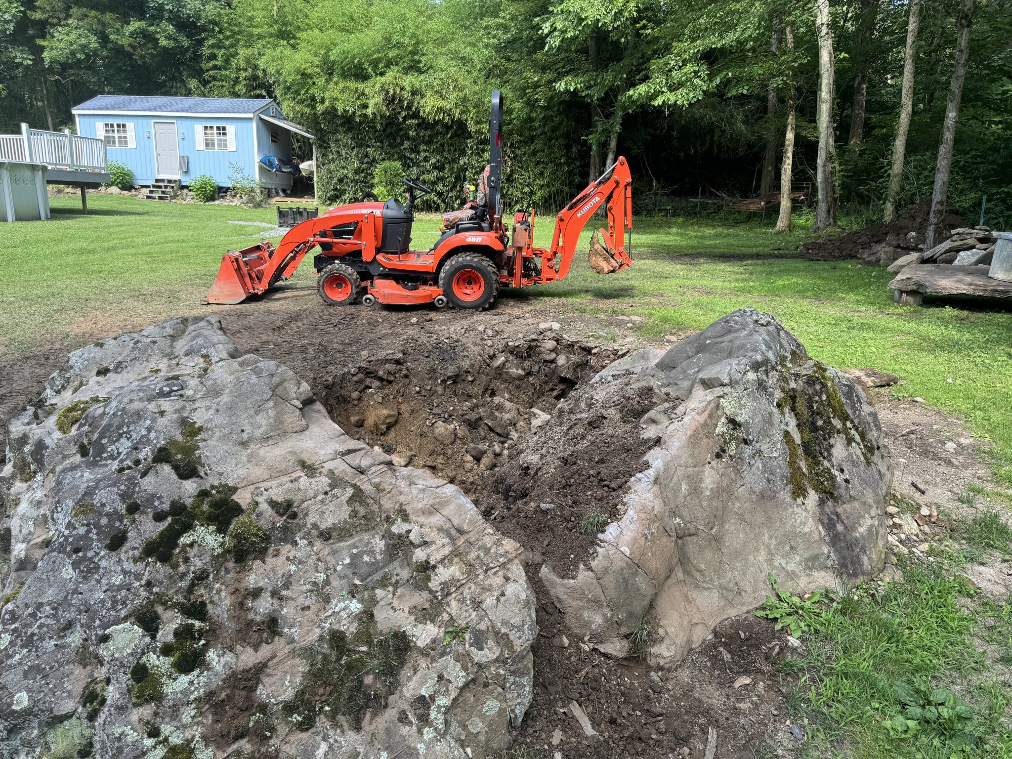

I've been thinking about a backyard pond/water feature for quite some time
I've got 2 rock formations that have been here, probably since Jesus walked the Earth
It has been my fire pit for quite a few years
But all the kids grew up and doesn't get much use
Anyway, I started digging today
I will add pictures as a progress

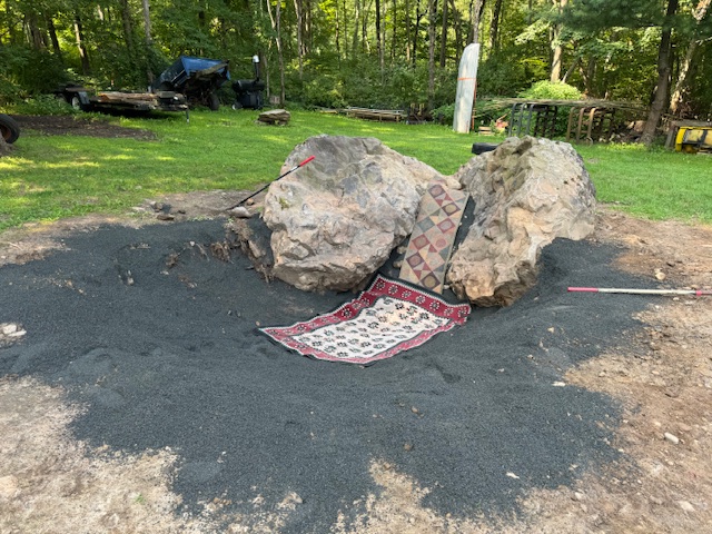

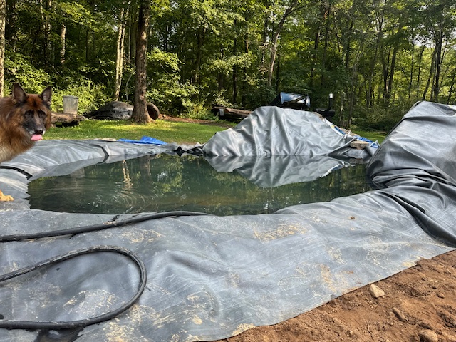

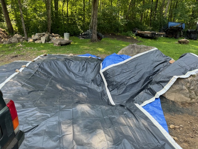

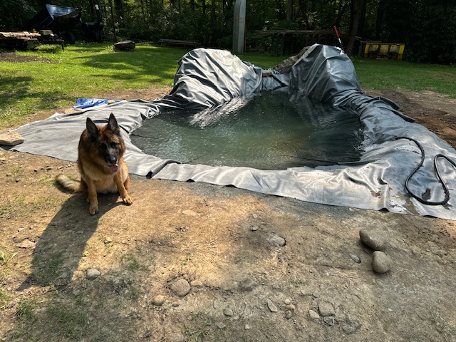

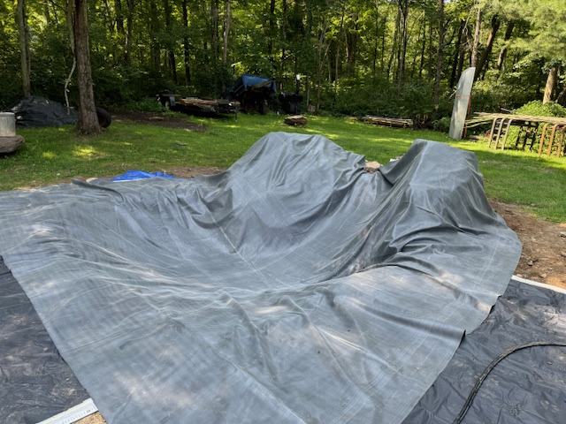

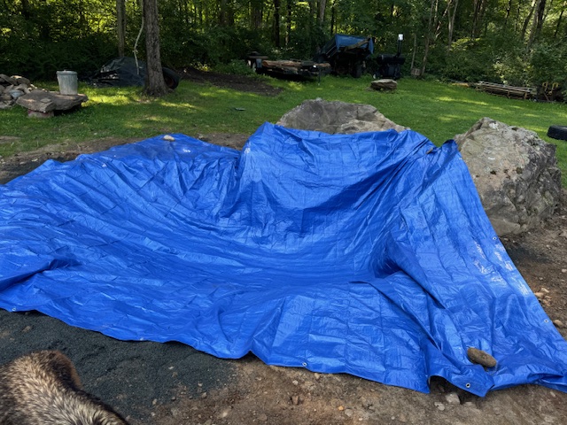

Well,
I dug out quite a bit...
close to 6' in the deep end close to the big rocks.
Covered everything with Stone Sand...
some carpeting as underlayment....
Blue tarp.
Heavy duty Billboard tarp.
45 Mil rubber liner.
a little overkill... but certain no rocks will come close to the liner...
still in the process of banking up the sides.... then laying flat rock / border...
waterfall will be between the rocks....
need to decide on a pump/filter for circulation....
anyway heres a few pics. so far.
thanks for all suggestions so far.

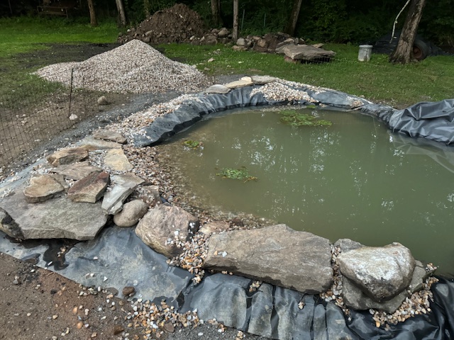

Not much time to work on the pond lately...
But I did manage to lay some flat rock and some native crushed stone...
I grabbed some lillypads from another local pond and they seem to be surviving.
We had some visitors today.... I think the word is getting around in frogtown..
