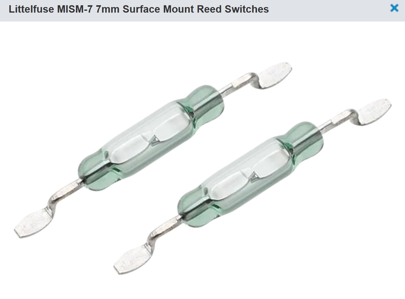

Using a magnetically controlled reed switch is another option, the switch would be mounted near but not to the treadle pedal linkage with a bar magnet mechanically attached to the linkage. In use, the normally open switch and bar magnet are mounted so the magnet bar is long enough that it will start to close the switch as the treadle control is pushed into the reverse sector and the bar magnet chosen must be long enough that part of it continues to be near the reed switch throughout the full range of the reverse movement. This requires no direct mechanical connection between the switch and linkage avoiding issues of designing a spring system that will indicate a small movement without being stressed at full throw.
The type of switch you would want is low cost and is hermetically sealed in a glass envelope making it completely waterproof. These switches are used in many applications and will reliably withstand hundreds of thousands of cycles, for example a typical application was the old "tipping bucket" style electronic rain gauge where an internal bucket measured the rainfall by tipping every hundredth of an inch. A magnetic reed switch was used to capture and report every bucket tip.
This style of reed switch is pictured below, a suitable bar/strip magnet could either be fixed via adhesive or clamped to the linkage and is readily available from Amazon and crafts type stores. The reed switch photo is from Mouser.com which is where I buy 90% of my electronic components but I am sure Amazon and ebay would also have these simple switches.
Rodger
That would work and even better with a second magnet farther down the path to maintain the Reed switch as the reverse pedal is pushed further.
