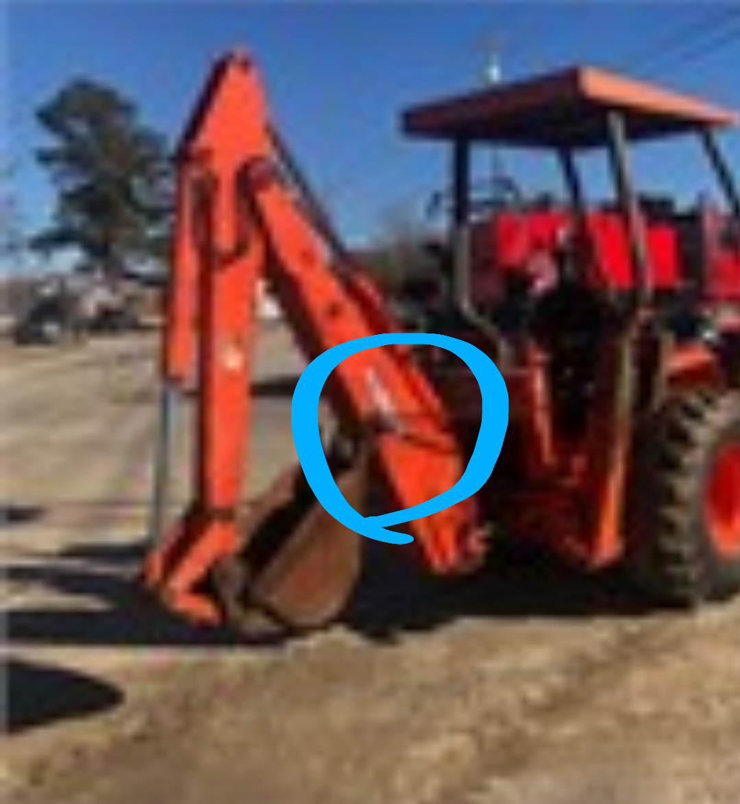

If they're that cautious they shouldn't listen to SGOTI, but here's a (poor) picture of where a previous owner of my L35 welded 3/8" grab hooks on my bh boom for chains to replace the latch pins.
My nephew also welded the thumb bracket onto the stick.
