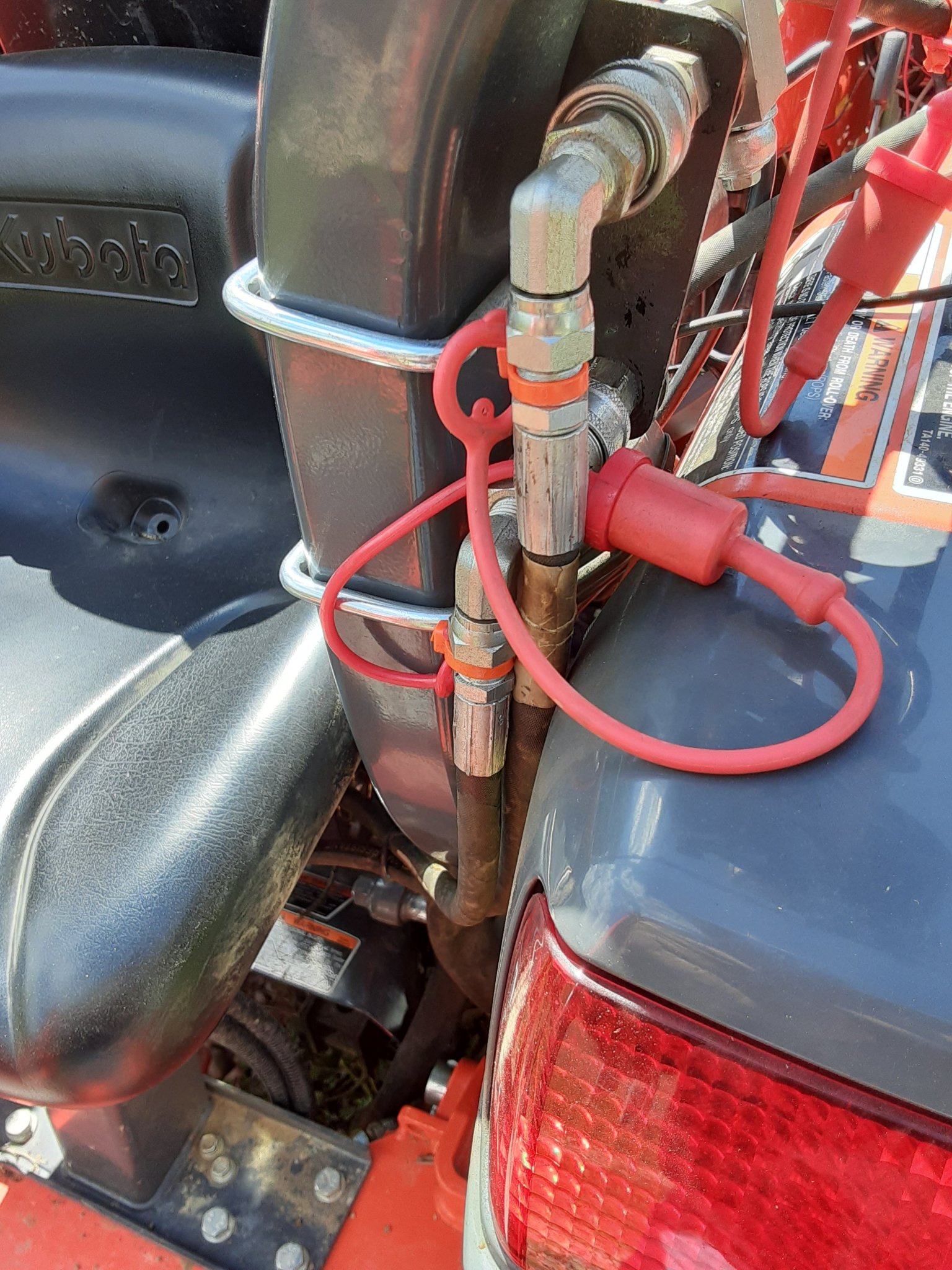

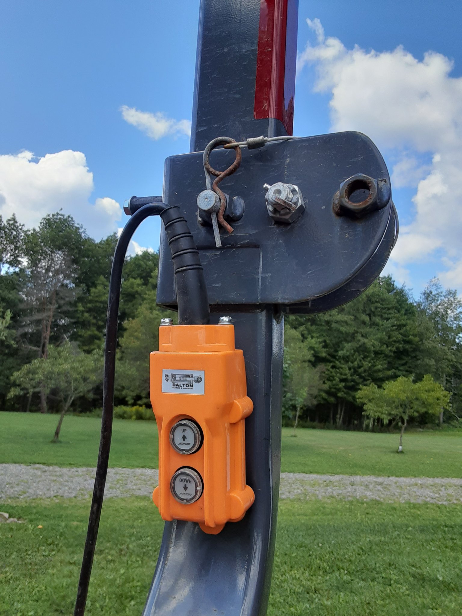

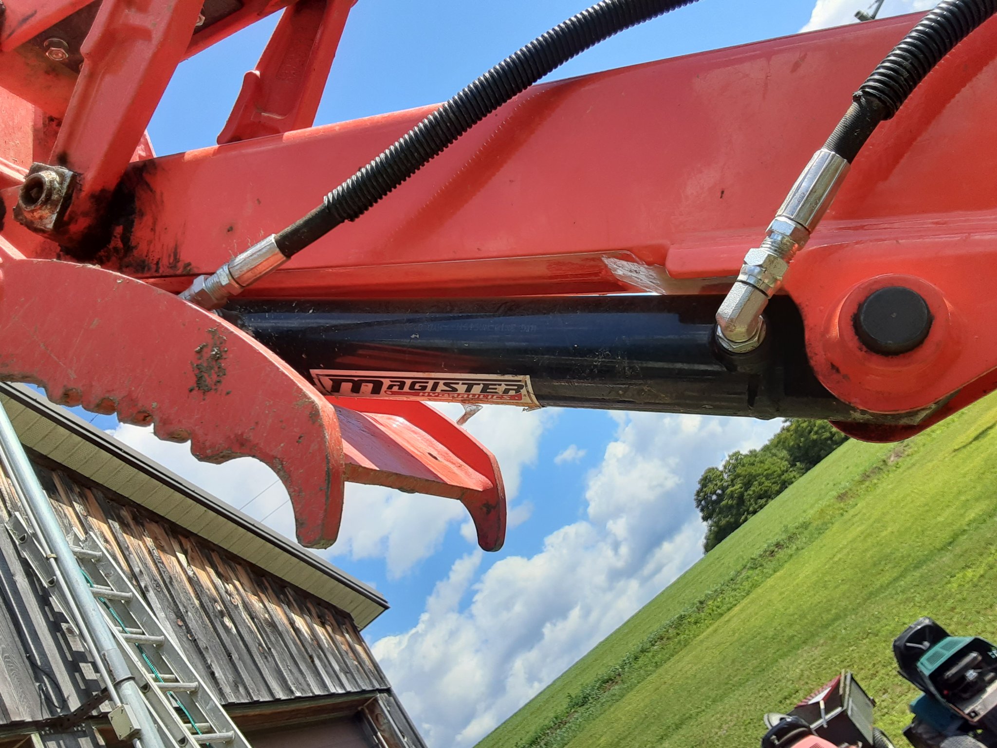

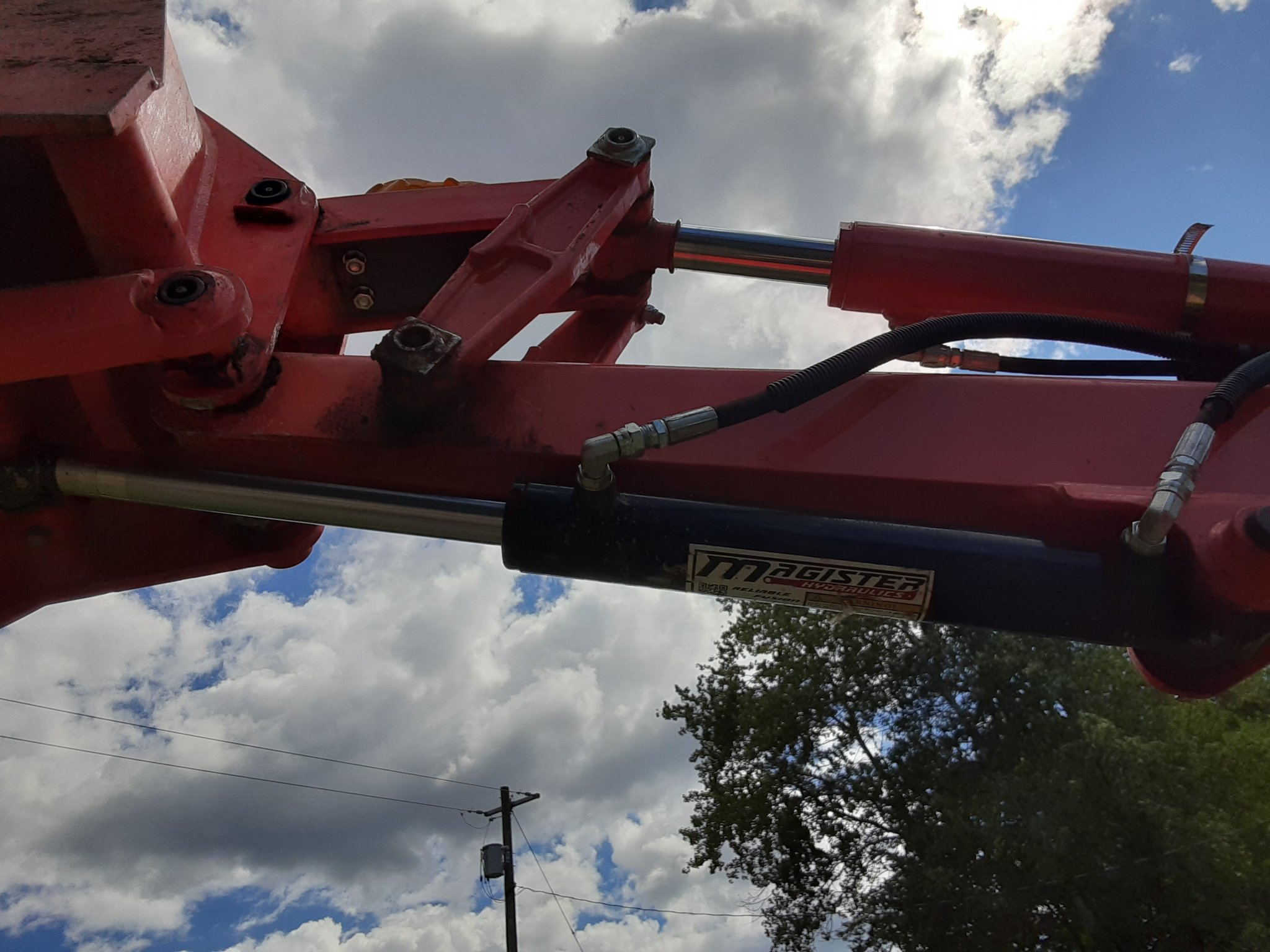

I found some of my thumb pictures. I have been using the push button I got from surplus center and that is OK but wanted to get the switches on the handles. The cylinder from ebay seller had 1" pin holes. I had to put some shaft collars on the thumb end and mill them down a little for width. On the base end I plugged the hole and redrilled it about 1/2" over so that the thumb tucks up tight to the cylinder when up.
