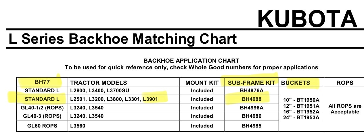

Here’s the information you need.
A quick check of the subframe whole goods # was about $1000 at Messicks—without shipping cost.
I’d consider selling mine but I don’t want to mess with taking my subframe kit off.
good luck
good luck
Thanks for the chart and advice,I probably won't buy new I see quite a few used Woods BH80's for sale at about half the price of a new one and I hear they make good quality products.
