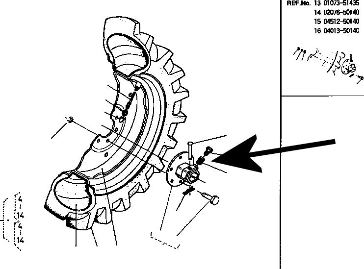

I got the same experience with with wobbling on my newly bought B6001 (essentialy the same as B6100). There is a bolt and spring on the wheel hub that can be tightend. Se the picture below.
I could not get it tight enought so I slipped in a shim on the oposite side of the shaft. That stabilized the hub.
There is also another bolt that goes through the shaft and makes it possible to move the wheel in or out on the shaft.

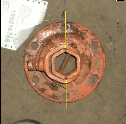

When I got my B7100, I thought it was twerking the first time I drove it on pavement- that rear end was all over the place. The hubs were very loose and when I tried tightening them, I found that they would not clamp any tighter because they were out of travel. In other words they needed more clearance in the area indicated by the yellow arrows in the pic. I cut some more clearance, threw away that lame spring, and replaced the pin with a bolt. (metric or SAE, I can't remember, but it was tighter than the pin) Tightened everything down & they haven't wiggled since.
