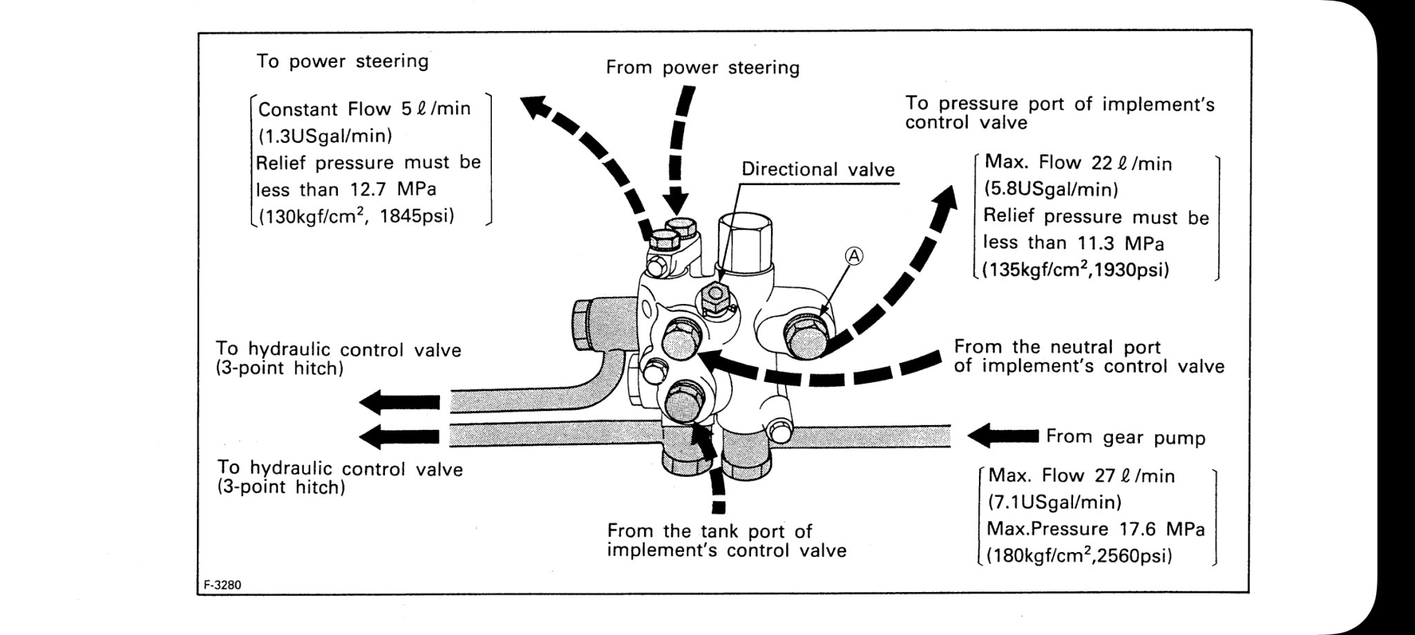

Your loader valve has 3 hoses going to the tractors hydraulic block - see diagram below. The neutral port is PB and tank is tank. If those two hoses are accidentaly swapped the loader will continue to work fine but your 3pt will become inoperative.

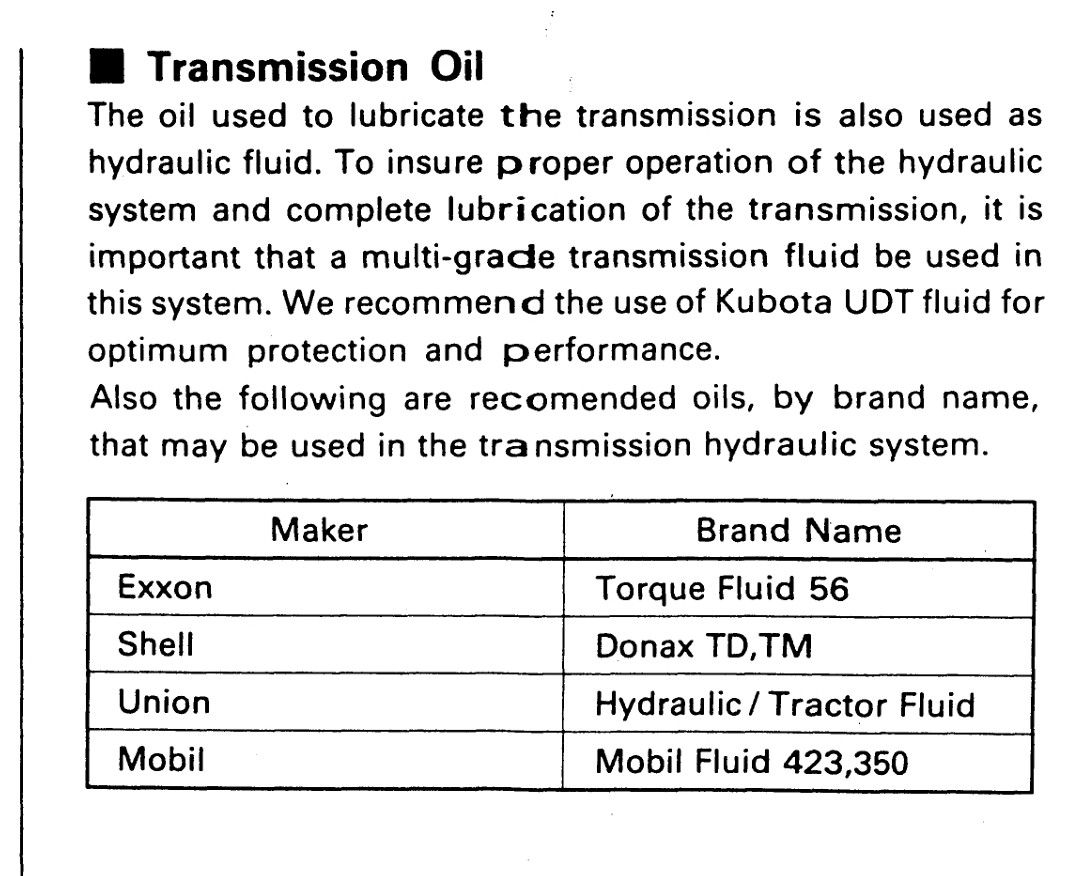

In the OP, "acceptable oil" is listed as the replacement. Was this oil the recommended Kubota Hydraulic Oil, such as SUDT2? This may be what was meant but I'm just checking all the boxes.

The recommended oil.
In terms of this problem it would not matter if he used baby oil....

OK, good to know. There have been quite a few posts comparing hydraulic oils, etc. Since this is a new member and possibly someone new to Kubota, I thought it possible that if the wrong oil was used, it could have made a difference. Wrong once again. :) I am batting 1.000!

From what I've come to understand Kubota engineered their hydraulic oils to handle fringe cases like extreme heat, extreme cold, extreme moisture, etc., and any damage from using "the wrong fluid" would be over time and not immediate. Dealers seem to often sell "the good stuff" at or below competitor pricing as if Kubota wants their products to have long lives. At least in my case the above held true, others situations have differed.

On that block is a ”directional valve” that needs to be turned to the correct position for the FEL and 3 point to both work correctly.
Do you have an operator’s manual to see how that works? @TheOldHokie may be able to post that diagram.
I doubt that is your current problem but just wanted you to know that it is there. If it gets turned accidentally it will cause problems also.

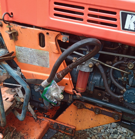

Learned something... When the loader is disconnected, I must loop the supply line to the loader to the return port to supply the PB implements. Go figure. I have the B9200HST-DP WSM and this is not discussed. Found an Operator Manual online and I have yet to find anything that references this. Should I be doing something else? Once I get done servicing the front end, I'll put the loader back on and all should be fine.

You dont havd to loop them together. When you disconnect the loader turn the selector valve on the outlet block counter clockwise. When the loader is reconnected turn it clockwise.
