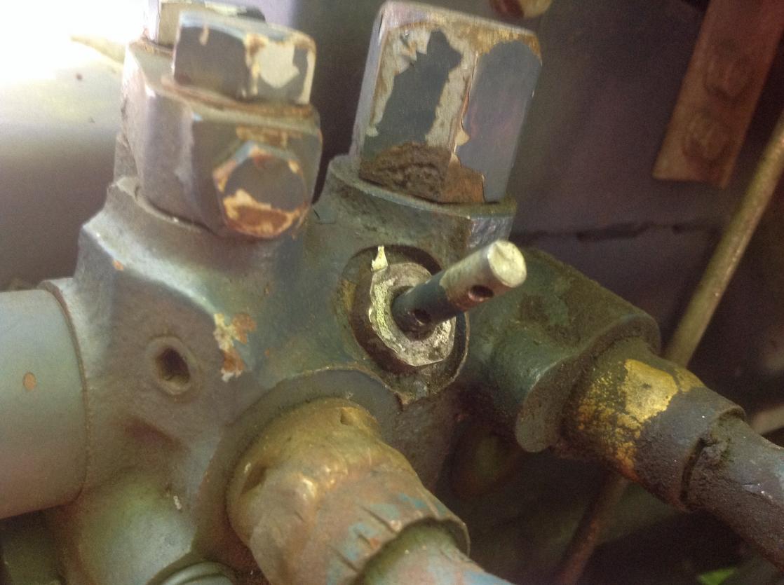

Hi Wolfman, sorry about the terminology, new to all this. I believe it is the divider block 12064. I have included a photo of it attached. Also, here is a YouTube link I took of me turning the directional valve on the divider block. I say directional valve because there is a diagram that names it on the side of the tractor under the seat by the gear shifter. Here is the YouTube link:
http://youtu.be/k0UahYJG7uA
Sam

For the directional valve see this thread: http://www.orangetractortalks.com/forums/showthread.php?t=14342&highlight=directional+valve
It looks like you are missing the roll pins that limit the travel of that directional valve knob. It is supposed to be able to turn freely if these pins are missing. It isn't a screw, its the clock position that it is set to that matters.
From your picture it looks like it is close to the correct position for when the loader is installed. Assuming the pin stub that you can see on the left side of it isn't bent, the knob should be turned a few degrees counter-clockwise for the loader connected position.
If the roll pin stub where the hour hand on a clock, your's looks like its at about 8:30 and it should be maybe just shy of 7 O'Clock (from the base of the pin if it is bent)
The pin is supposed to be trapped in the red arc. For loader operation it should be just to the right (counterclockwise) of the red circle.

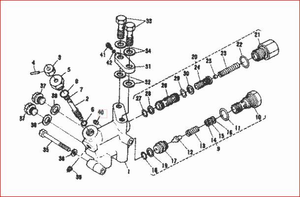

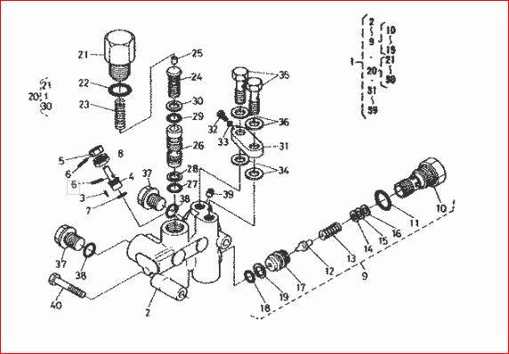

This is how you break it down to replace the pins.
Drive out the pin marked in blue, removing the top nut
Drive out the pin marked in yellow.
Remove the nut marked in red, and remove valve.
You can drive out the pins on #8 nut and replace
with 2 metric roll pins / spring pins or (#3)
you can get them at a local hardware store or order the originals from below.
Then reinstall valve shaft and install 2 new roll pins (#6) in the valve bottom one like in Murky's pic, leaving it stick out to run into the 2 (#3)pins as stops, then reinstall the top nut.
If you have any issues, drop me a PM and I'll get you any more info or help you need.
2x (#3) 05411-00316
1x (#5) 67810-38160
2x (#6) 05411-00316
1x (#7) 04811-00090
1x (#8) 67850-38520

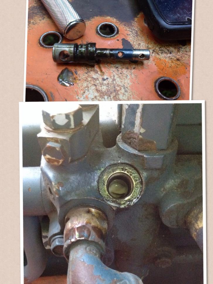

So I removed the two pins and the nut on top of the stem. I needed a deep socket I believe 18 mm or 11/16" which fit the top nut and I hope it will fit the bottom one too. I will work on it tomorrow and update the status. Here is a picture of what it looks like so far. BTW, I'm not entirely sure what removing the valve stem and replacing some pins is going to do. It is making a grinding noise when I run it, but it is very short lived, like once a minute and for a split second. I hope that once I remove the valve stem and then put it back in place, maybe that will fix it. I understand about the limiting pin that keeps the valve from spinning indefinitely, I have tried turning it very, very slowly while also trying to raise my loader arms, and even if I do get the pin in exactly the right positional I think it might be a deeper problem. If I have to replace the whole divider block, I may do so. Any idea of the cost of a block? Thanks, Sam
28,929
5,288
The whole valve is P/N 67850-38104 $394.70
But if you get to that point take it off and box it up and send it to me I can rebuild it right for way cheaper! ;)
I'm wondering if they did damage to the internals when the brazed the 2 pipe fitting into the side of it, not what I would call a brilliant move! :rolleyes:

Ok, well I took it apart. I pulled the valve out after removing the holding nut keeping it in place, after I reinserted it, there was no difference. I checked the rubber gasket on the valve stem, looked good. Here are a couple of pictures of what it looked like when I took it apart. I hope this helps maybe determining what the heck is wrong with it. After I put it back together again, it was still doing the exact same thing making the grinding noise occasionally. I turned the valve stem and there was no resistance just like before. I feel like there is no hope for my unskilled self repairing this thing and I will have to rely on the damn dealer and get raped for $500+ dollars or more to get it fixed. I looked at all the hoses and pipes leading into the divider block and it looks a little more complex and I don't think I have the right tools to even pull it apart and get it so that I can send it out for repair. I'm hoping that it's a hell of an easy fix, any advice?
Sam
Crylozeus
Kubota B8200DT
Jul 8, 2014
10
Cuttingsville, VT
More pics of the valve stem and the cavity it was in, looks to be creamy colored hydraulic fluid, the black in there might just be older fluid I think.
28,929
5,288
I think the black inside is a flat rubber gasket.
It looks like it's all distorted, use a pair of twezzers and pull it out.
It looks like the hydro fluid is getting foamed, or has water in it.
Foamed fluid is a result of air being induced before the pump, but we'll save that fix till you get this one done.
