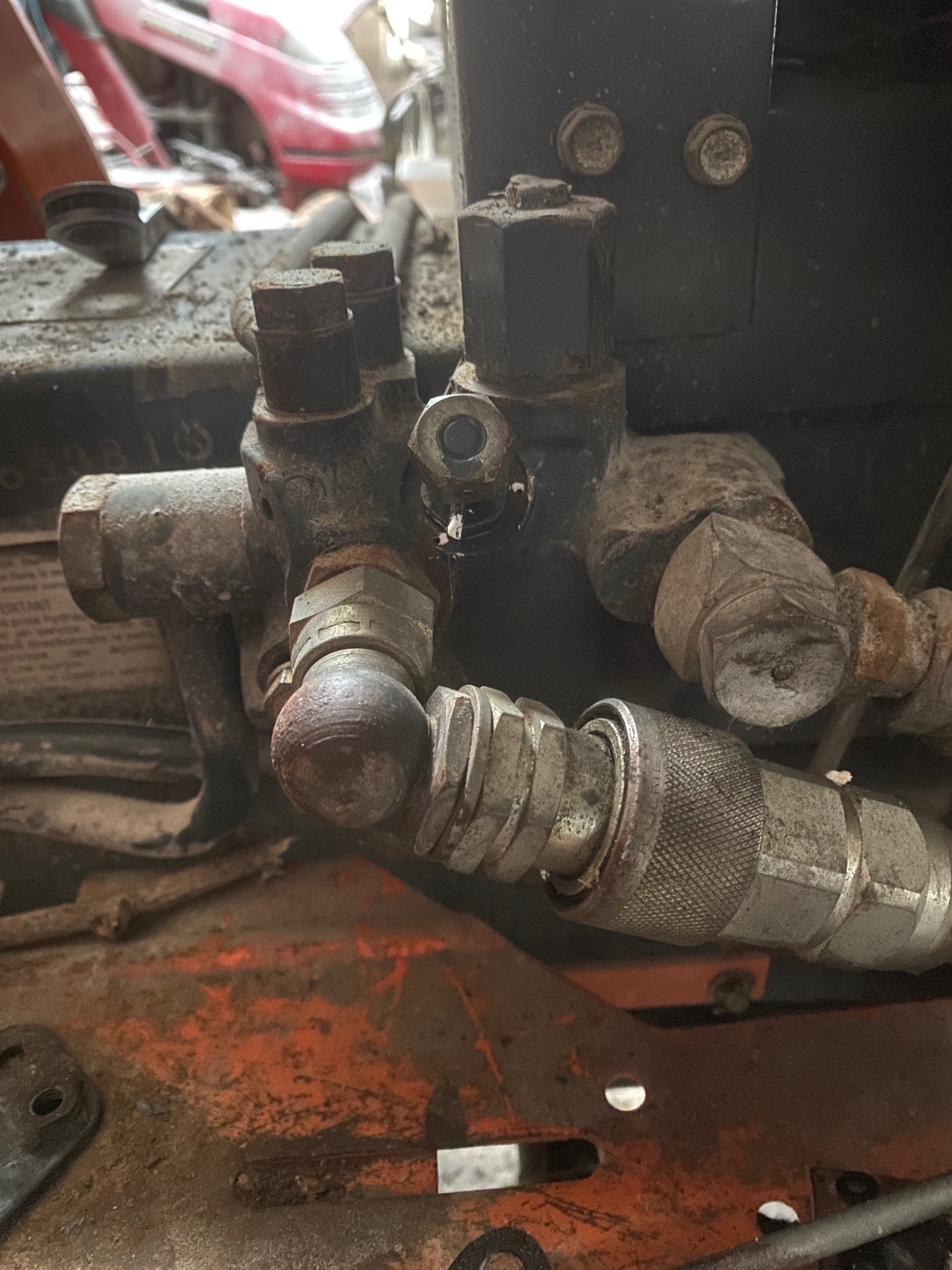

Is it possible a relief valve is stuck open, is there more than one?
Its possible.The main relief valve is in the outlet block with the selector valve.
The pressure test of the loader supply hose will tell us more. If pressure is good then the pump and relief are working. If pressure is low one or both of the two is misbehaving.
While you are waiting for your gauge you can verify you are getting flow. Disconnect the pump supply hose at the loader vakve, stick the end of the hose in a bucket and start the tractor. You should get a good solid stream of oil. Dont run the engine more than 10-15 seconds or you will pump the tractor dry.

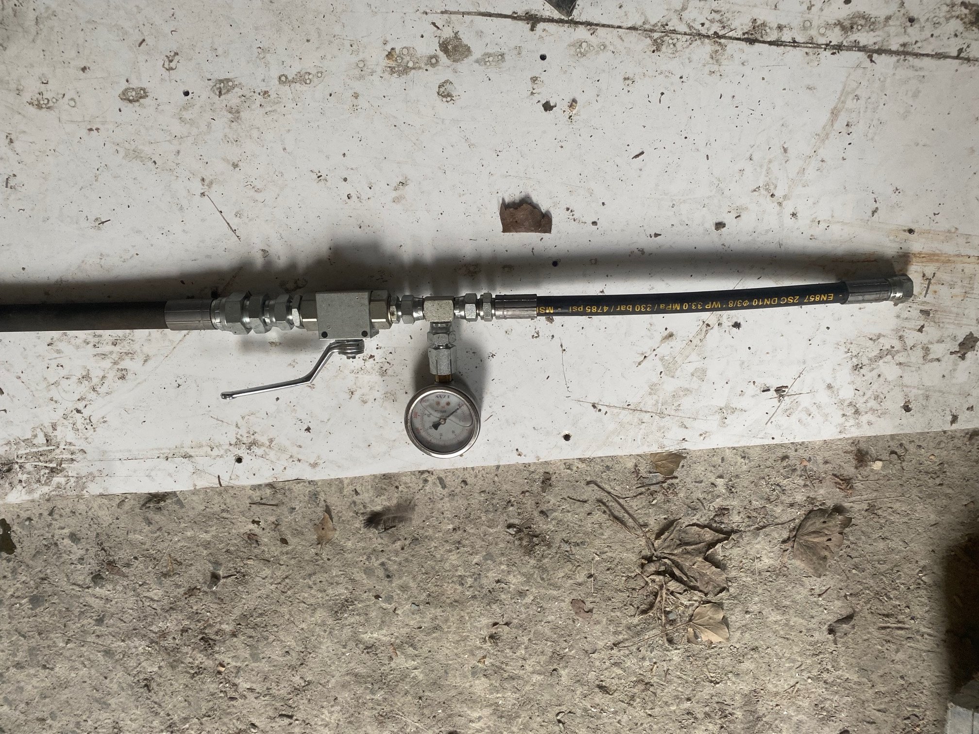

How are you measuring pressure?

I got this made up, i connected it directly from the pump outlet and straight into the the tank, to bypass any restrictions, I got zero pressure, so I replaced the pump.
The new pump created pressure, but didn't check what pressure, then after 5mins lost pressure.

How can you connect that straight to pump?

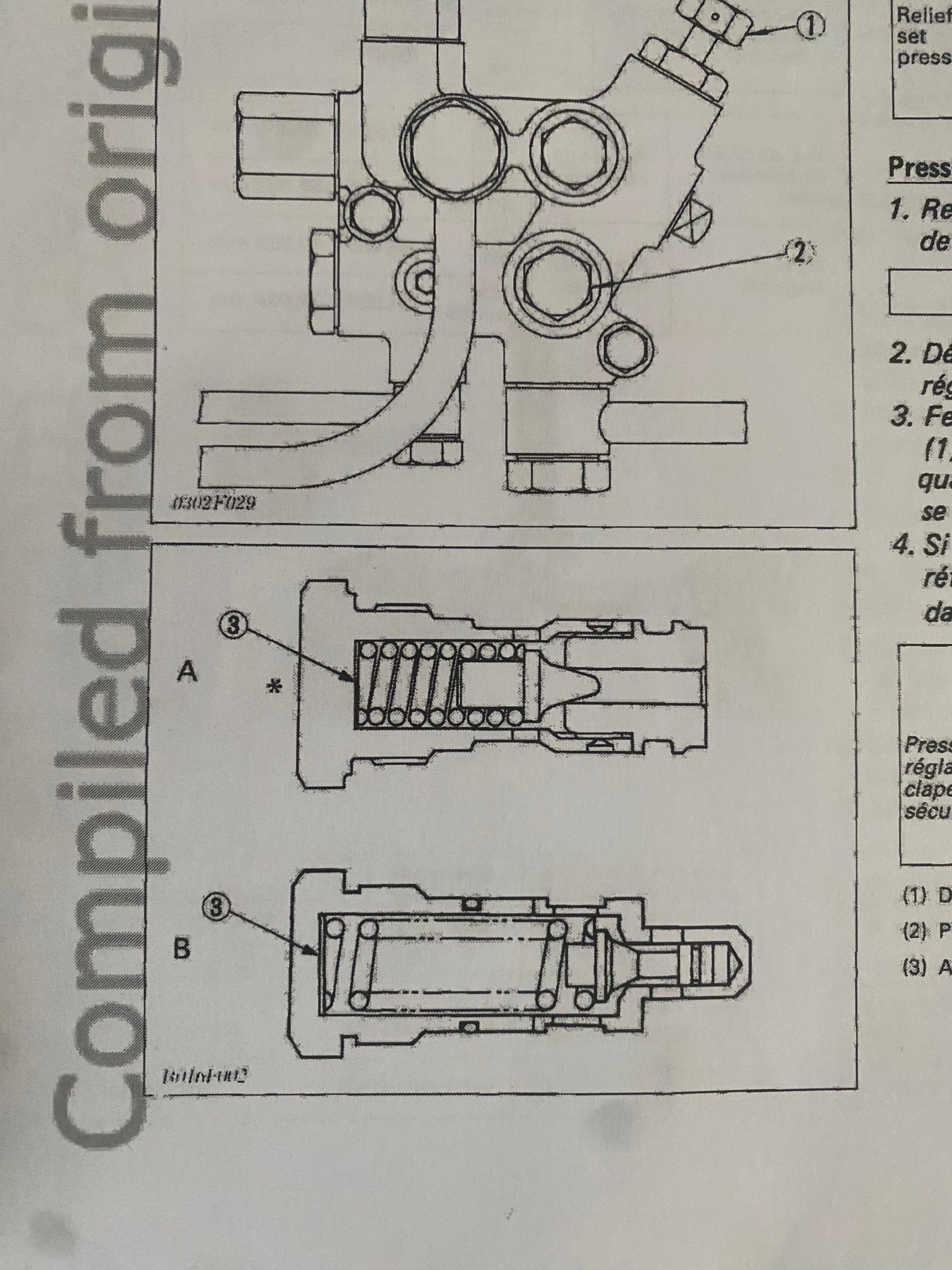

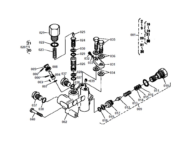

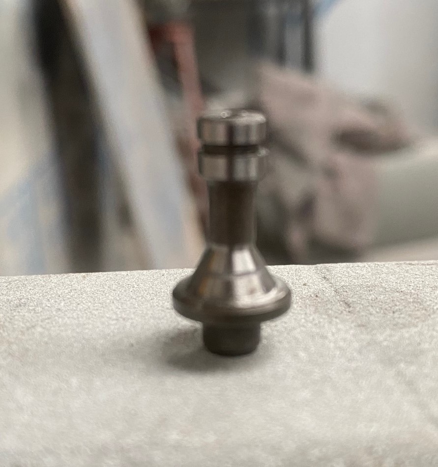

I'm looking at the relief valve at the moment, it's the B type.
The valve head has has ridge on it, I don't know if that's significant?
I'm also looking at distribution block for clues
The relief valve is not in your test setup. Perhaps you should provide more details on how you conduct a pump pressure test using the test rig you pictured
