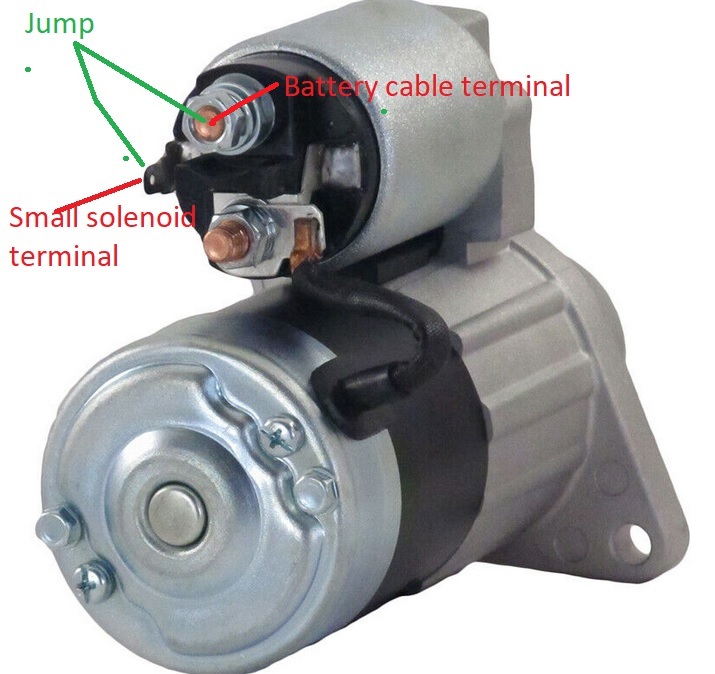

Learn how to jump a starter. I am not referring to booster cables but momentarily connecting the battery terminal on the starter to the trigger terminal on the starter solenoid.
This is a procedure that must be done with the utmost safety in mind as every safety feature is bypassed.
You can end up with a run-a-way tractor or be run over yourself.
Best to have someone in the seat with the brakes applied.
Use a short piece of wire or the shaft of a screw driver to make the momentary connection. Expect a small spark.
The engine should crank immediately if the starting system is OK.
The benefit of this procedure is to immediately tell you where to look. If the engine does not crank then don't waste time checking safety switches.

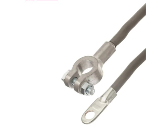

If your battery cables have repair ends on them, get new cables.
The end of the ground cable which attaches to the tractor frame must be removed, cleaned and polished.
All your symptoms are of a high resistance connection.

If you have a cable like the one pictured and you have enough excess cable to do it, remove the cable, cut off the oxidized end, strip the insulation back and tin the new exposed end and reattach it to the battery clamp. Issue solved. Of course clean the terminal and clamp too and apply some di-electric grease or battery goop. Lots available out there to curb oxidation.

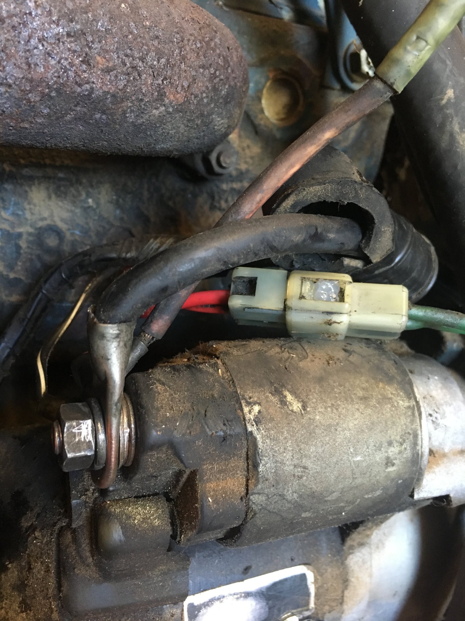

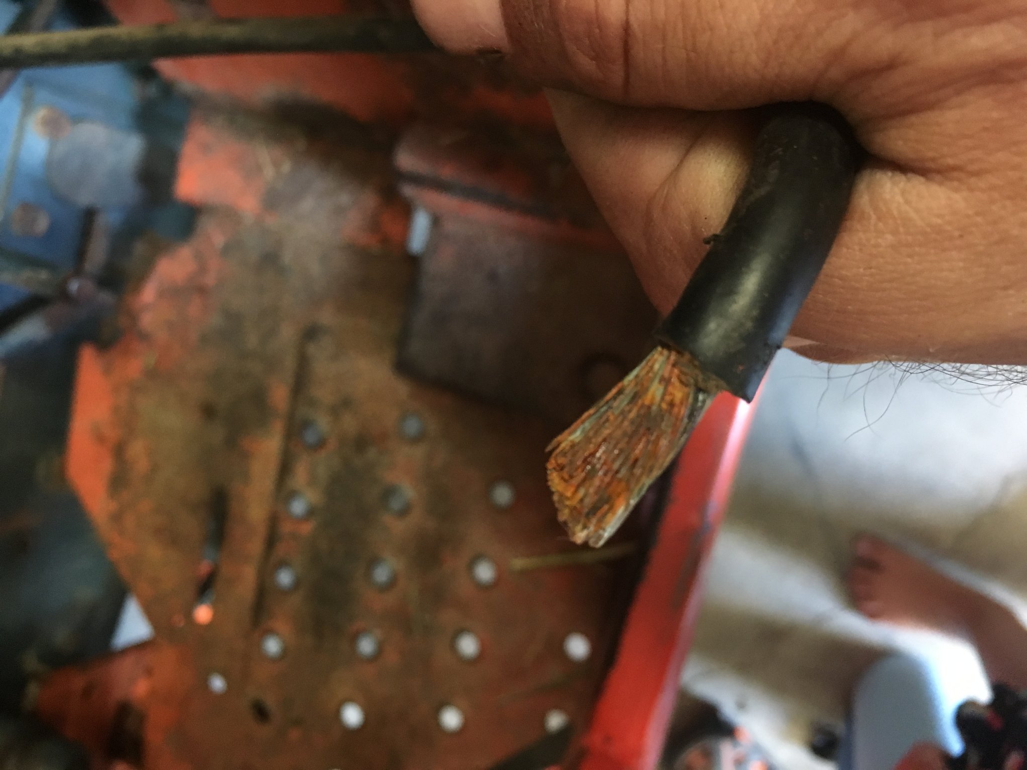

Update guys and big thanks to Dave. After dicking around for a while I finally found the problem. I polished ground at frame connection, still no power. i took positive off at solenoid and cleaned everything up, i cleaned the fuse link connection. I inspected all wiring I could access under dash, including glow plug wires. I had originally checked power at the solenoid and I had 12.6 volts, but something seemed weird. After checking all these wires I checked solenoid again and only had like 3 volts. So, I went back to the battery terminal clamps and sure enough it was the positive clamp, corroded, cracked, and the wire was rusty and green in color. I snipped off about 2 inches and cobbled it back together. Started right up. So it was a very simple fix.
2 questions.
My battery has posts, so how do I avoid using these clamp type ends?
2nd question off topic, I had my dash unbolted and loose, and I attempted to get my steering wheel off. The splines are rusted. If need be in the future, how do I get the steering wheel off? Flywheel puller?

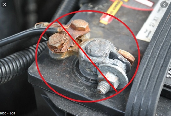

Batteries with post are just fine if you buy some new cables with the wire molded right into the clamps.
