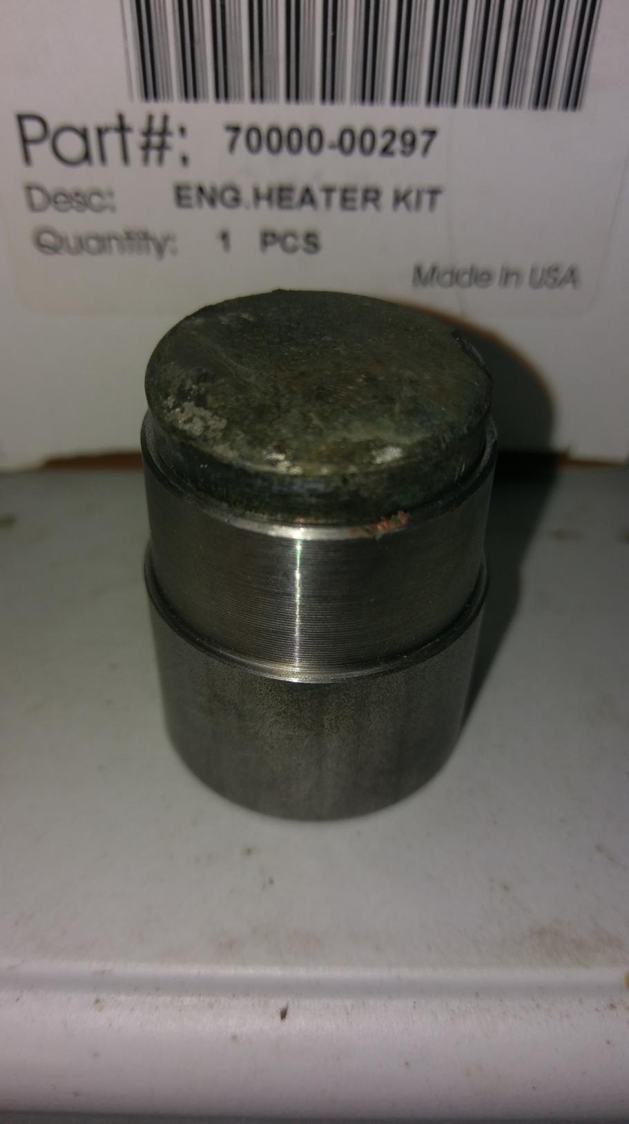

So I'm in a bit of a pickle... The sleeve included with that part number is larger that my freeze plug and freeze plug boss. Have a look at the picture.
What to do now?
Knocking the freeze plug out was super simple. Just tapped on it with a hammer and punch until it turned sideways, then grabbed it with needle nose pliers and it came out with minimal effort

Quick solution, measure freeze plug, add sealant, replace. Get onto supplier or others to see if they can check diameter in supplied kits. Any chance they didn't machine enough off, is there lots of meat left to machine down to size? Any other bigger plugs in engine?

I'm glad i didn't destroy the freeze plug during removal. I was able to re-install it using some black RTV to help seal it up. I used some sockets of the appropriate size to expand the freeze plug enough to wear i could tap it back into the block with a tight fit.
There is quite a bit of 'meat' on the sleeve of the block heater. I'd venture to say it is twice as thick as the freeze plug i removed. Tapping it into place, just is not going to happen the way it is. The shape of the sleeve being the opposite of the freeze plug doesn't allow the sleeve to deform like the freeze plug does when it gets compressed in. Or maybe it does and i just wasn't hitting it hard enough. I'd hate to crack or chip the block trying to install this thing.
I'm trying to devise a way to chuck it into my drill press and hold some sand paper (or flapper disk) next to it to shave it down some.
The frustration!
33,089
8,497
There seams to be a mix up with the bushing part, it's not the first time I've heard of this.
There are 2 bushings one is for the 30mm kit and the other is for the 32mm kit.
Measure the freeze plug size and the adapter size, just to make sure.
You should have 30 mm freeze plugs.
And I'm betting you have the 32mm adapter (it will probably measure 32mm somewhere about 1/2 way up the taper).
If you want to send it to me I will mill it down to the right size with the right taper on a lathe.
I also have a D950 block here that I can test fit it to.
Just send me a PM and I'll give you my address.
I'll also look tomorrow and see if I have a spare one hanging around that is already the right size.

I think the only mix up here, is the part #
The instructions say the 70000-00297 kit is for a 32mm freeze plug. Then it lists all the models that it fits.... (I will PM you)
33,089
8,497
I have been beating myself up and thinking I've lost my mind.
I know that I have bought the 70000-00297 for D750's and D950's, I installed one last year.
Well after digging in and doing some serious research, I think I found out the problem.
The company that was making the drive bushing quit making them.
Another company took over, and changed dimentions just a little.
Old adapters covered a range of 30mm to 32mm, so it worked on the 30mm and 32mm freeze plugs.
New adapters cover 32mm to 35mm freeze plugs so they will not work on the old engine 30mm freeze plug setup.
So as it stands right now there is no freeze plug kit that will directly do the D650, D750, D850, or D950
There is also a 70000-17552 that works for the 25mm frost plugs.
