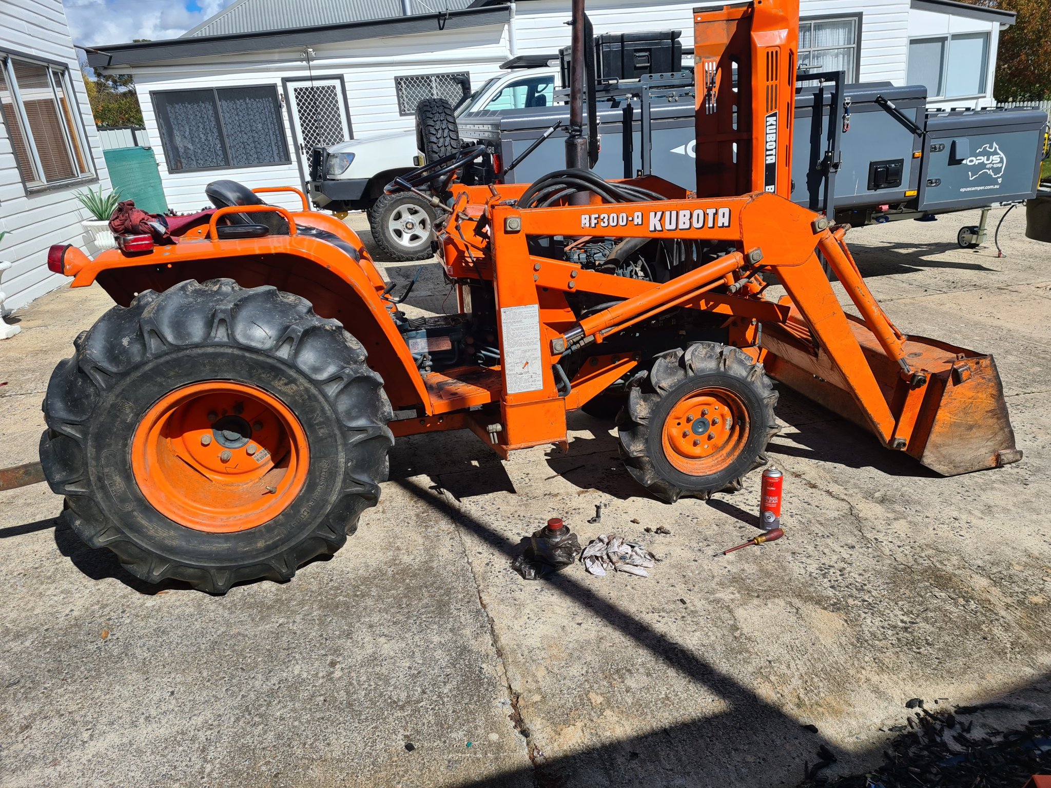

Hi everyone.
Thought I would use this.forum for more than memes and crazy dog stories.
Bit of background, we have bought 11ha (27a) to build a house and grow as much food as we can in the New England highlands in NSW Australia
As part of this we have a 1990 kubota b8200 4wd with a BF300-A front end loader, slasher and ripper.
Before we take it out to the property I'm giving it a once over. I'm sifting through the workshop manual but would appreciate feedback for things to check. I'm finding the layout of the manual a bit unusual, but that maybe just me.
So far I have done the
engine oil
oil filter
air filter
Front diff and hub oil.
New tacho cable
New battery terminals
Anderson plug to make charging easier when it sits too long.
Greased all the grease nipples I could find.
Next couple of days I'm going to
Change hydraulic oil
Clean hydraulic strainer
Clean fuel filter (forgot yesterday. 🤪)
Check/adjust valve clearances
Get a crack in the exhaust fixed.
Finish off the agricultural ROPS that came with it.
Thanks for reading this far.
Andrew
