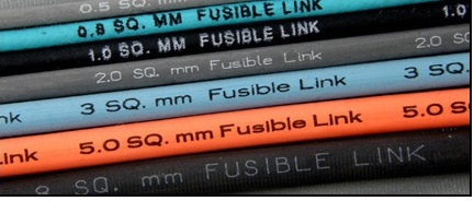

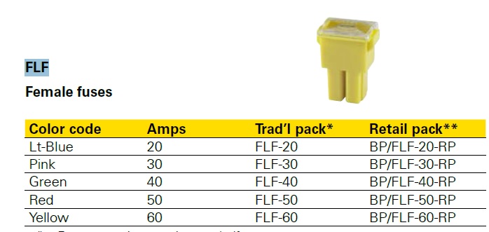

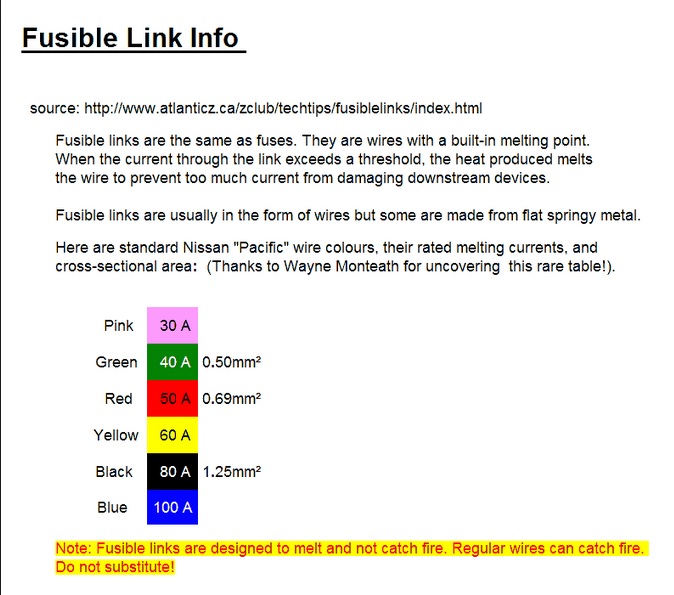

Incorrect, the owners manual clearly states a 200A fusible link.
Fusible links and slow blow fuses have a color code indicating their rated ampacity.
200 amp fusible link has to be an error.
In some manuals the cross sectional area of the link wire is shown and can be misleading.
Fusible link wire typically has the cross sectional wire area in square millimeters imprinted on the insulation
Dave

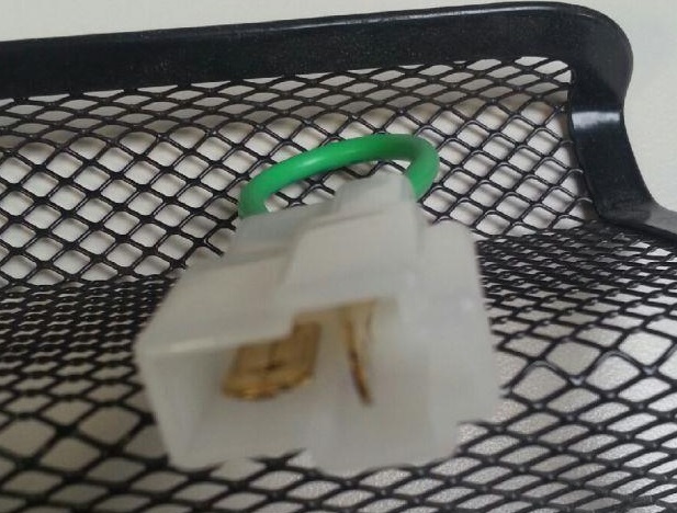

Could you please post photos of the pages from the manuals where the fusible link size is indicated.
The fusible link photo is from the Messicks web site listing for both B7200 and B8200 models.
The green link color denotes a 40 amp fusible link.
Dave
