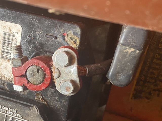

So I’m not seeing any wiring coming off the battery at all except the main positive and negative. I know when I bought it from the guy he kept it on a battery charger. So does the regulator connect to the battery? Basically dynamo, regulator, battery? Does it hurt anything to just keep the battery manually charged like he was doing?

There will not be any obvious connection to the battery from the regulator. The regulator is more directly connected to the alternator.
I would definitely recommend that you replace the positive cable since that in there can cause more trouble than it helps.
Your replacement end on the positive battery cable is a solution to be avoided.
A new positve cable is needed. Also replace the negative cable if it has the same battery end for its cable.
The charging connection to the battery will from the regulator to the battery cable terminal on the starter solenoid. A fusible link or slow blow fuse will be located there as well.
Failing to fix the charging system is short sighted,. A cheap charger can over charge the battery leading to a shorter life and failure

Ok. So replace the negative and positive cable and start troubleshooting from there?

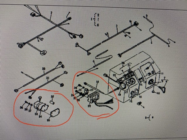

There are 2 regulators showing. A H1550-64600 and also a 70000-65398. Can anyone explain this?
If there are two shown there is probably a serial number break. In other words below a serial number they used part A, above a serial number they used part B.
There will be some indication of the serial numbers beside the part numbers

I don’t think that is the case. I think it is 2 separate regulators with different purposes. They are both on the diagram.

If I were you, I'd purchase a new battery terminal and take that cable loose and tin it with rosin core solder to make it solid (you may have to cut off the oxidized end to expose new copper strands.) You have a resistance connection with the oxidized stranded cable as it stands in the picture. Do the same with the negative cable if it's in that condition as well.
It only uses one or the other, your tractor does not have two regulators. Look at yours and see whether it has a plug with six wires in it or if each wire plugs in separately to determine the correct one.
Yes, you can get aftermarket battery cables and replace yours. It is foolish to try cobbling old battery cables that probably have too high of resistance any way.
The regulator with the aluminum fins is for a dynamo based charging system,.
The other style regulator, looks like a black box, is for the tractor equipped with the optional alternator.
The regulator is a mechanical style thing with contact points and coils. Not particularly reliable.
