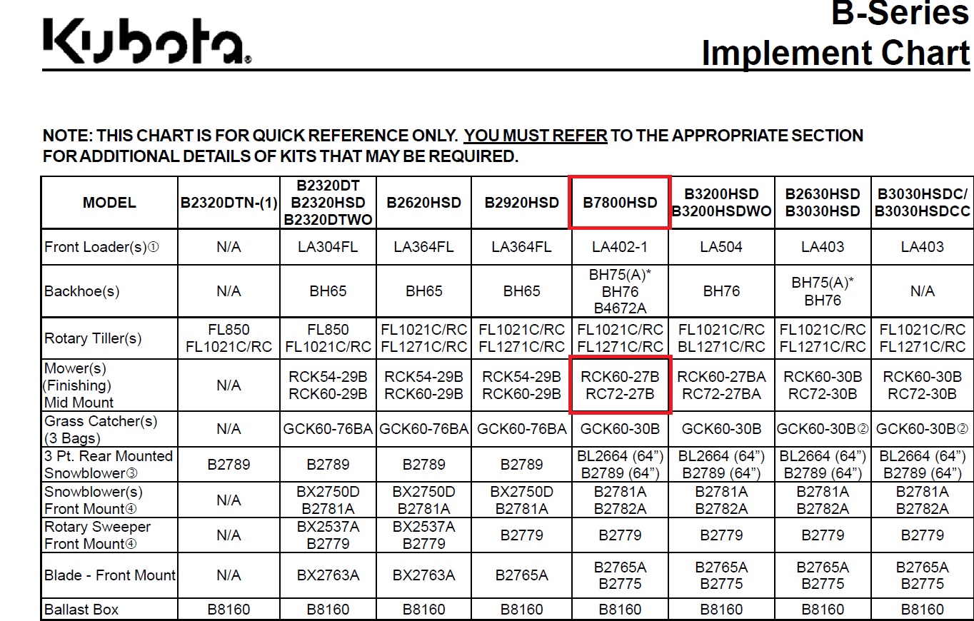

I have attached page from B series while goods which shows two mowers fitting B7800.
5 foot and 6 foot models.
In reality this tractor was last made in 2008. Most decks of that age would have significant rust.
Check with forum member 007kubotaguy who is often parting out older machines.
Use envelope symbol at top right corner of most pages to reach him.
Consider a pull behind mower driven from rear pto.
Grooming mower
Because these mowers are not limited to a specific tractor model you will have a much better used selection
Grooming mower
