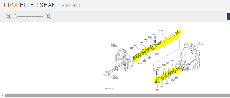

It comes out with sleeves and pins as described by whitetiger. Attached screenshot from WSM for your brother b2910

This is the shaft they are talking about.
You are pointing to a completely different shaft that runs the Front axle on a completely different tractor. ;)
You are pointing to a completely different shaft that runs the Front axle on a completely different tractor. View attachment 117242 ;)
Glad I could help LOL. The B7800 and the B2910 are mechanically the same machine with all the same part numbers.
