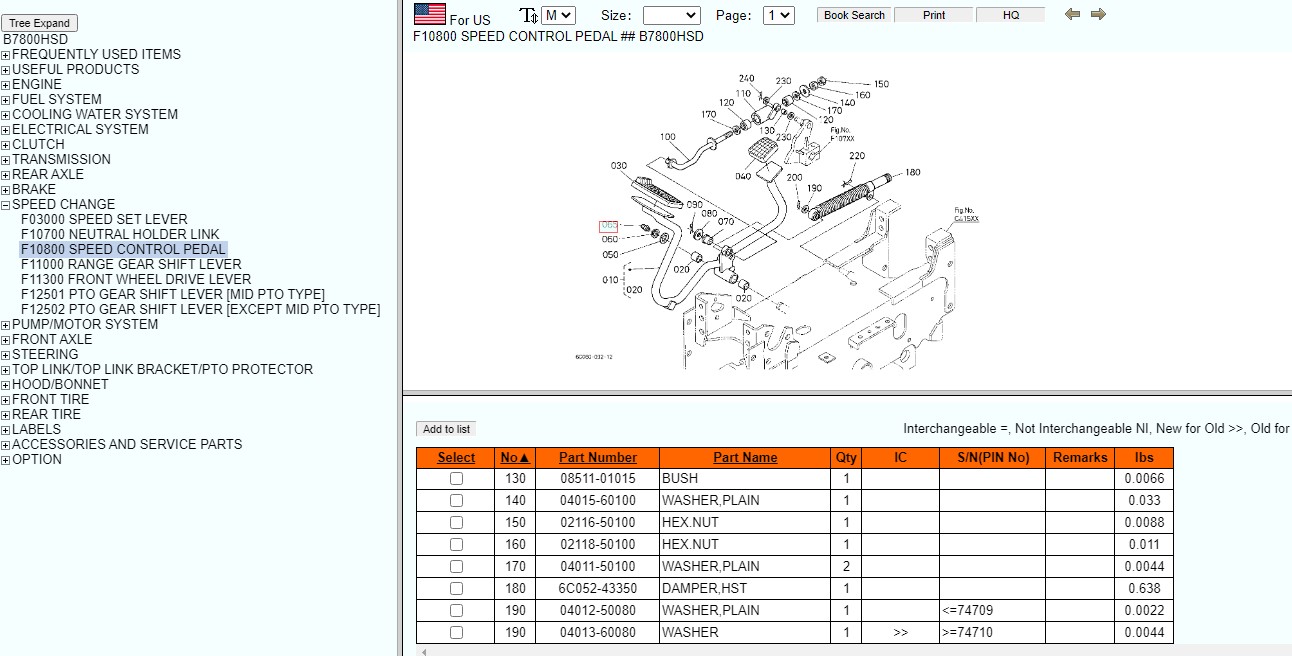

You feel the clunk in the pedal? Sounds like a linkage thing.
First thing I'd check is the damper in the linkage. They cause some things like non-centering Speed Control (causes stalls) and other wonky stuff.
Here's a diagram of your tractor's linkage - - - damper is 180. Work the pedal or pull it off and make sure it's free in it's working. Kind of like a shock absorber on a car.
Other thought is something's gotten bent and causing a bind....

Disconnected damper... makes no difference.

Damper removed and all linkage removed. The only linkage still connected is the rod that goes through the frame to the transmission or final drive. Parts all over the shop and the yard because you can't take anything apart without taking the other thing apart… Symptoms have not changed. I guess that means it's probably in the transmission? If so want to buy a tractor in a Box? I can't possibly see how to get to the transmission. It's all inside the frame.

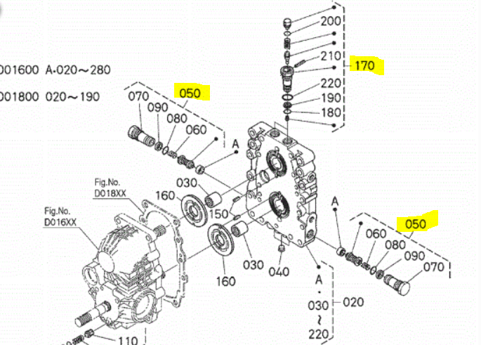

If the lever and shaft that extend from the side of the HST unit are tight and moving fully when the pedal is pressed in both directions then Its is likely inside the HST. It may be difficult to see but you need to verify the shaft is turning as this is what moves the swashplate inside the HST.
If all is OK there I would suspect issues in the relief or charge check valves referenced below as item 050. You can remove them, inspect for damage/contamination and reinstall them in the opposite port to see if the problem migrates to the other direction. You van also check the neutral valves items 170 (there 2 even though one is shown. Do the same, inspect and swap to see if the issue moves. I would do one set of valves at a time so you know which one makes a difference if they solve the issue.
If you find any damaged o-rings this is one area where I would not trust getting generic ones at a local hardware or auto parts store.
