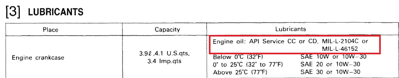

You always want to be using a diesel engine specific motor oil. It will contain certain additives that gasoline motor oils will not.
Look at the spec's for a B8200 and note the API service classifications CC, or CD.
API stands for American Petroleum Institute and the CC stands for combustion compression which is a diesel. I don't recall the CD but it is for a diesel too.
In addition to the correct weight of oil you need to get the correct API designation.
Another factor now having to be considered: The low sulfur diesel fuels make life easier on lubricants
