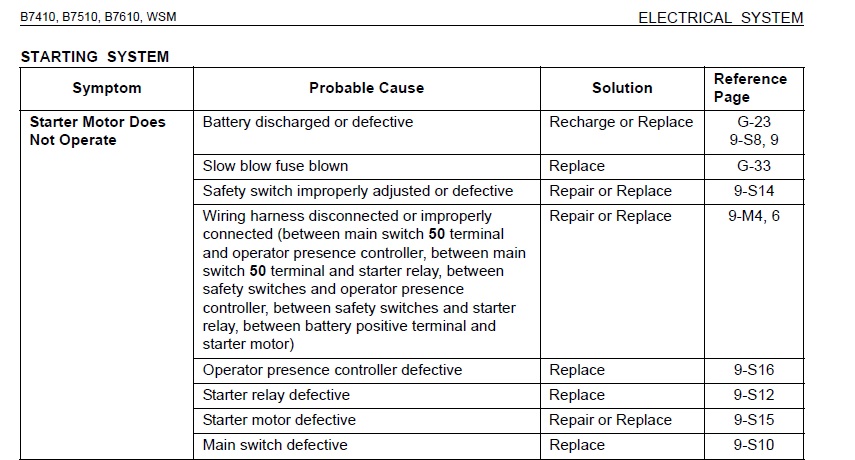

Here is some info from the shop manual (WSM)
Check and see if the starter relay on the back of the dash is being triggered when the key is turned to start.
A bit of history on the arrival of this problem might help.
Dave

Thanks Dave, I did not realize there were so many safety switches. I have by passed all of them except for the Mid PTO and the one on the front of the clutch pedal. I did check the starter relay. It clicks when I turn the key to the on position but does nothing when I turn it to the start position. I am not sure if it should click a second time when I go to the start position or not. Is there a way to test it if I pull it out? There are four terminals on the relay.
