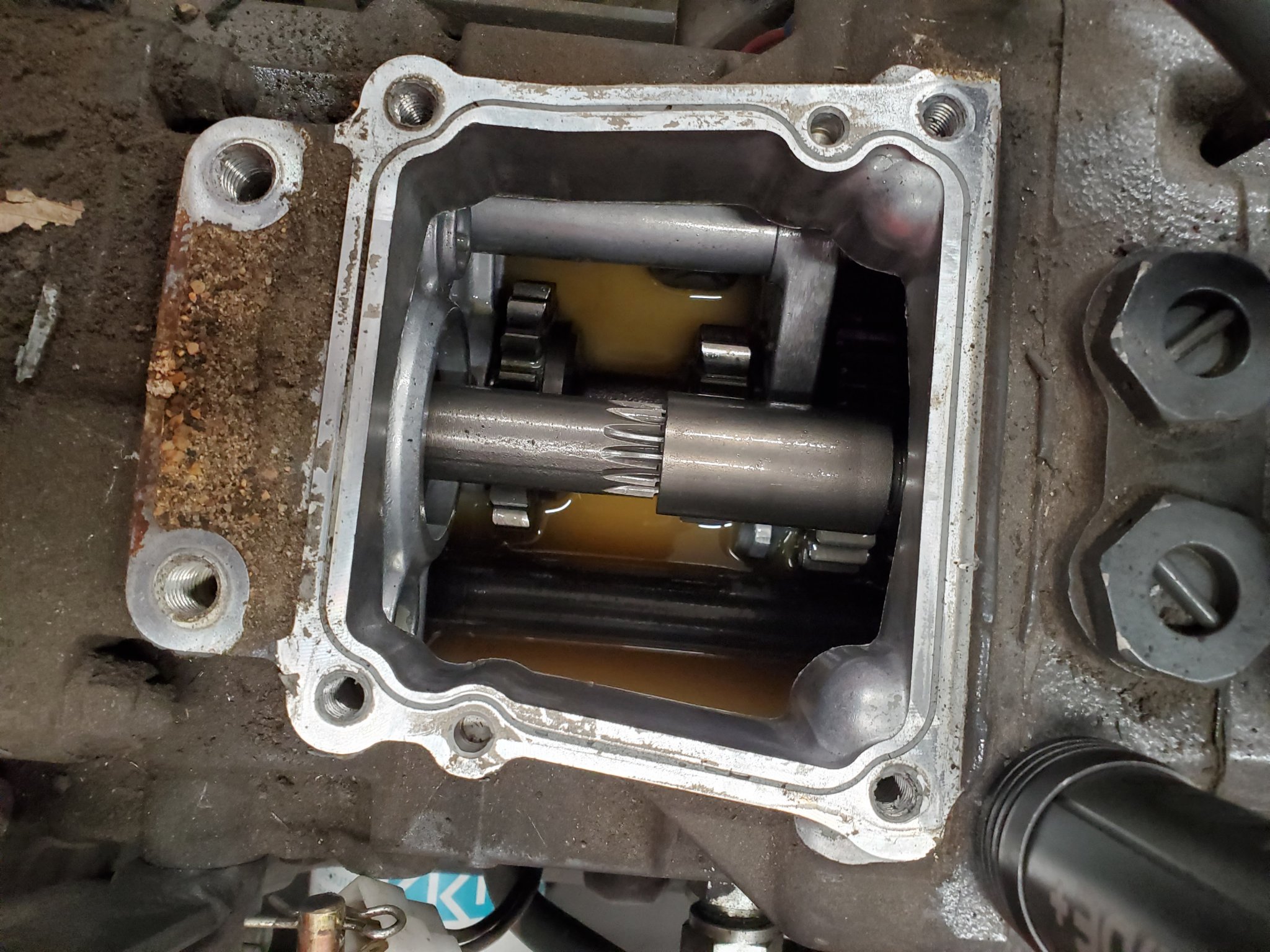

Thanks for your reply, I think everything you talked about I have done, including take the cover of the inspection port. I am confused, I am sure it was working when I bought this unit. I moved it into my shop, it was not running but I got it into neutral to move it around.

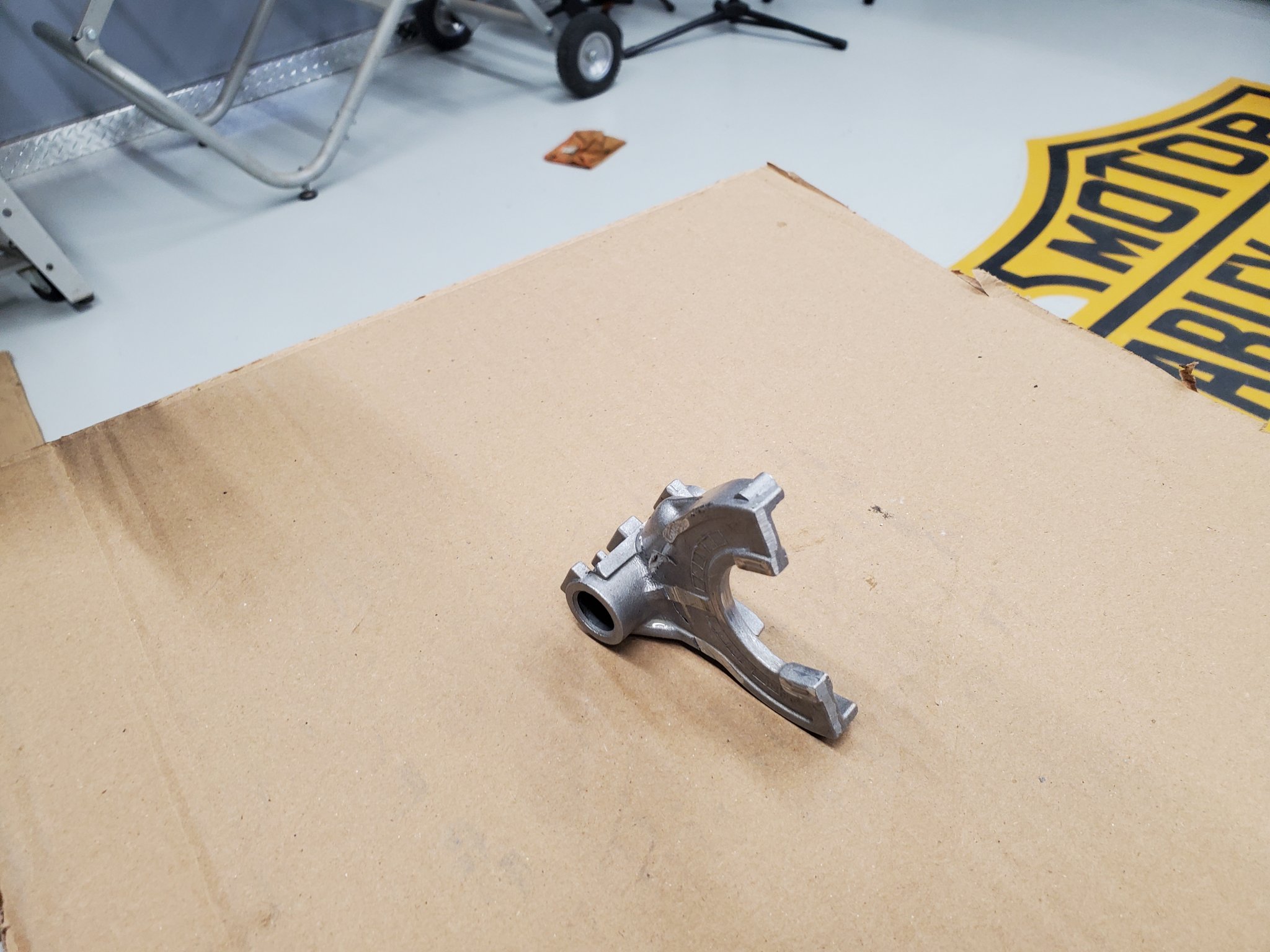

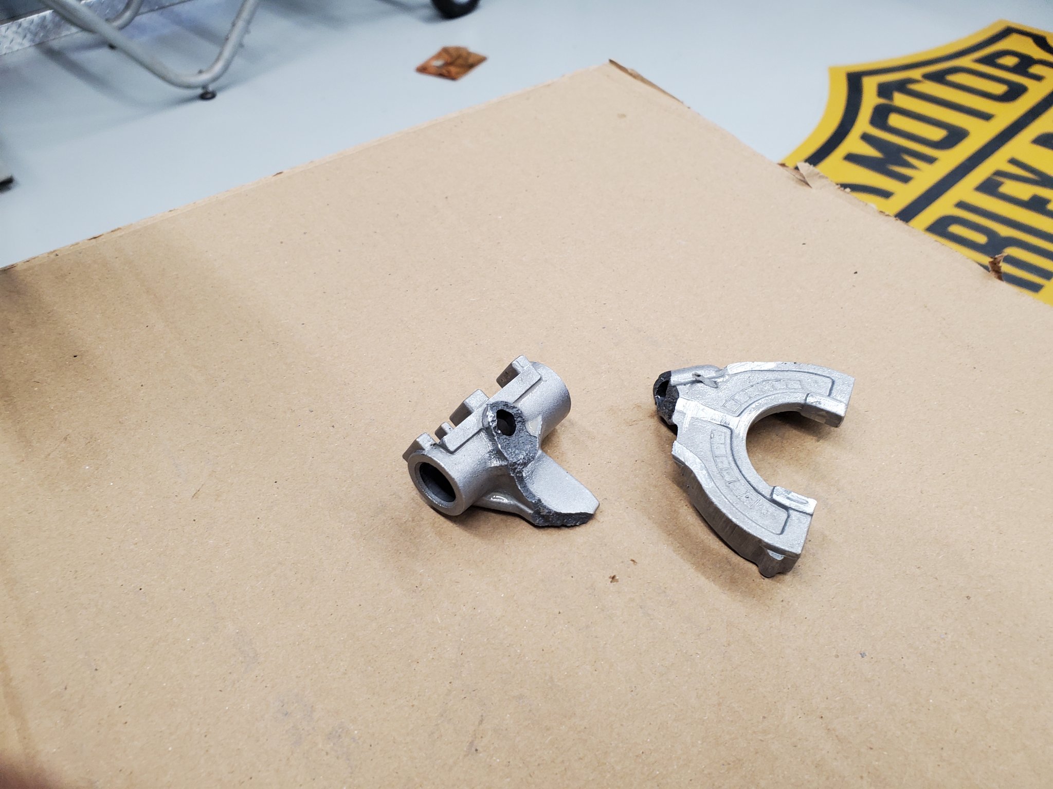

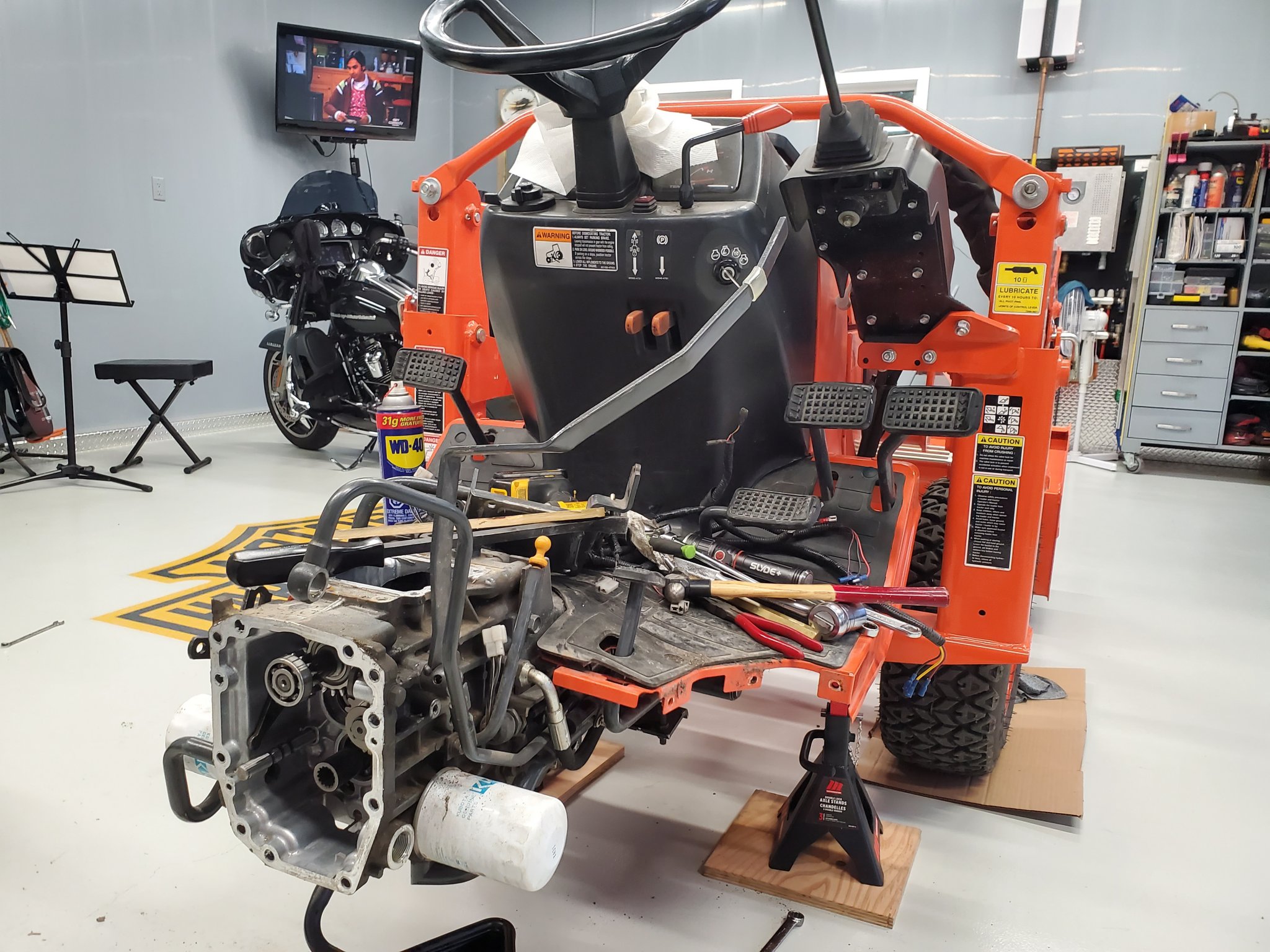

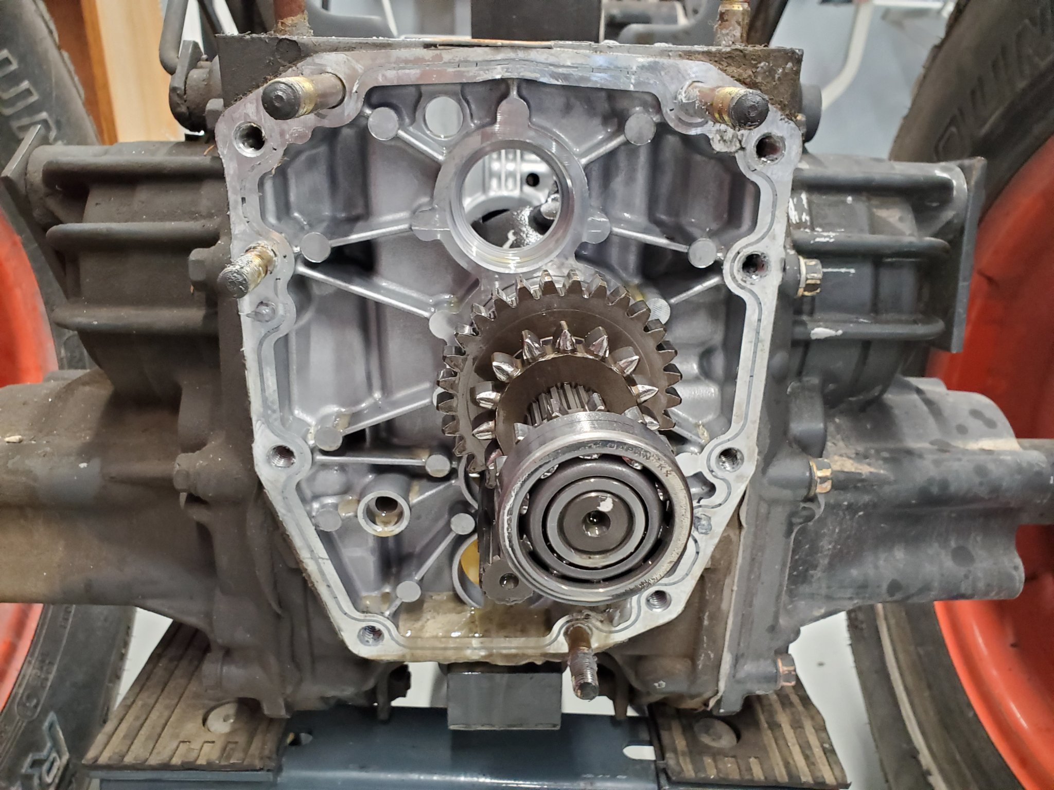

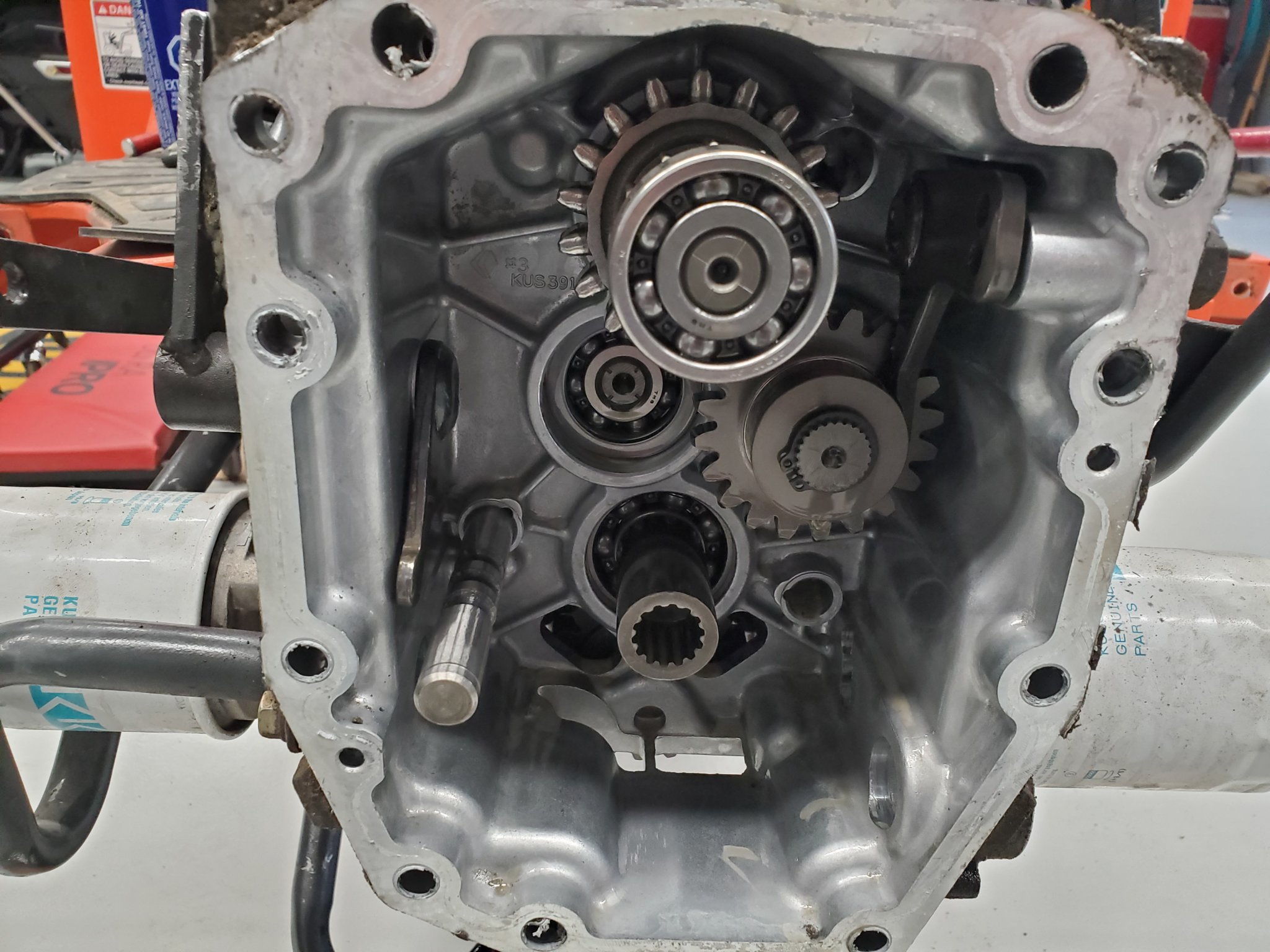

I tried about everything I could without splitting the tractor, but in the end did split the unit. it is not that hard to do but messy and very time consuming. In the end I have found the shift fork was broke, and replaced it along with spring and ball. It now works like new. see photos.

Great to read a success report!
AND boy does your workspace beat my dirt floor in the shed!!!

Good work. What’s on yer walls? I like it.
