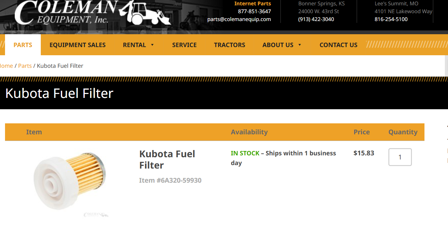

In most cases, the Kubota filter is the same price as a good competitor...
Use a high quality filter if you use a competitor oil filter, NAPA Gold, Wix Black can, Fram Ultra, etc
Baldwin B1431 is a 4 inch long version of Kubota HH150-32094...
