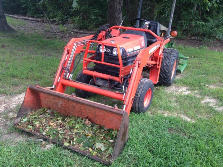

Alan - Your tractor and all the stuff you have done with it is really cool. I have been through your threads in fabricating and very impressive. I basically couldn't afford to buy even a good used so I got this as a parts tractor and have been going through it. Mostly it's been little stupid things that needed done - glow plugs wiring, brakes and clutch adjust and some new rods with that, fuel filter, air filter, all fluids, rear wheels were floating loose and pinned with barn nails (really!), some hydro lines on the loader and etc. The hood was squashed and missing the front grill and headlight plastics were destroyed when I got it. It didn't have a brush guard. Pic of how it is now, still more stuff to do but at 1700 hours and runs great, I am just going to use the heck out of it.

Wow your tractor looks great in the pictures.
