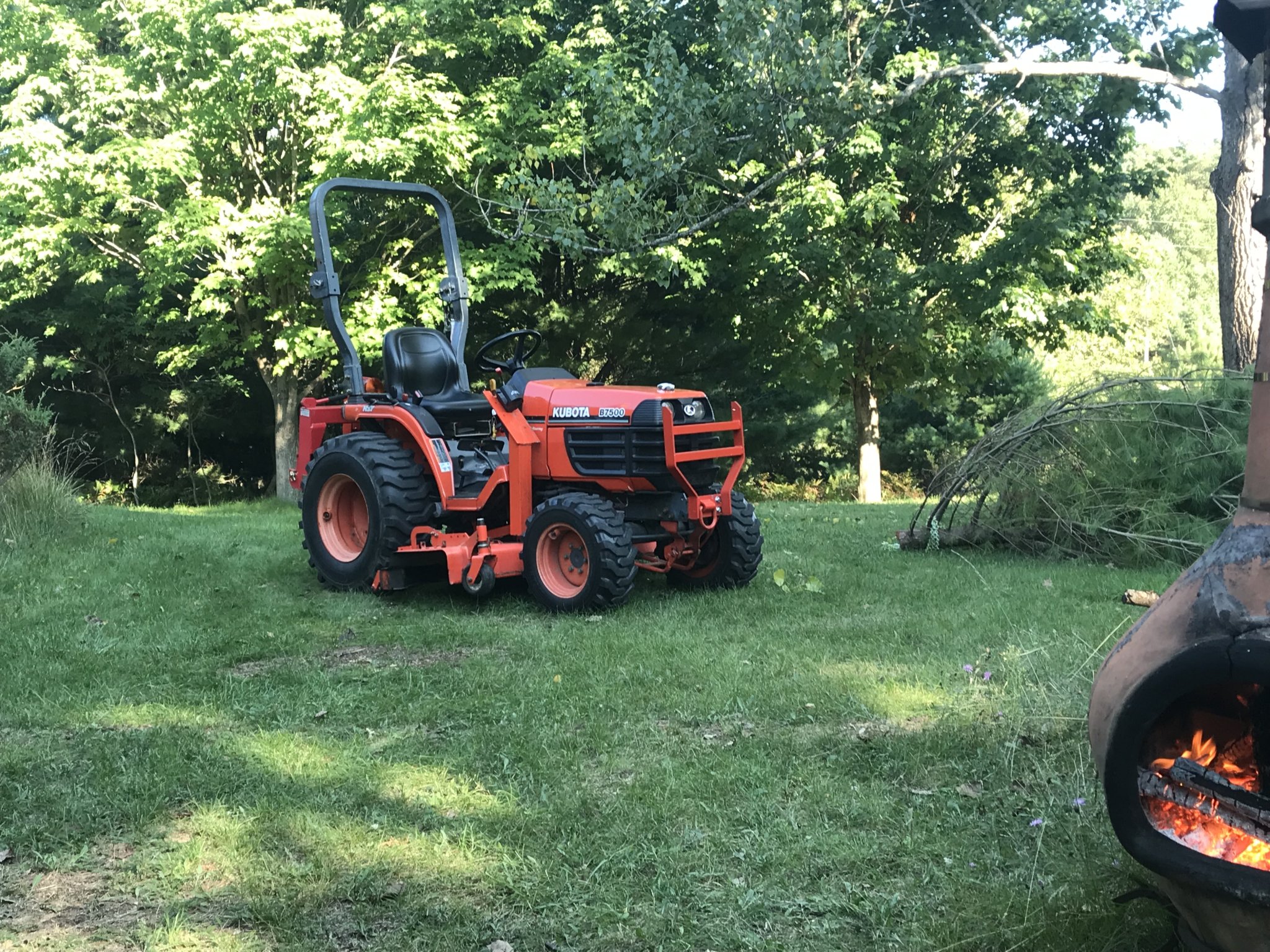

So, the tractor runs great. I think I’ve have had it three years. I think it is close to 1000 hours on it.
I believe it was well cared for when I bought it
belly mower and rake all summer, back, back blade to plow snow.
Before this gremlin, in high range mowing, run it 1500 rpm push the forward pedal down it goes.
it would mow at a decent cruising speed. No groans, no grinds.
i was moving stuff around with the carry all because spring happens.
Engaged the belly mower. Check! I remember hitting the zerks in the fall.
i put it in high range. And it kind of ran okay, but as pushed the pedal for more speed it acted like I was putting on the brake. The engine runs fine, adding fuel for the load evidenced by black smoke and grunt.
When I bought it I had the local deal replace the hydraulic fluid and filters, maybe 100 hrs ago.
Anything come to mind?
Clogged hydraulic filter and when it exceeds the flow capabilities it hydrolocks the positive displacement pump?
Does anyone think it would damage anything to mow in low range until I figure it out?

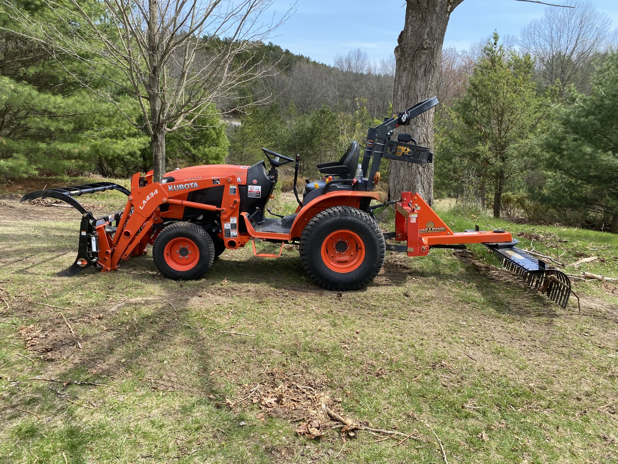

As I get old thing slip by me.
I am pretty decent at turning wrenches. I have six cars, a pretty cherry 1999 Dodge Ram Cummins, a 1984 Scarab off shore boat, two Kubota. And original factory shop manuals for everything.
I retired from the fire department with thirty years of service, twenty as an engineer. Back in the day when we worked on the pumps and firefighters rode on the tailboard.
And currently, I love my B2601.
I have put more hours on it in a year than the previous owner did in seven.
I found the problem with the B7500.
I left the parking brake on
Flame away, I deserve it.

I cant believe nobody suggested that, as often as it happens. Sure glad mine has a dash light.
