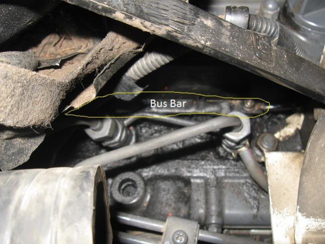

What you call the bus, kubota call the "glow plug cord". It is held onto the glow plugs by a nut. Typically, that nut has a slot across one side. You can insert at flat-blade screwdriver into the slot to remove the nut. Then the connecting "bus" can be removed. You can then use your meter to test each glow plug.

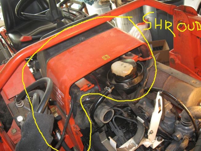

Hi - What I will refer to as a shroud is the metal that connects to the dashboard/instrument panel. I have attached pictures. The gas tank and some firewall/protective plastic stuff is in the way of the second and third GP. I have pretty dainty hands and I have wrenched on a lot of Japanese imports, so I am not averse to tight spaces. I can barely get a finger to even touch the GP that's under all that. I need to remove the shroud. The bus bar I refer to is the metal bus bar that connects all three GP's. I will figure out how to get this apart then I will properly test them.
Pat, that's a mighty fine looking...um....tractor. :)

Ah, fuel tank and cowl removal will make it more better to get to.;)
The seat cover is optional, a very high priced option!

So I was able to get to the glow plugs. I ended up learning a whole lot about all the stuff between the steering wheel and the back of the engine, then just cut the insulation stuff out that was in my way and now I can get to what I needed.
I pulled the bussbar off the GP'S and it had some oil on it, not super tight but the bus was clean and shiny. I don't think any potential issues.
I was then able to test the GP's for resistance, all came in at 1.2 or 1.3 OHM with my leads zeroing at .2. So all at about 1 ohm. GOOD.
