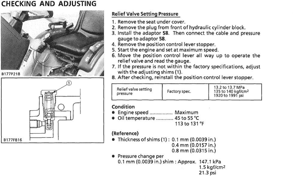

forgive my ignorance... but I've looked all over and can't seem find the relief valve.
I bought a pressure test kit, shims, and now need to locate the appropriate relief valve.
The tractor has 850 hours and I'm guessing has never been tested and reset.

I appreciate the advice, but I think you missed the point of the post. I know how to check the pressure. I'm asking about being able to adjust it if it does indeed need to be adjusted.
I have this from a service manual, but it doesn't actually explain WHERE the relief valve is physically located.

Check the flow divider
