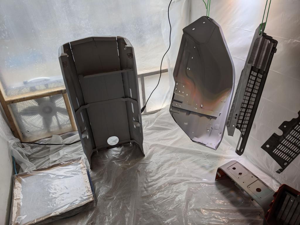

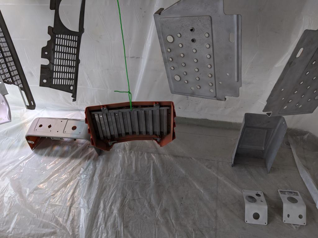

Here's what we got so far- "paint booth" (enclosed trailer) set up. All pieces blasted, Bondo'd and primed.
Only issues were the 2 bad gallons of primer off the shelf, and my paint booth had an unforeseen failure right at the end - just my F'ing luck! I live in America's jet turbine, I swear. Wind pushed my 2x4 (screwed in) wall back like a kite and tore down the plastic. Let's just say a few parts now need sanding :mad: Gonna make some improvements (more screw's/anchors) and hopefully re-finish primer today.

Too fancy for me. I did the tin on my used M9 in the side yard on a calm day. I did have the complete Bonnet and side panels done in a local body shop however. The top had a nice dent in it from the previous owner and I wanted it 'bumped out', no body filler, just glazing compound and I wanted the topcoat to be as good as possible seeing as I look down it all the time. They charged me 200 bucks for that. I provided the top coat and primer so everything matched.
I used Rustoleum Kubota Orange (Orange 2) in rattle cans and in quarts (for the bonnet and wheels) and my trusty HF spray gun.
All the underpinnings and chassis I did with the rattle can ROPS grey after a couple good pressure washings using ZEP purple HD degreaser.
Like I stated previously, Rustoleum Kubota Orange is Orange 2 and Majic Kubota Orange is Orange 1. I heard (on here) that Rustoleum Grey is a close match to ROPS grey but the ROPS grey at my dealer isn't that expensive and covers well so I used that.
Hardest part was removing all the tin including the seat pan and inner fenders. I replaced all the rubber grommets with new ones and I replaced the Kubota vinyl seat and suspension with a Grammer style velour seat and new suspension from K&M seating. New floor mat and pedal covers as well.
It was a job but well worth the effort.

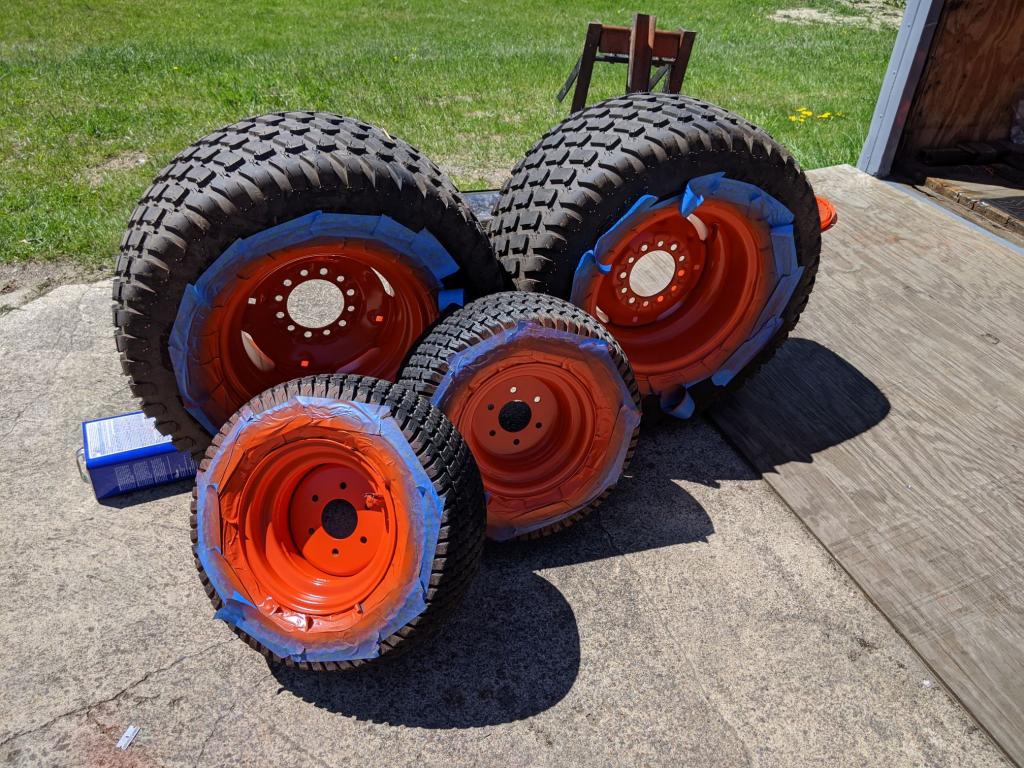

Hey guys, got some updated pictures. I'm loving the color but the paint is super super soft. It feels dry to the touch, but comes up easily if you scrap it with something solid. Kinda nervous/irritated but I had to get the parts on the tractor today to get it out of the rain coming tomorrow. A lot of small areas I easily/accidentally scraped down to the primer. Is this just a lack of curing time? I let primer dry for 2 days due to colder weather, I didn't sand the primer as it didn't seem necessary.. thanks everyone.
That's pretty much a Rustoleum trademark... it's a giant PITA when waiting for their product to dry, even if you use the matching hardener. I used the TSC rattle cans with the same result. 2 to 3 weeks of drying and it just gets to the point of no longer leaving permanent fingerprints. I only buy Krylon / Duplicolor rattle cans now for this reason. I use the Rustoleum industrial enamel on my shop lifts and trim. I only paint before going on vacation or over the holidays for cure time.
Well I guess that's relieving to hear. I guess I'll just have to baby the paint until it cures on the inside. Never seen paint do that before. A couple spots wrinkled from me applying to much pressure on them. I'll just touch up the bad spots later. Just maddening after I spent over a week blasting, sanding, applying Bondo, then two coats of primer/topcoat. Damn near perfect until I started installing parts...
What's weird was the paint was dry to the touch and I could handle all the parts. Then when something rubbed on the paint.. all over.

I see you masked your wheels like I did. If you ever do that again, run the taper carefully along the edge of the rim using your fingernail to secure it. Much easier than trying to get it to lay against the tire. You only need a couple longer pieces of tape that way.
