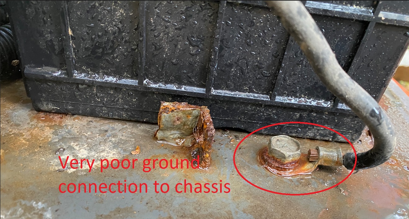

Often this is what the frame end of the ground cable looks like when someone is having starter issues.
The connection is tight by useless!
If your cables have these repair ends time to bye new cables.

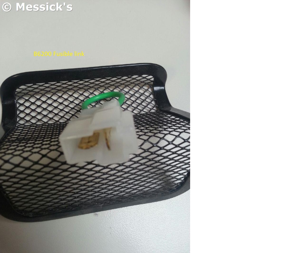

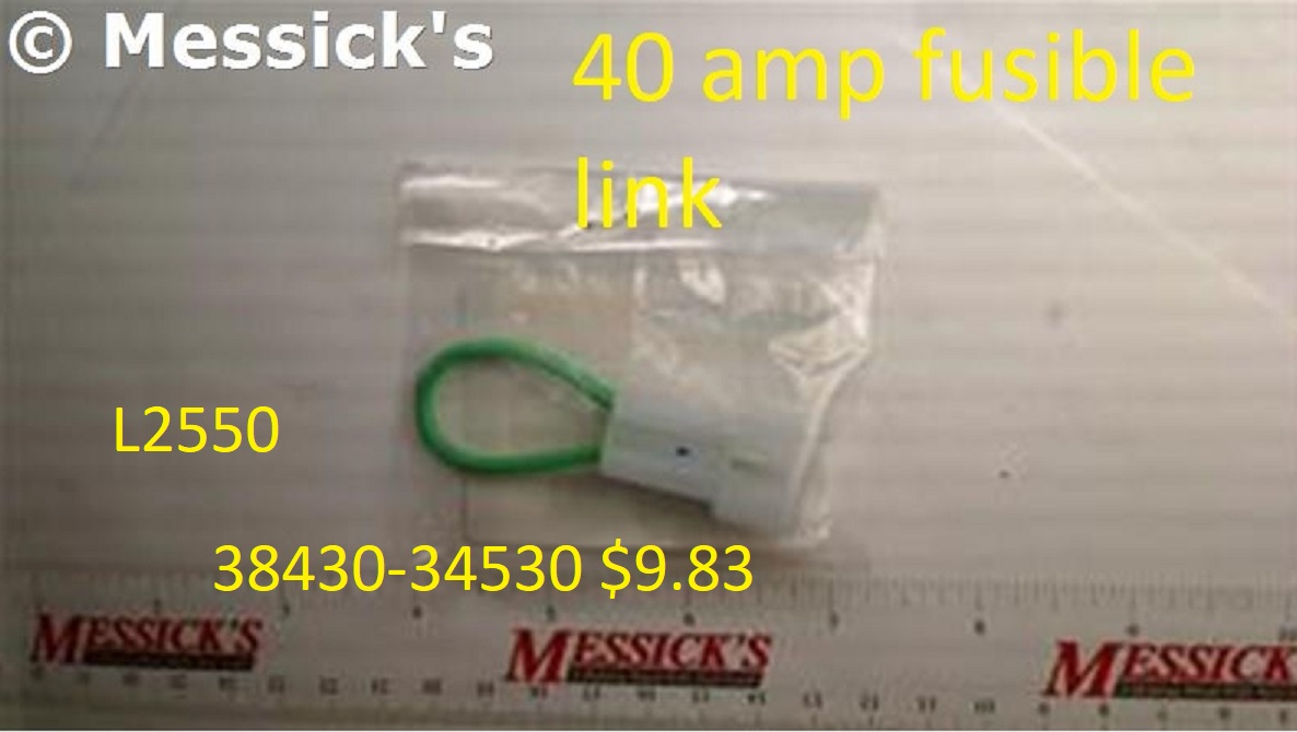

Are you certain your model has a fusible link? Some wiring diagrams for B6200 dont show one others do.
The fusible link will have a white plastic connector and a small loop of green wire.

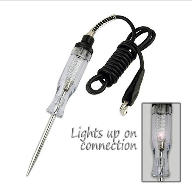

If you don't have or know how to use a multimeter, get a 12 volt test light. It is a great tool for trouble shooting and easy.
Attach the alligator clip to battery of any ground. Touch the tip to the small terminal on the starter and at the same time turn key to Start. If it test light lights that would be good to know but if it does not, then you need to try jumping the starter.
Please advise if you can find a fusible link. The 12 volt test light would make checking if the link has blown easy.

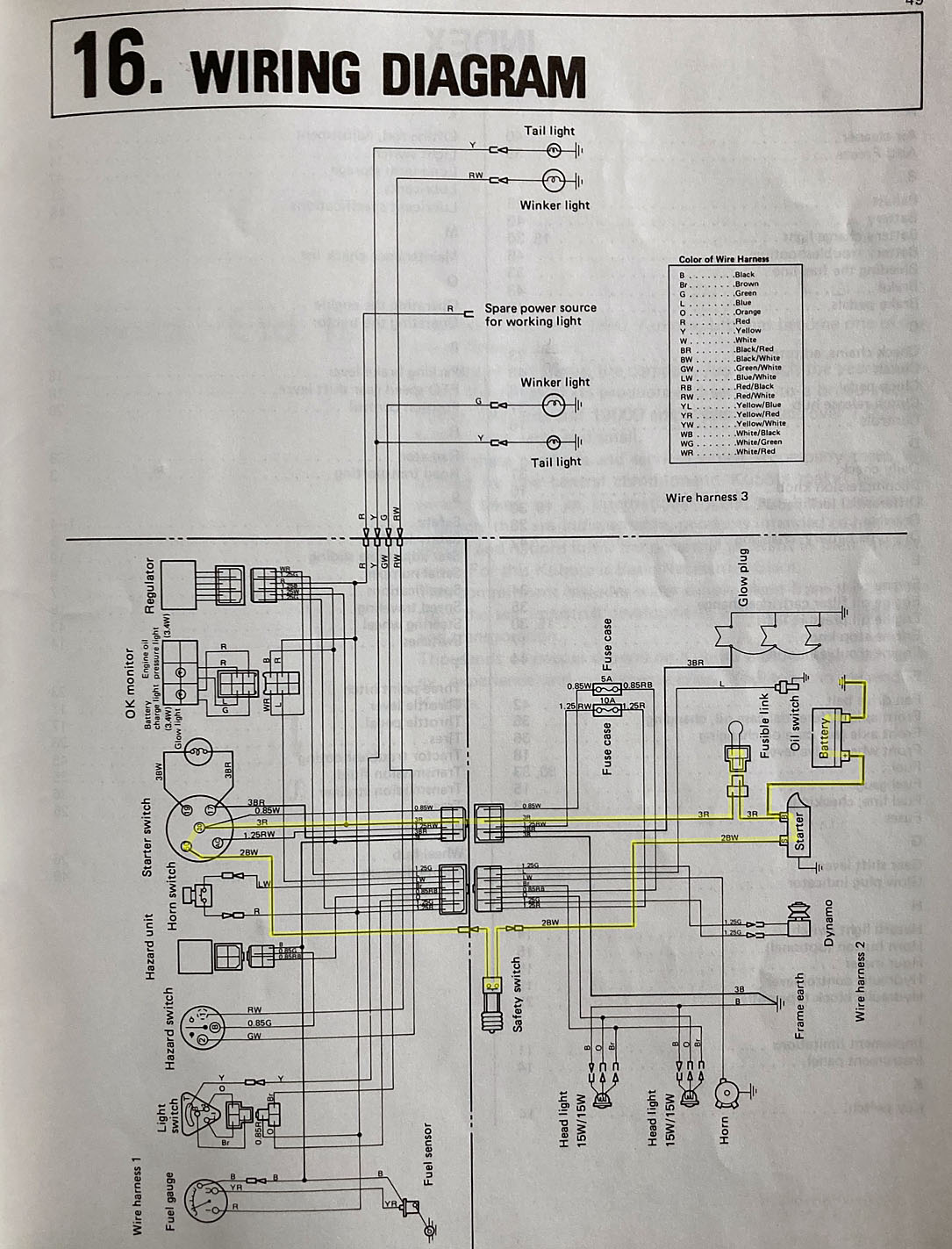

Hopefully someone can post a REAL wiring diagram, here and in the new electrical section as trying to troubleshoot electrical gremlins with the WRONG diagram will be very,very frustrating !
N3BP
Sep 20, 2016
504
236
Lebanon, PA
B7200D wiring diagram attached with starting circuit highlighted in yellow....
