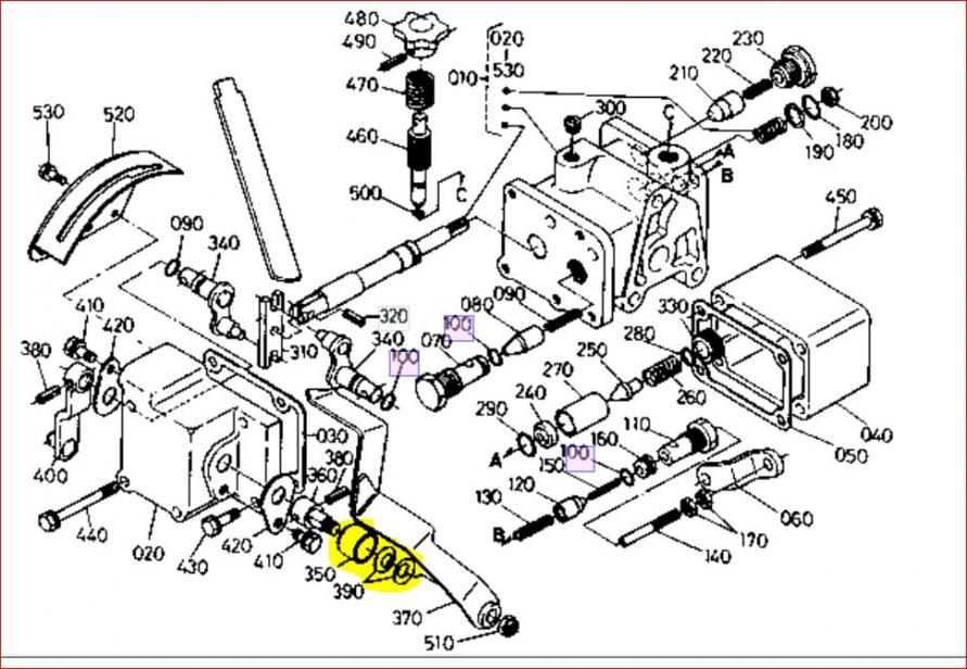

1) The 3pt hitch: It works great. Up, down, etc. I've found the valve that adjusts the speed that the hitch lowers at (which does help because it was barely lowering to begin with). The hitch raises just fine (almost too fast actually), but its lowers on its own and you have to hold the lever up. That is, unless you "lock" the lever in the fully raised position (which constantly makes the arms lift even if they are already raised- why would you want this?) So here's my real question- the lever/valve on the right of the seat which control the height seems loose, and the handle "falls" to the low position if you don't hold it. Is this a symptom of the hitch lowering, or is the handle lowering causing the hitch to lower? Is there a way to tighten this up? Also, if you raise the hitch quickly the pump almost makes a grinding noise- whats that all about? I'm sure its not good and I'm unsure if its unrelated. The hydrostatic runs great- no noises no issues that I've noticed.

The lever flopping around is not good and could be the whole cause of your issues.
Check that the nut is tight on the lever and maybe needs the 2 spring washers and collar replaced.

I had the same problem with my b7200 when I bought it. I bent the lever to one side to give it some resistance against the slot it rides in and it stayed in place for awhile, but that was a temporary fix. I finally replaced the collar and washers as Wolfman suggested and it's worked great since.
