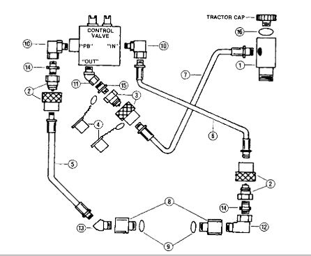

Yep there is the problem, you need to change the lines and add one line.
You need power in to be on the in you need PB hooked to the line that's on the out now and the out line should go to the tank.
This is how your loader should be hooked up exactly:
