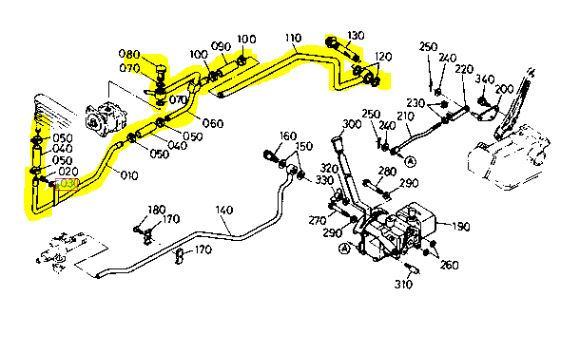

No the leak on the cylinder will not induce air, But a leak on the suction line will.
Look at all the suction lines (in yellow) for wet spots, or seeping leaks.
