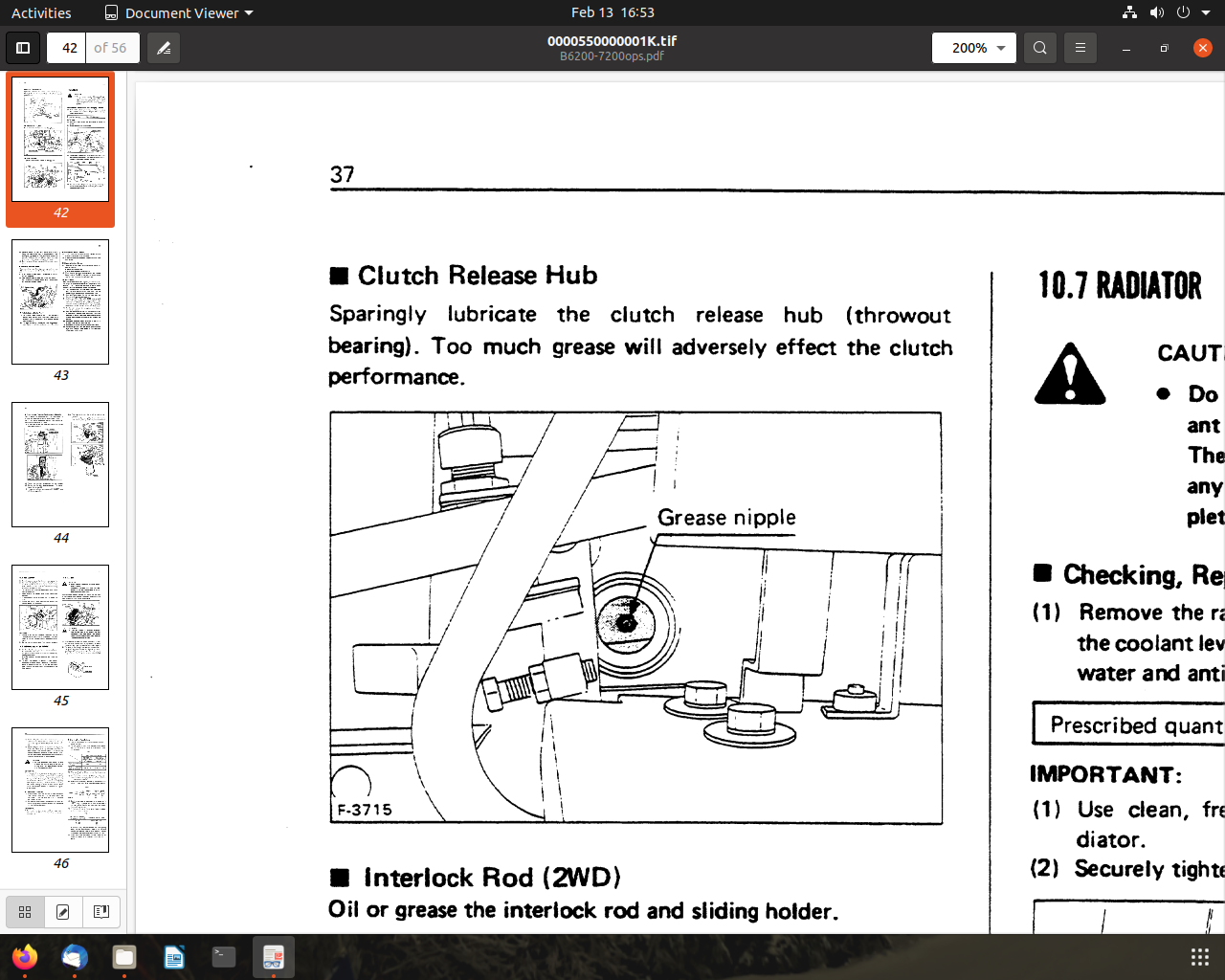

T twomany Active member Equipment B7200 Jul 10, 2017 793 138 43 Vermont Feb 13, 2022 #1 Question, Where does the grease actually go? INTO the throw out bearing races? ONTO the sleeve or splined transmission shaft?
North Idaho Wolfman Moderator Staff member Lifetime Member Equipment L3450DT-GST, Woods FEL, B7100 HSD, FEL, 60" SB, 743 Bobcat with V2203, and more Jun 9, 2013 33,385 8,699 113 Sandpoint, ID Feb 13, 2022 #2 Between the bearing holder sleeve and the propeller shaft. One pump is good for several years of service, if not more, if your not using it in a real wet location. Reactions: 1 user
