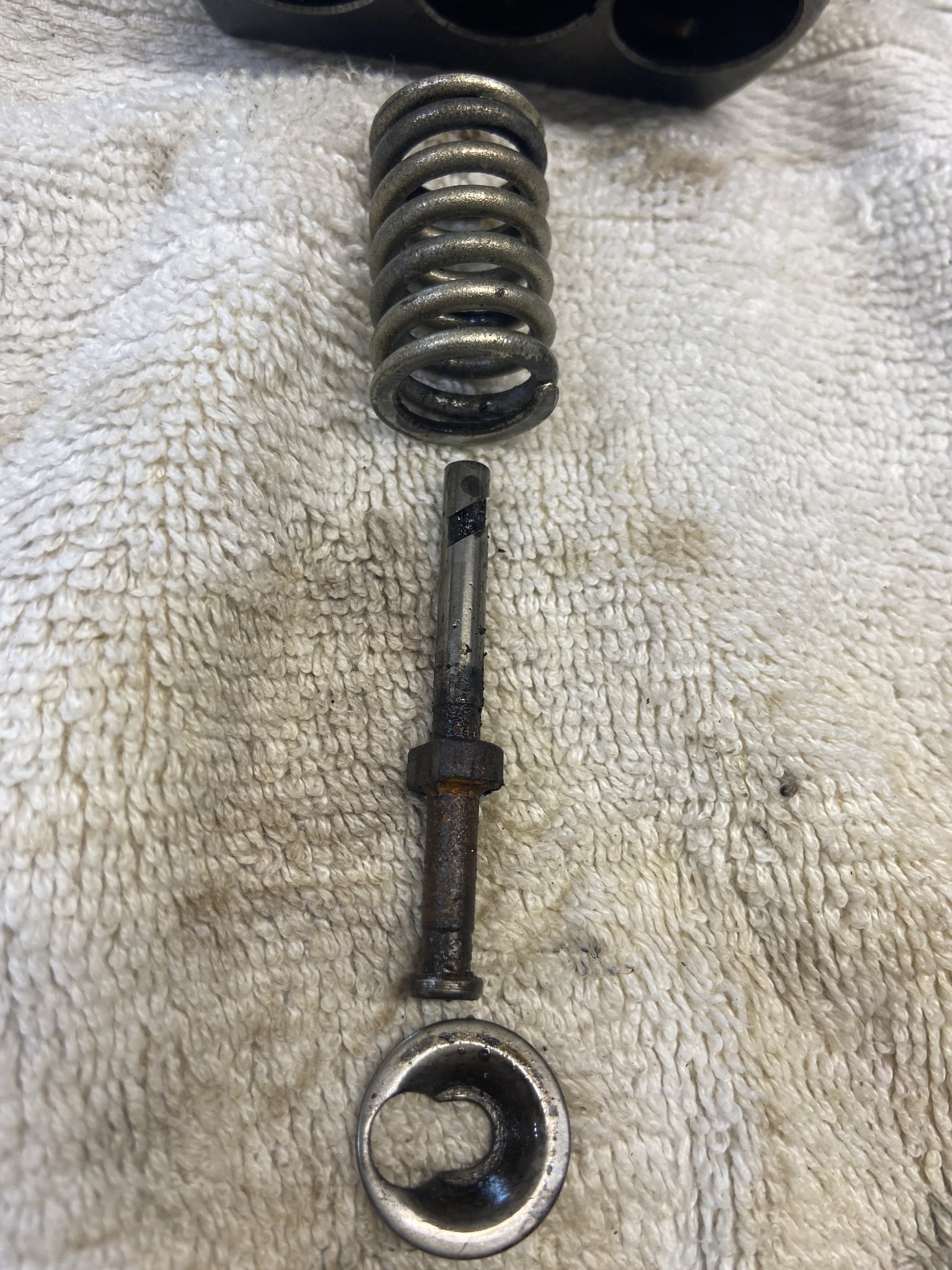

Absolutely zero fuel is discharging from the rear most two injection pump delivery valves. The forward-most valve just kinda bubbles out.

I removed the pump body this evening. I found the two dry delivery valve tappets were seized up into the body. I used PB Blaster and wiggled the bottom tappets for about 10 minutes each. They now move up and down. And I believe the control rack is supposed to slide front/back freely too. Mine is stuck, luckily exactly at the engine block notch-out.
My theory is the previous owner didn’t change fuel filters often. It was working when I purchased it. My fountain test yielded less than an inch of spray, so it wasn’t very efficient. I drained all fluids when the pressure plate exploded. That was a while ago and given the high humidity here in Florida, I think the injection pump internals started to “rust” together. I will soon find out after I free the control rack. Fingers crossed 🤞

Well it’s definitely corroded inside the injection pump body, just enough to stick two delivery valves and the control rack. I got everything apart without damages and they are going into my sonic parts cleaner. Might need input on how to orient plungers/delivery valves vs the control rack position. But that will be a new thread…

Thank you for the reply. I found some great videos and the pump is working now. It wasn’t very difficult getting it to function.

$850 is for a rebuild with calibration, kinda worst case $$. I stopped the leaking by cleaning the parts in my ultrasonic cleaner and installing new gaskets and o rings. It fountains better now too. Before disassembly, each valve would discharge less than an inch high, now they squirt about 5 inches. If I need it calibrated, it’s not gonna cost too much now.
