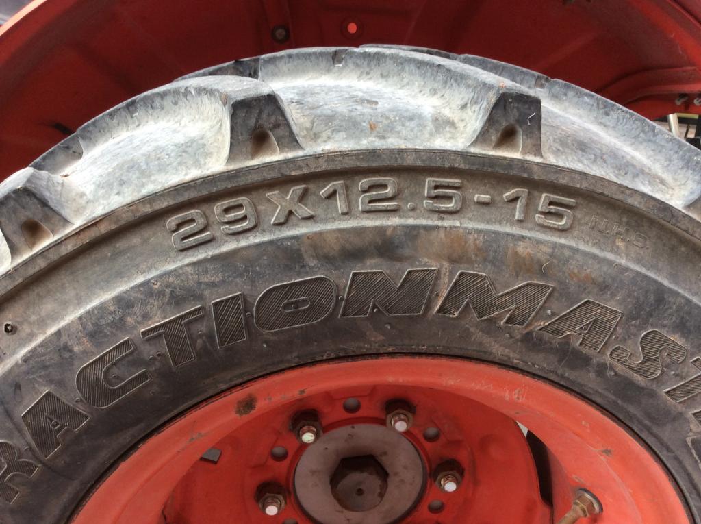

I have b7100d needs new tires on the front, i bought 20.5x8x10 turf (turf on back also) but they look to be bigger than what's on the tractor. am i going to mess up the 4wd? thanks.
Hi zigoapex,
what sizes do you have now front and back?
zigoapex
b7100d
Oct 10, 2022
Scott twp
Hi zigoapex,
29x1215 on the back and they are 20.5x8x10 on the front. I bought 20.5x8x10 but the rim centers are 4 inch and wont fit. They are going to return them. I’m going to use my old rims so i going to just order the tires.
