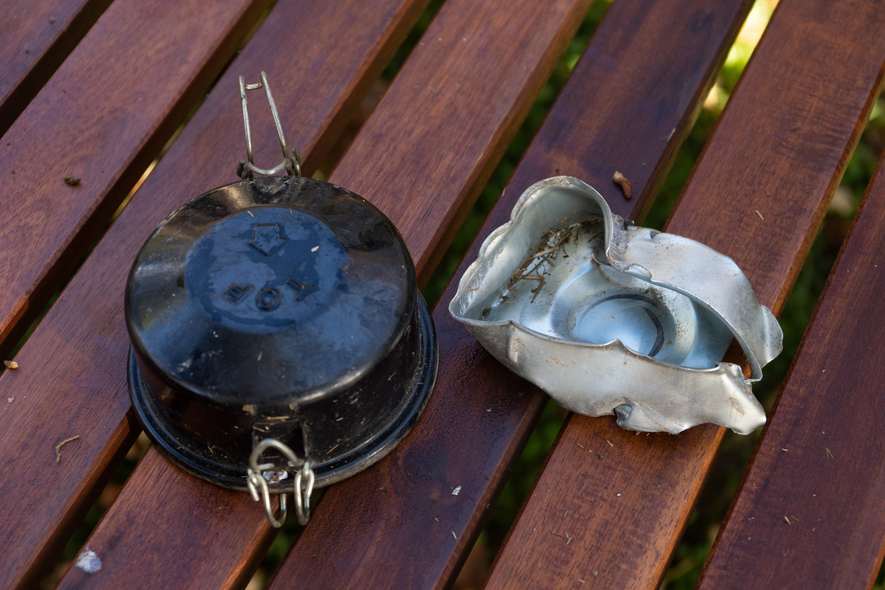

Mowing a field. When I got back to the house, I discovered the air filter cap had fallen off. The wing nut that holds the element in place was also gone, but surprisingly, the filter element was still there.

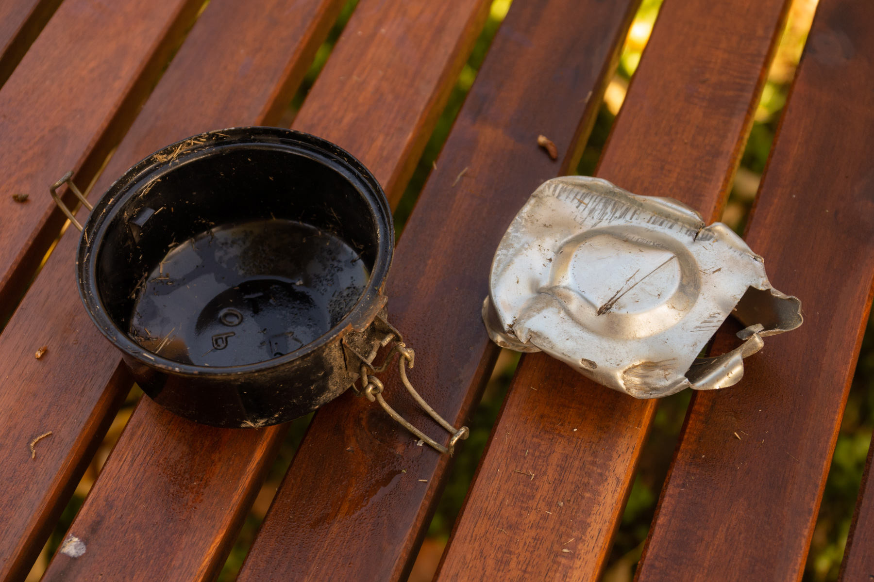

Out in the field, I found the black cap in good condition. I was looking for the wing nut, but gave up as I can jerry rig that. I did not think anything else was missing. But on the way back, about 30 feet from where I found the cap, I found the remnants of a clean but damaged silver metal "can" for lack of a better word. It had obviously been through the mower and could easily have been thrown that far. I am not sure if it is part of the air filter assembly, but its size and some of the remaining radii on it makes me think that it is. Perhaps a baffle?? I can't find pictures or references to such a part. I have found caps for sale, but the mystery part is not shown.
It is possible that the mystery part has nothing to do with the air filter or the tractor, but it seems too much of a coincidence.
I have attached a couple photos. Does anyone know what the mystery silver part is and what it does? And where to buy a replacement?

Well, I'm going to partially answer my own question. It is indeed the baffle that fits inside the cap. The baffle's part number is KU-15221-11410.

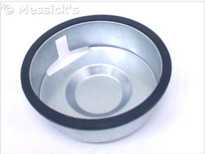

And by the way, here's what it is supposed to look like...

Got a local dealer? They have the same parts availablity as Messicks and no ship cost either.
That is the large dirt separator cup.
6,219
1,919
You may be able to fashion a similar part from heavy paper stock (paper board or poster board in USA but clueless in France)??

What purpose does that part serve? A cap inside the cap?
SidecarFlip
Banned
7,182
557
Post 10. The cup separates the heavier dirt particles from the dust and allows them to fall into the filter cannister instead of sticking to the filter. All Kubota's have them in various designs. My M's have them but are built into the outer cover with what is referred to as an 'evacuation valve' or a flexible rubber sleeve on the bottom of the outside removable cover you can squeeze to let the heavy stuff drop out.
One thing I do with my Donaldson air cleaners (Donaldson make them for Kubota) is, I wipe the inside the the housing with a greasy shop rag before I install a new filter. The grease helps trap the dirt (in the grease) and allows the element to last longer.
