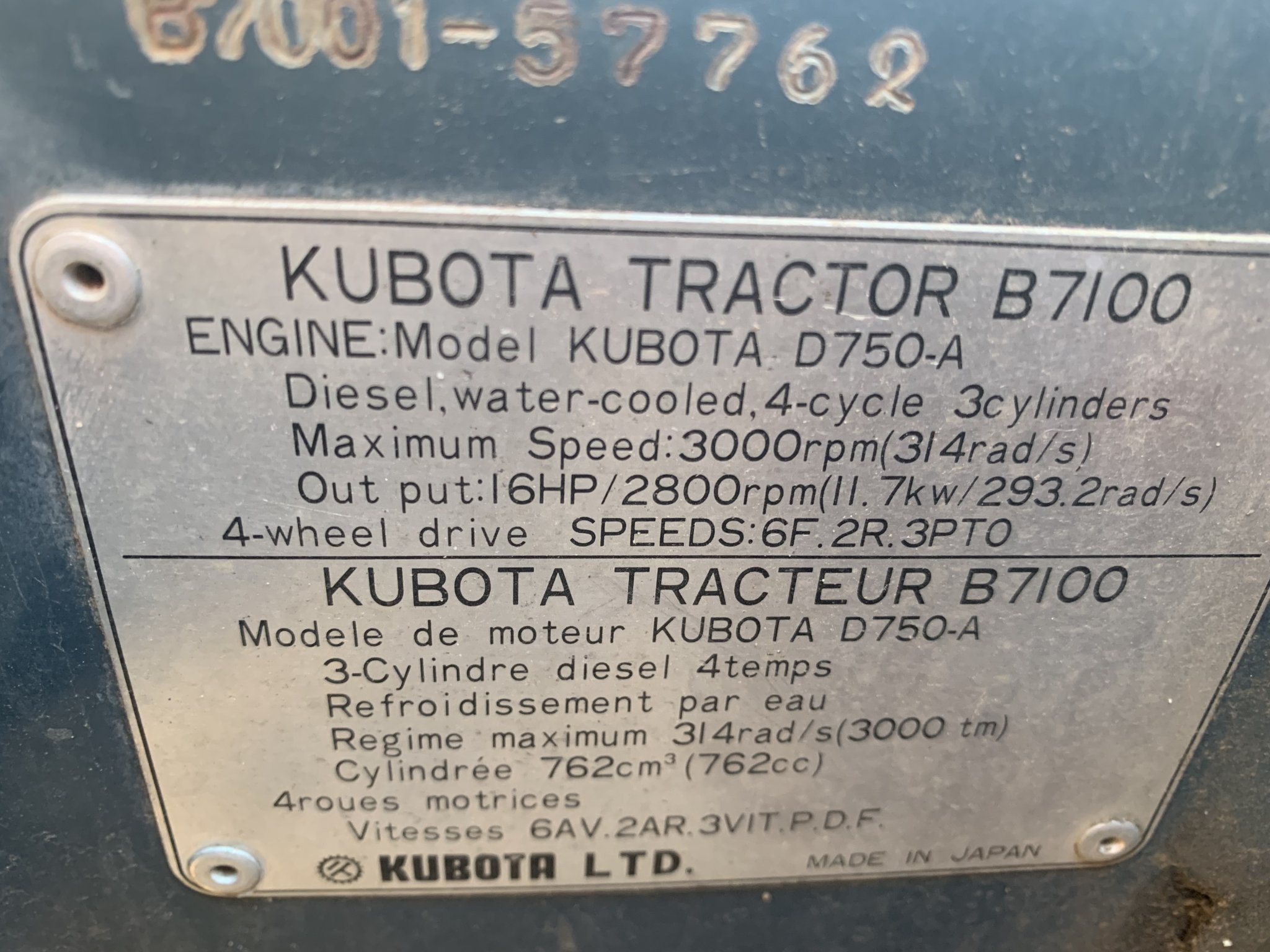

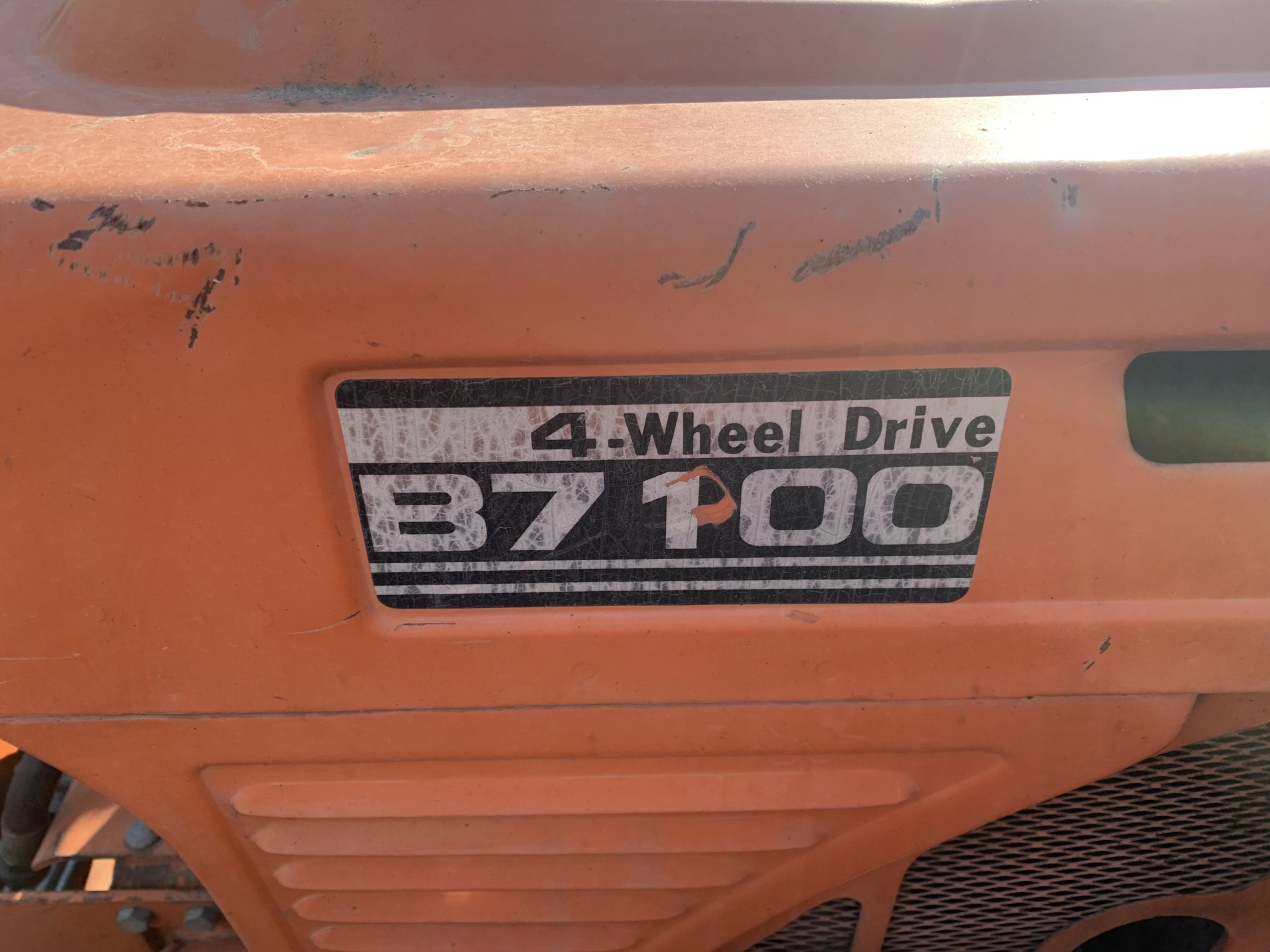

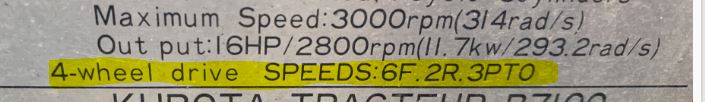

Have an older B7100, would like to front mount a snowblower. Not "seeing" a front or mid PTO. So not sure this is an option. Here is a pic of the model information, it is "4wd" with the MST I think it is called. Any suggestions appreciated. Currently have bucket on front, and tiller on back, but will remove tiller soon for the winter. Does this have a front or mid PTO?

A gear drive b7100 does not have a mid PTO. If by "MST" you reference above is actually HST then you have a hydrostatic transmission. (forward/ reverse controlled by a foot pedal) The HST version of the B7100 does have a mid PTO that can operate a front mount snow blower.

Look at the plate, it's a B7100DT not an HST
I also ran the serial number just to make sure.

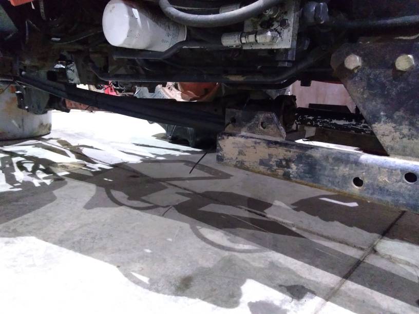

I tried to help a friend with an HST B7100 with a mid pto fit a front mounted blower.
Forum member Torch provided me with part numbers for the various mount parts.
I ordered the parts from Messicks.
When I picked them up I found out Kubota had re-used the old part numbers and all I got was some filters.
There are companies which make kits that use the rear pto to drive a front mounted blower.
Erskine is one of them.
Erskine

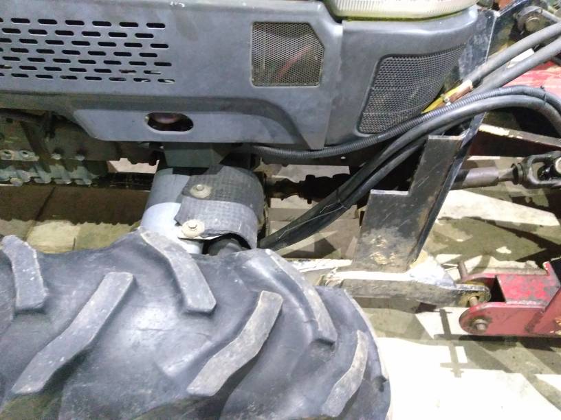

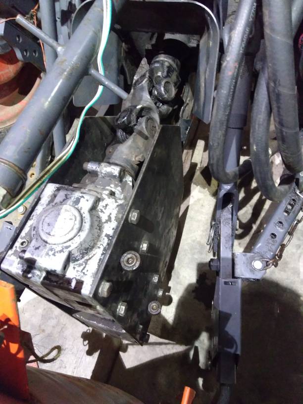

I have a couple of detail pictures which I will provide of a do-it-yourself job.
Getting the pto drive lowered and turning in the right direction is the challenge.
On the one in my photos, two extra rear gear boxes are stacked.
Every once in a while I will see used ones for sale. The manufactured ones have long arms which transfer the pushing forces to the re 3 pt mount areas.
